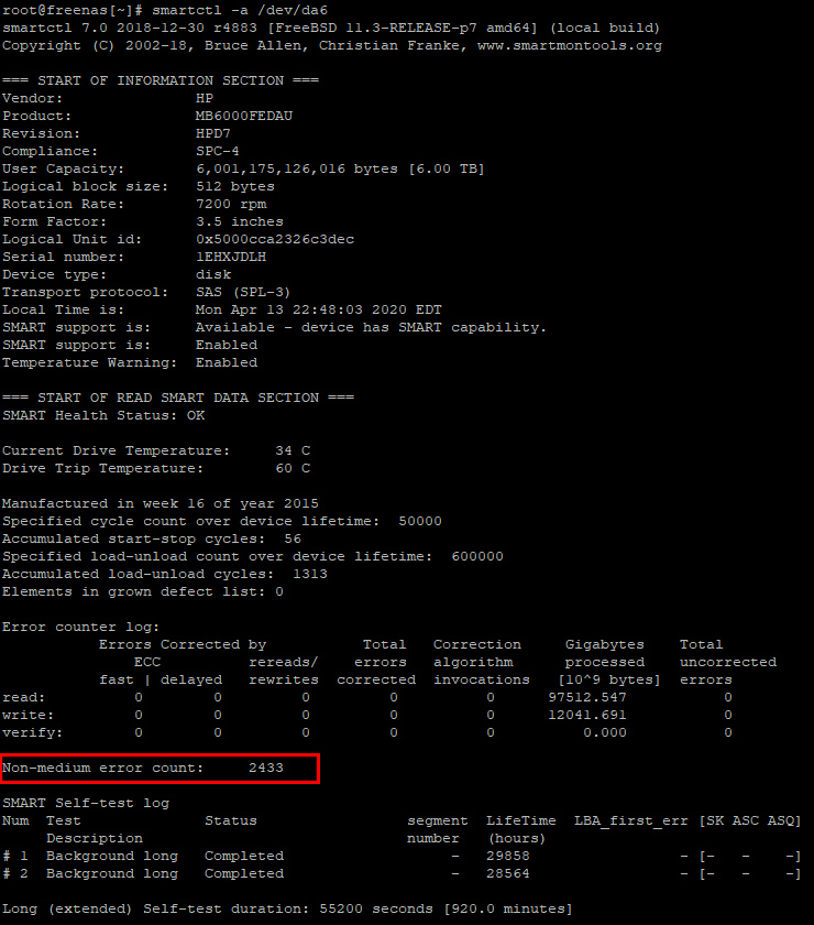

UPDATE: This happens every time I run smartctl, like:
smartctl -a /dev/da6
It affects 11.3 only, no issues on 11.2 or older.

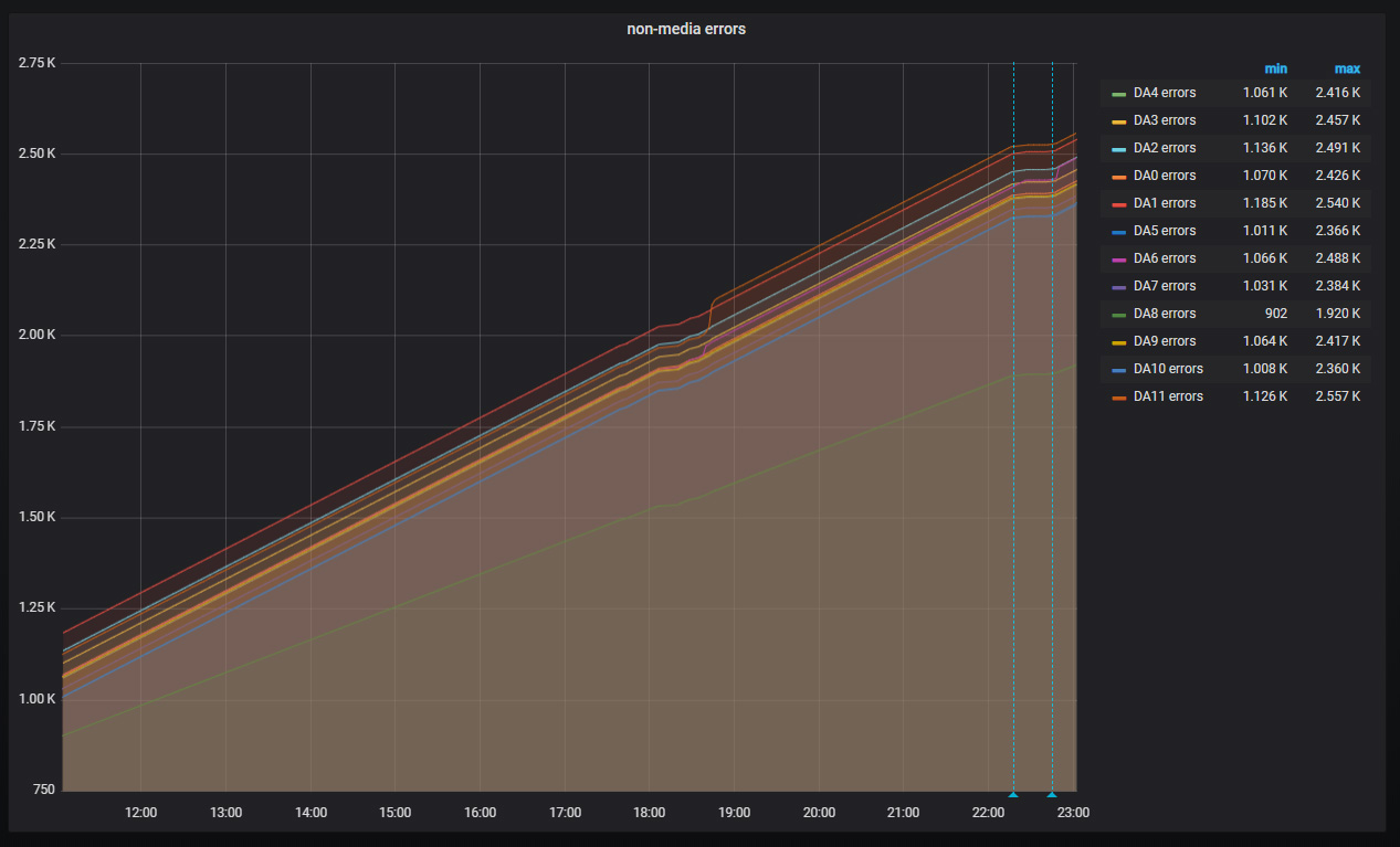

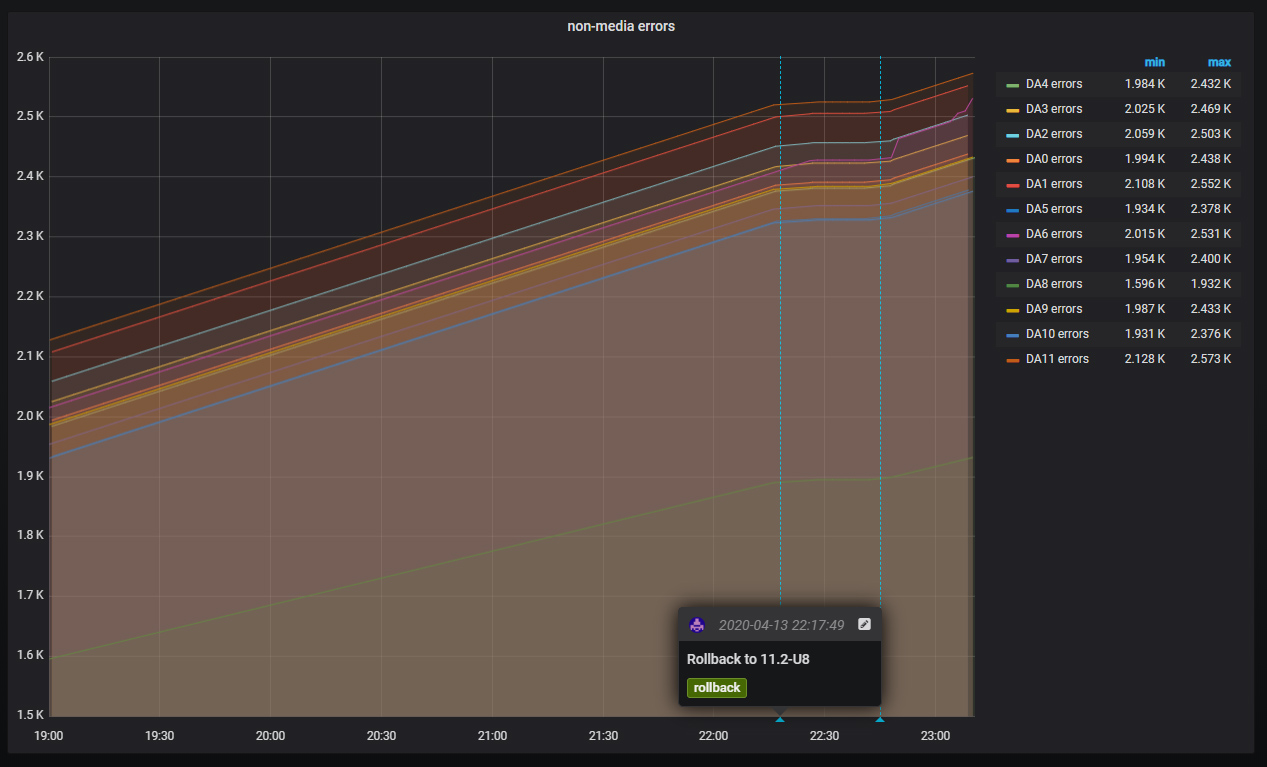

After a recent upgrade from 11.2-U8 to 11.3-U2 we have noticed a rapid and constant growth of "non-media errors" in all 12 connected disks simultaneously. I tried to replicate the issue on the test server and with the same hardware but fresh installation (no pools) new disks showed the same behavior.
No such problems with 11.2-U8. After rolling back from 11.3-U2 to 11.2-U8 errors stopped growing. Of course, now we can't change the counter on our new disks back to normal values...

Please check the attached screenshots for non-media disk errors and other details. Before the upgrade, all disks had <500 errors.
Any idea what could cause this issue?

Ericloewe, I got the latest firmware on the card. Unfortunately, I didn't check backplane's firmware and I don't have access to SC backplane firmwares.
tfran1990, almost all caused by weird smartcl requests.
