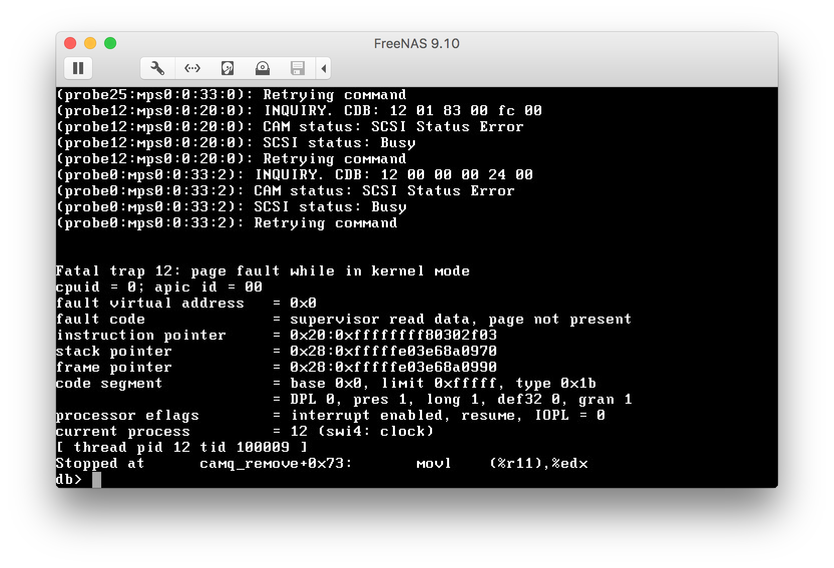

Hey folks,
Sorry for taking a while to reply. Busy.

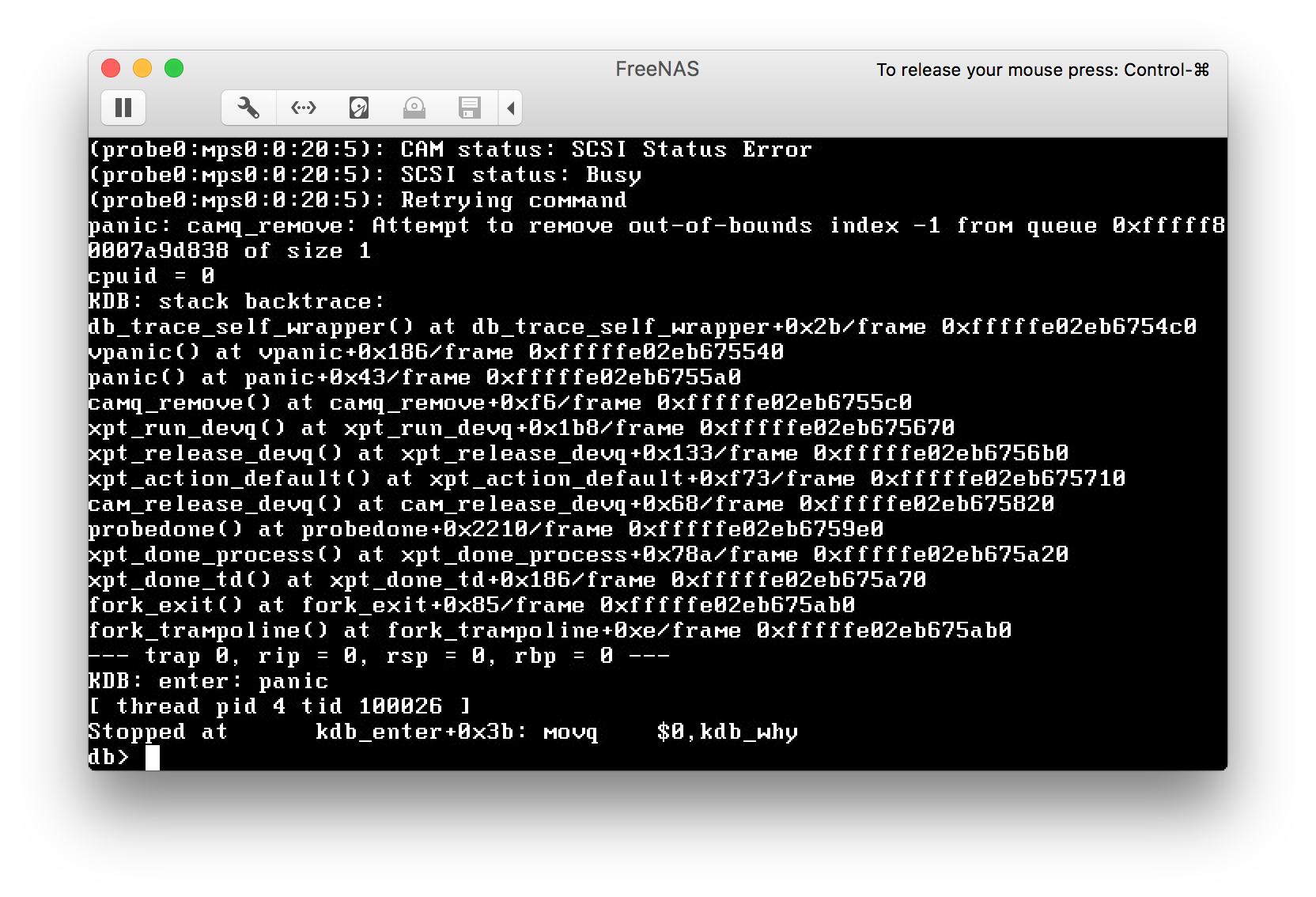

Anyway. I did test out powering up the disk array while the FreeNAS VM was running. I'm not sure how to capture the text, though -- it scrolled by on the VMRC app so quickly. It appeared to be a whole bunch of tracebacks, followed by a reboot. Then it went through the same boot up procedure I described earlier -- it got to the point where it started doing some SCSI probes, and after three probe attempts, I got a Fatal trap 12.
I'll try to upload the screenshot of the trap here. (Upload File? Haven't used this interface before. Did i get that right?)
So -- any suggestions on how I can capture the console output as text?
Thanks for any guidance. Sorry for being such a n00b here. (Despite the fact that I started using FreeBSD in the early/mid 90s...)
Regards
Michael
It's ok, but you can just drag and drop or copy-paste images into the forum and XenForo will deal with them appropriately.
Connect via SSH and set the buffer to something long enough. It might be best to then paste it into a file and upload the file.
That said, it probably won't have anything particularly interesting. This is still without the updated firmware, right?

Mar  1 21:57:00 freenas da12 at mps0 bus 0 scbus3 target 13 lun 0
Mar  1 21:57:00 freenas da12: <IBM-ESXS ST31000424SS BC2D> Fixed Direct Access SPC-3 SCSI device
Mar  1 21:57:00 freenas da12: Serial Number 9WK2KXFK0000C1188660
Mar  1 21:57:00 freenas da12: 300.000MB/s transfers
Mar  1 21:57:00 freenas da12: Command Queueing enabled
Mar  1 21:57:00 freenas da12: 953869MB (1953525168 512 byte sectors)
Mar  1 21:57:01 freenas (probe12:mps0:0:20:0): INQUIRY. CDB: 12 01 83 00 fc 00
Mar  1 21:57:01 freenas (probe12:mps0:0:20:0): CAM status: SCSI Status Error
Mar  1 21:57:01 freenas (probe12:mps0:0:20:0): SCSI status: Busy
Mar  1 21:57:01 freenas (probe12:mps0:0:20:0): Retrying command

It looks like there have been some changes to SCSI timeout handling in newer revs of FreeBSD, so I'm going to load up the latest FreeNAS and FreeBSD images and see what it looks like with those running.
As I mentioned earlier, I know that OmniOS handles this enclosure successfully, so I'm fairly convinced this is a software issue in the FreeBSD kernel.
I think the driver tries to talk to the enclosure, sends a bunch of INQUIRY messages, but gets no response or maybe gets some kind of SCSI nak (I'm not a SCSI protocol expert). Then we see a whole bunch of tracebacks, ultimately followed by the page fault trap 12. I think it's trying to clean up state information from the failed INQUIRYs but something's getting corrupted -- maybe a pointer corruption, or maybe it's a failure to free structures correctly.
Unfortunately, I just don't have the time to troll through the mps driver code myself to try to find this.

Results using FreeNAS 10 BETA 2, updated to NIGHTLY build...
Same result. I can get the enclosure to be recognized if I pull all drives and only attach it after the system has booted. Then I can engage all drives and create vdevs. Multipath is working nicely in FreeNAS 10 -- it picked up all drives correctly. Still had to use the dd trick to identify which slot was which. Curiously, the IBM EXP3000 identifies its slots as 1..4 on top row, 5..8 on middle row and 9..12 on bottom row. Multipath allocated the numbers in columns -- disk 0..2 in first column (leftmost column, drive 0 at top and 2 at bottom), then 3..5, 6..8 and 9..11.
If I reboot the system after setting everything up, I get the probes followed by the crash. FreeNAS 10 seems to give more useful information on the console -- here's what I see for the trap..
It's more obvious here that it's a data structure integrity issue.
I guess I have enough information for a bug report now. I will have to start writing one up. And maybe give FreeBSD 12.0-current a go just in case.
Thanks for your help Eric -- any other suggestions?
