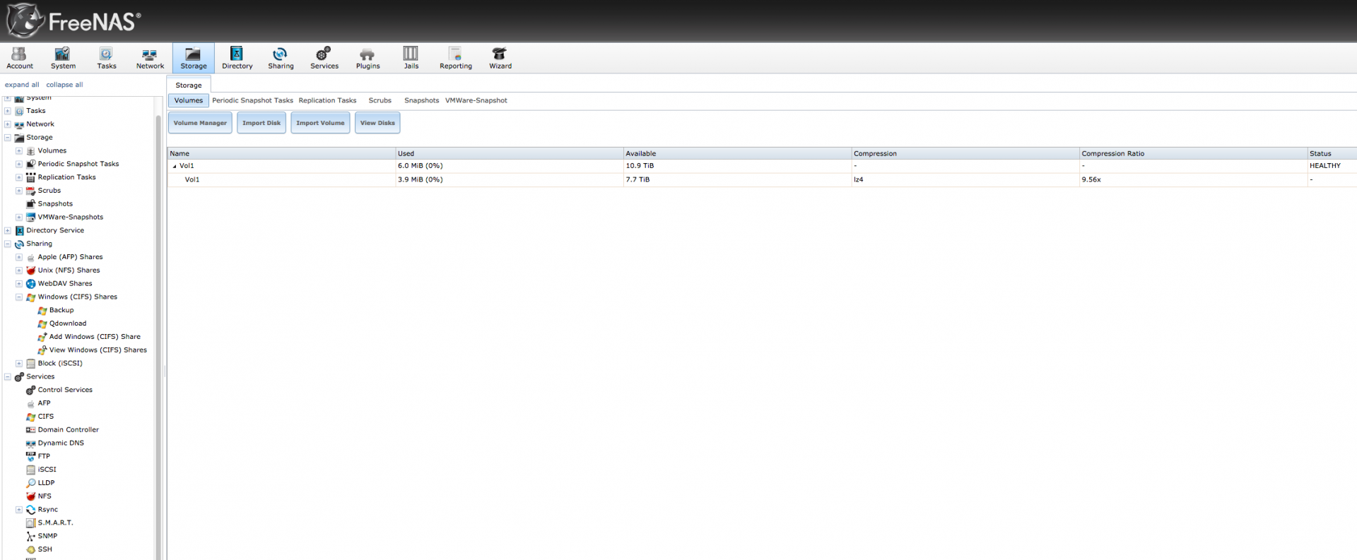

I have attached a screenshot from the GUI manager.

cyberjock
Inactive Account
Mar 25, 2012
19,525
Can you post the debug file for your server? If they are truly identical in all ways related to hardware if you could post the debug for your "other" box that might be helpful too.
