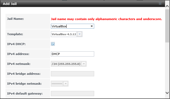

Just want to bump this for #3. I've already read this and this. Currently getting this message on a fresh install: jail name may contain only alphanumeric characters or underscore
Not sure where to go from here.
