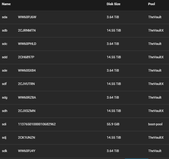

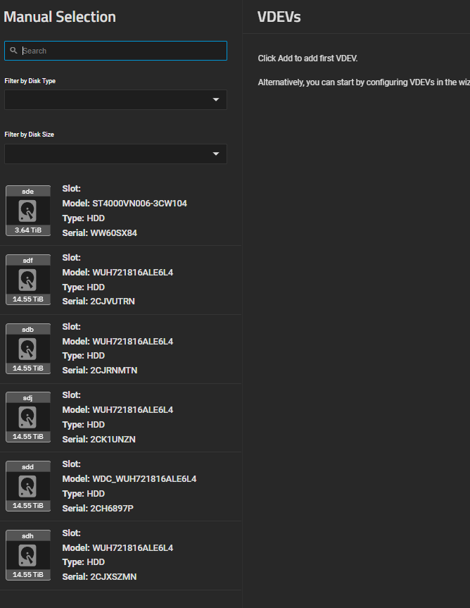

I have two pools and 6 unassigned disks just randomly showed up. 5 from one pool and 1 from another.
I IllSkillz Dabbler Joined Feb 21, 2023 Messages 22 Nov 5, 2023 #1 I have two pools and 6 unassigned disks just randomly showed up. 5 from one pool and 1 from another. Attachments 1699236943413.png 63.1 KB · Views: 556 1699236975868.png 29 KB · Views: 511
I IllSkillz Dabbler Joined Feb 21, 2023 Messages 22 Nov 5, 2023 #2 I wonder what would happen if I add those disks in to existing pool? More free space? )
Arwen MVP Joined May 17, 2014 Messages 3,611 Nov 5, 2023 #3 It would appear their is a bug in the GUI. Adding the disks will likely corrupt an existing pool, as well as the pool added to.

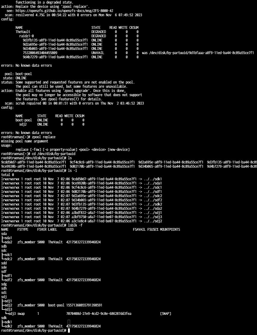

I IllSkillz Dabbler Joined Feb 21, 2023 Messages 22 Nov 6, 2023 #5 After system restart, pools lost the devices. is there a way to reattach them back?
I IllSkillz Dabbler Joined Feb 21, 2023 Messages 22 Nov 6, 2023 #6 it seems that disks lost there uuid is it possible that that happened because I did fio on disk whyle it was in the pool ? Attachments 1699314274033.png 152.3 KB · Views: 550 Last edited: Nov 6, 2023
I IllSkillz Dabbler Joined Feb 21, 2023 Messages 22 Nov 7, 2023 #7 I tested it and i can confirm that running fio on a disk that is attached to the pool will make that disk dropout from the pool
