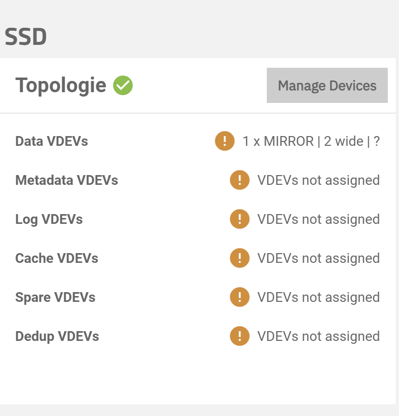

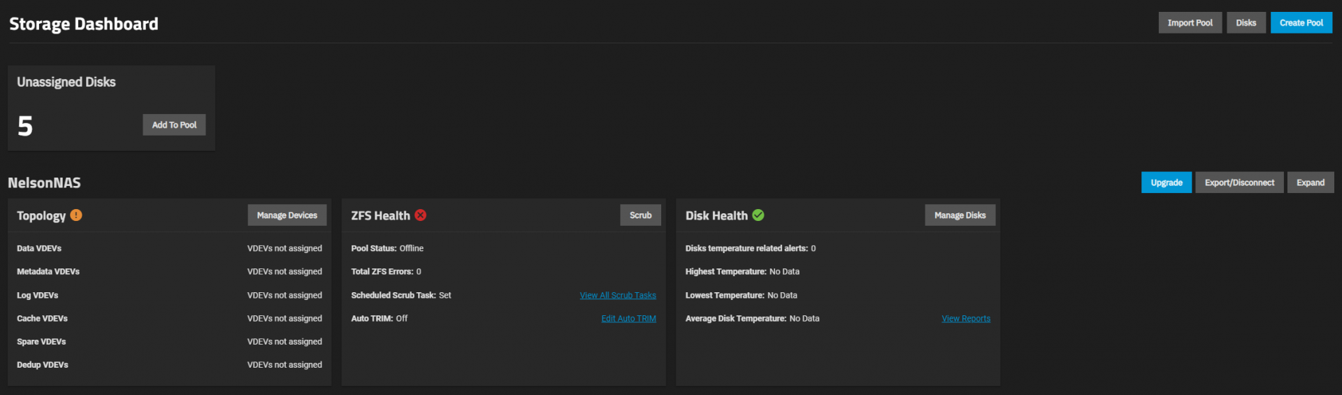

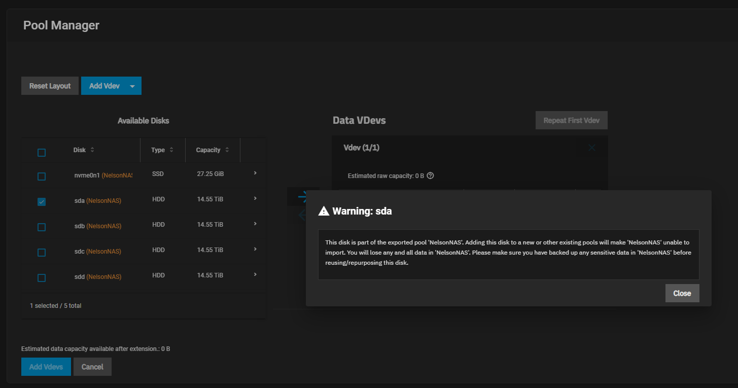

So my VDEVS are all randomly unassigned from my discs, and when I try to add them back, it sounds like it will wipe all of the data on them unless I am mistaken?
I did not change anything that I am aware of that would have caused this. I went to access my files the other day, and it suddenly said I had 5 unassigned disks.
When I try to reassign them, I get a warning that I might lose my data, though I'm wondering if I actually will or not since I'm just adding them back to the same pool they should already have been on in the first place.
Please let me know what I can do or if anyone can point me in the right direction!

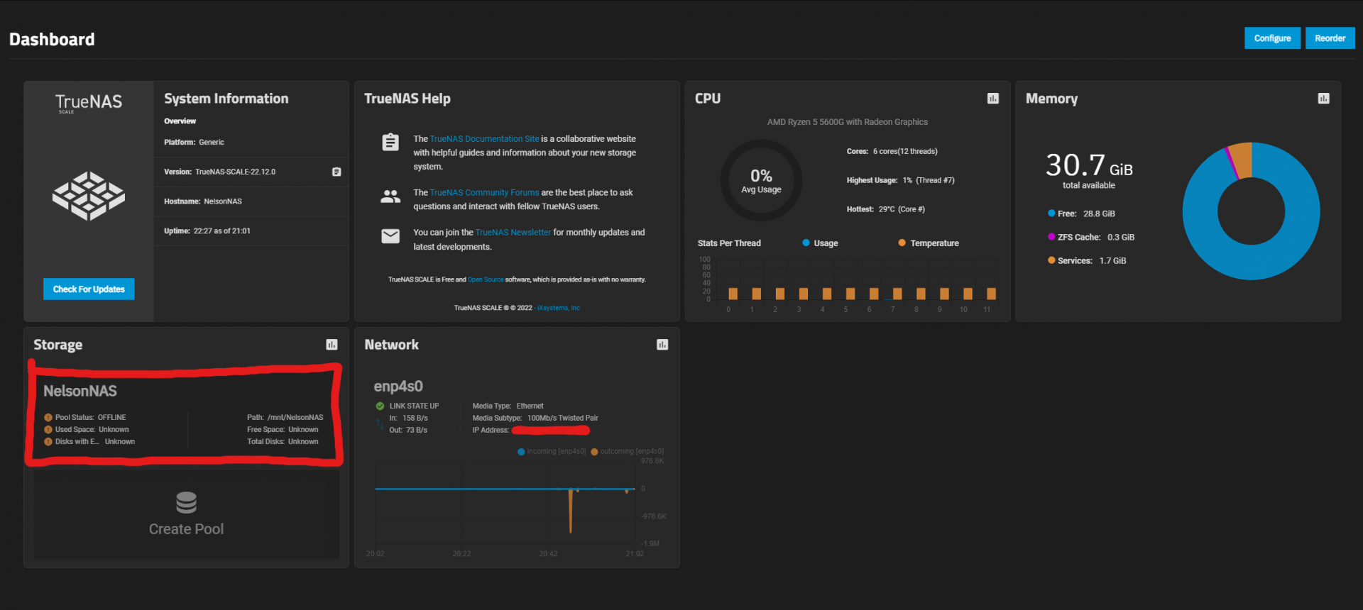

Getting this critical error:
"Pool NelsonNAS state is OFFLINE: None"
Here are some screenshots of what I am seeing:

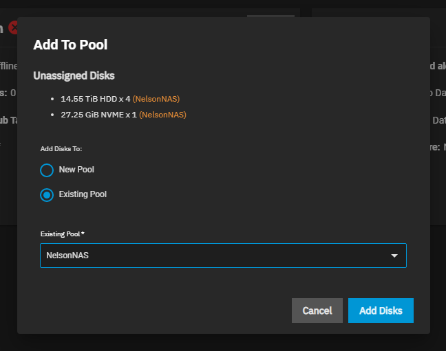

No, don't try to add them back. Try to export the pool with the boxes for "Destroy data" and "Delete configuration" unchecked and the box for "Confirm export" checked. Then try to import the pool back.

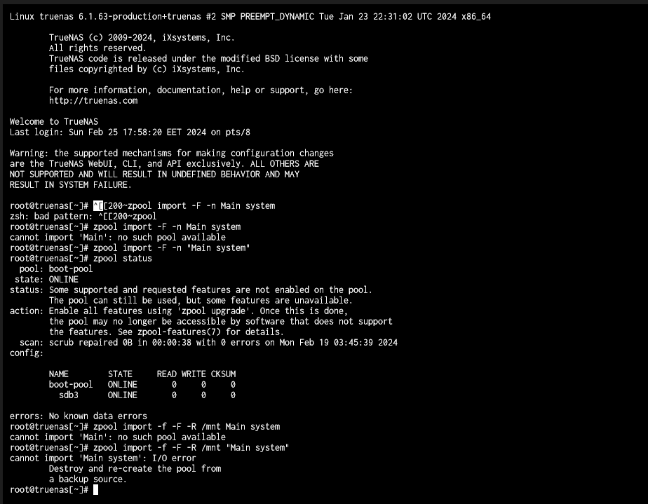

I've done that, now when I try and import the pool back, I get this error message:

We'll have to try CLI at this point, as the UI isn't working. Try zpool import -f -F -R /mnt NelsonNAS.

Ah, yes! That got it working. Thank you so much.

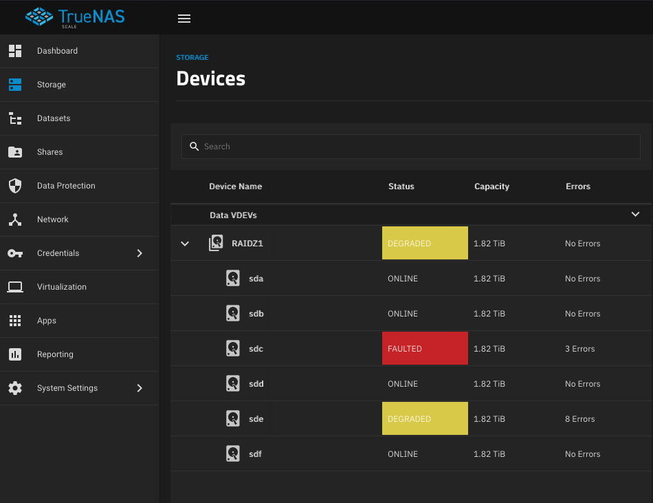

Hi, Sorry to bump this thread again, first time using Truenas Scale after upgarding from Truenas Core, I ran into the same problem one of my disk suddenly become unassigned, and tried the export and re-import the pool without error but the disk remain unassigned, is my drive ruined, all the files are backed ups so I could always recreate the pool but I want to know how to solve this problem if ever occurs again in the future.
I'm using non NAS self build from scratch:
Mobo: GA B85M DS3H A
RAM: 16Gb
Drive: 6 x WD Blue 2Tb, configured into 1 pool, RaidZ1
I'm using this mainly for managing large files for my works (mostly design and photography) before all the files went into backup, and, to learn about NAS and IT in general along the way.
I still not fully understand to read the smart test but it seems the drive are prefailing, but I still believe it's working at least at the moment, here's the test result:

And at the notofication alerts show:
Critical​
Pool MOMO state is DEGRADED: One or more devices could not be used because the label is missing or invalid. Sufficient replicas exist for the pool to continue functioning in a degraded state.
The following devices are not healthy:
  • Disk WDC_WD20EZBX-00AYRA0 WD-WXB2A618U3D1 is UNAVAIL
  • Disk WDC_WD20EZBX-00AYRA0 WD-WXB2A613A29Y is DEGRADED
Let me know what you think
Thanks in advance
bajang14
Aug 13, 2022
Update on my situation:
So I tried again to export/disconnect my pool, however, this time I disconnect all of my hdd and turn on my NAS without all the HDD connected, then, I turn it off and reconnect all of the drive, import the pool then all the drive was recognized as it was, but this time with storage status degraded and the drive which previously reported unassigned currently FAULTED and another drive reported DEGRADED. I guess it really is faulted and need replaced
Here's the screenshot:
Thanks in advance
xVertigo
Nov 19, 2023

Hi @Samuel Tai , I have the same problem here and try to use this solution that is working for others. I'm running in to a problem when using this command. I get the error saying: Namespace zpool not found in the CLI.
I'm trying this from the shell page from the webUI. When I open it I typed CLI to get there. Also tried to do sudo CLI, but get the same response. also zpool import gives me the same. I think i'm doing something wrong but can't find out what. Can you help me?
Patrick M. Hausen
Nov 25, 2013
7,776
zpool is a shell command, not a TrueNAS CLI command. So from the shell directly invoke zpool ..., don't type cli first.
Also better than using the web UI shell use SSH and a terminal application.
Seyude
Jan 17, 2024
3
Thanks, but when I do that, I get the reply: zsh: command not found: zpool. Has i something to do with my admin account not being a default root user? I am reading that in some posts here, but can't find a work around
I'm clearly no expert in Linux...

ilias991
Feb 18, 2024
8
Patrick M. Hausen
Nov 25, 2013
7,776
@ilias991 and your question is?
Please open a new thread instead of posting random images in a thread that is probably not even related to your problem.
Second, please post command output by copying and pasting text instead of images. Enclose text in CODE tags.
Third post all details regarding your hardware, system, controller if resent, disk drives or SSDs, how they are connected, ...
You have an I/O error ... so something is definitely broken. Disk drive, cable, controller, ... but without all the details nobody will be able to even have a guess.
