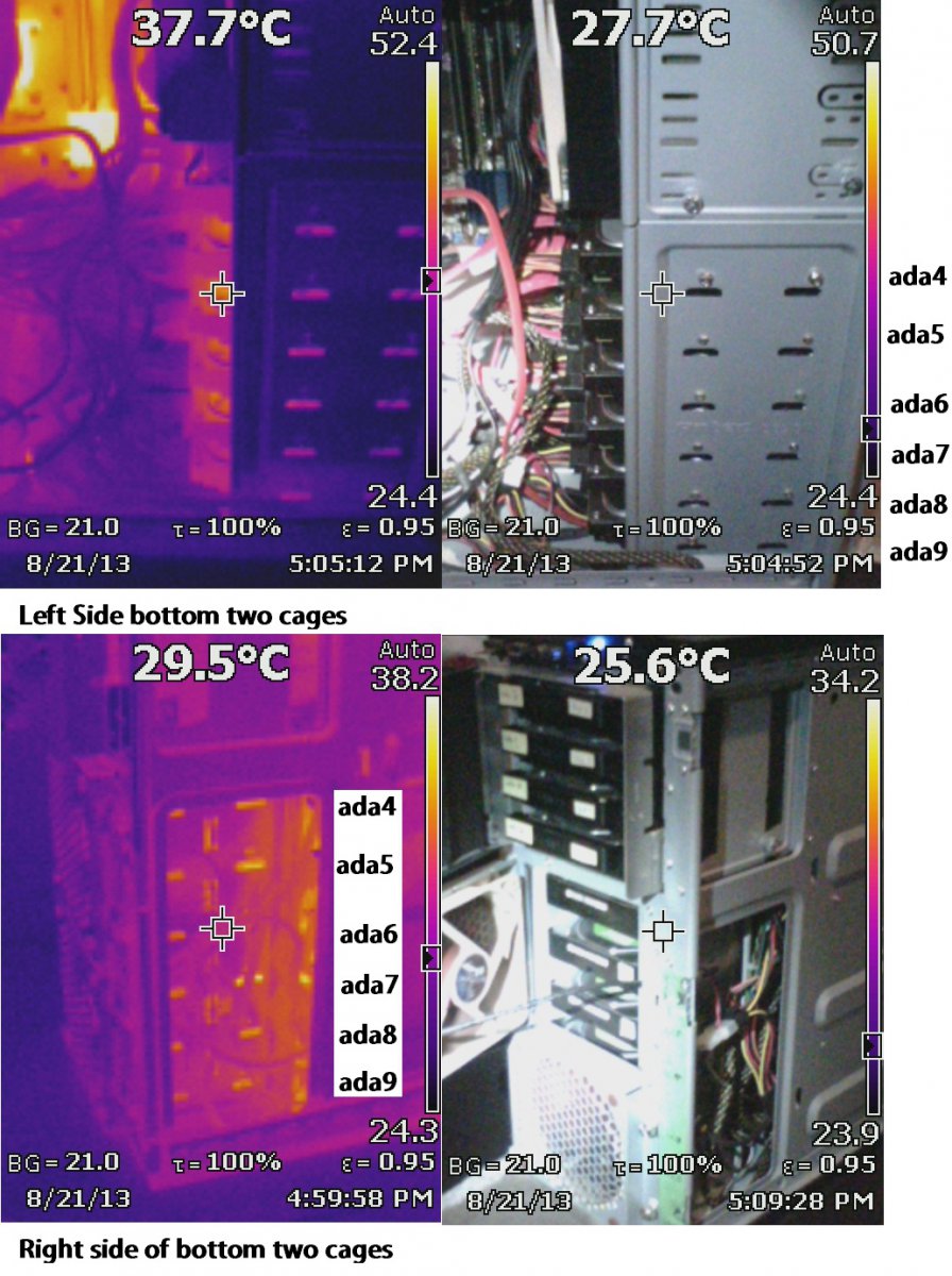

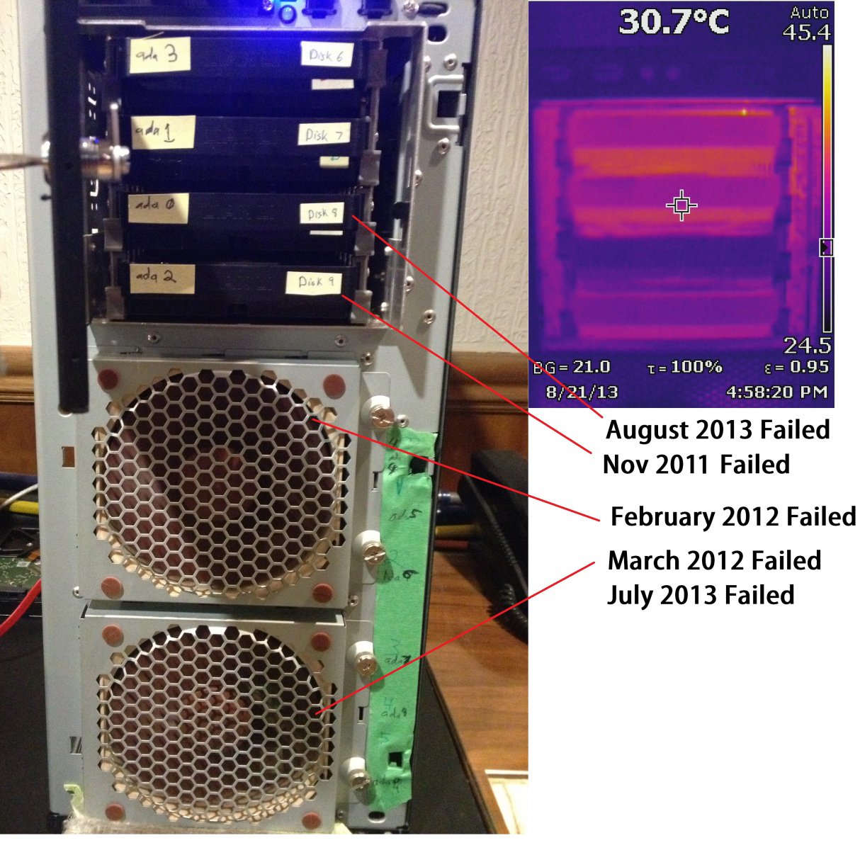

I took some pictures of the setup showing which drives failed and when. Two drives failed with full support on both sides in the upper cage and 3 failed in the lower cage with only one side of the drives screwed in.
I was thinking about the effects of vibration. I wonder if it's worth while having an external drive cages weighted down with some sort of mass to reduce the vibrations. I am just curious if anyone had better success with WD RE drives? I am going to building a new server soon as this guy is done and I don't trust any of the remaining drives.

Oh! Oh! You have a thermal camera.. I want! I'd love to use one on my overclocked system just to see where the heat is concentrating(if it is).
If those top 4 drives don't have a fan behind them I wouldn't use that spot.
The bottom are probably okay(cooling-wise) as long as they aren't fans that are low CFM. Remember that your best indicator is being below 40C. If your hard drives are below 40C then all is probably ok.

I'm resilvering now and other then the main drive that I am replacing, two more drives are showing up errors. At this point I am going to fix the remainder and I feel like scrapping the rest of the drives and switching over to red 3tb drives. They are 1/2 the price of re and come with a 3 year warranty. Being 1/2 the price I can add in more drives for redundancy and increase the raidzx next build. I am going to keep the vdevs smaller in size and op for raidz2 next time around.

One thing I haven't commented on is your infrared imaging. I'll commend you for the effort you've put into checking your drives, but unfortunately I'm not sure how much value there is in that. The outside part where you measured the temperature will naturally be lower than the back of the drives. What you really should do is use smartctl to query the drives for their temperature. After all, that's what Google did for their white paper so it makes sense to use the same methodology for you.
