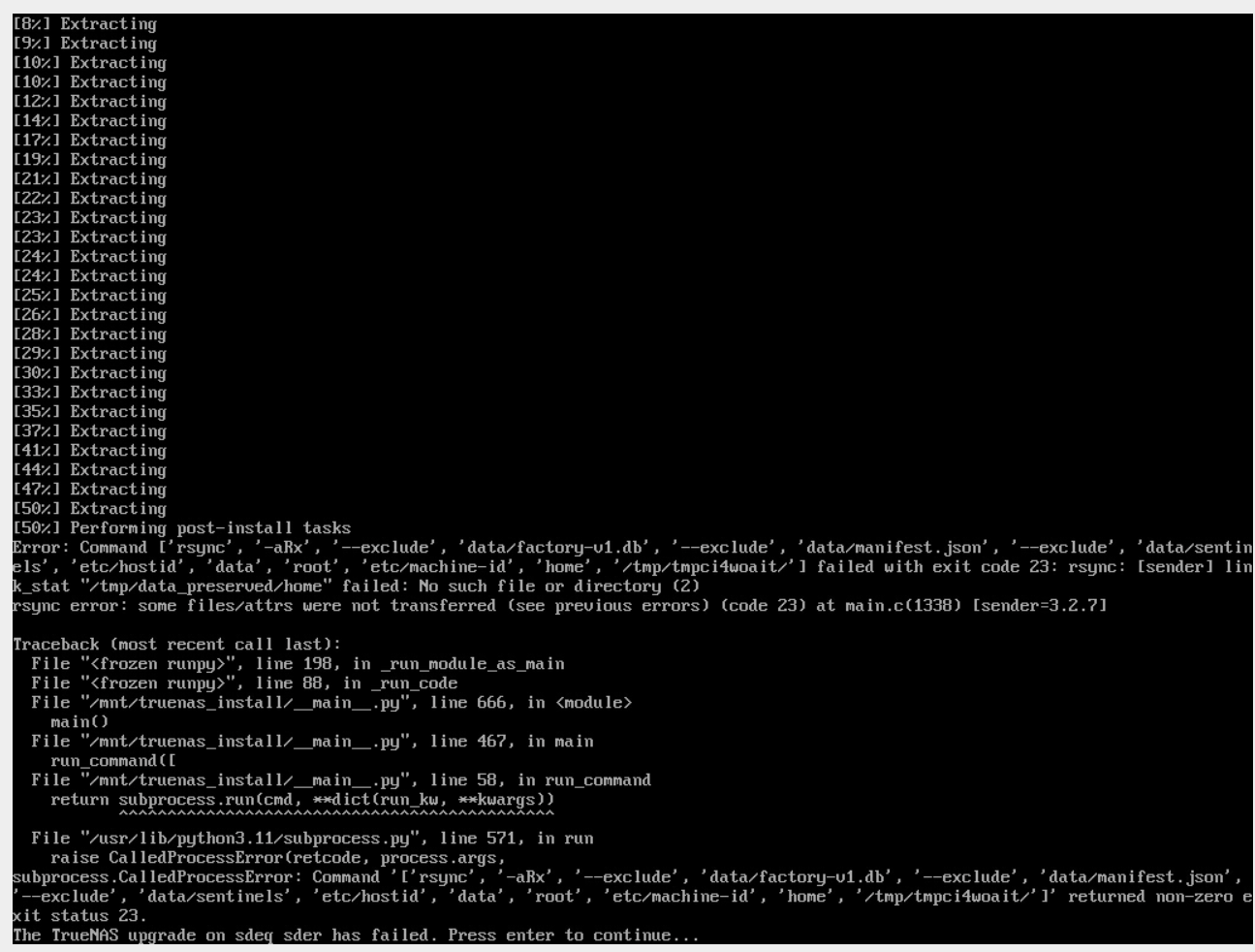

I tried reinstalling TrueNAS, and this came up:
Was it a bad USB image or a bug in the installer?

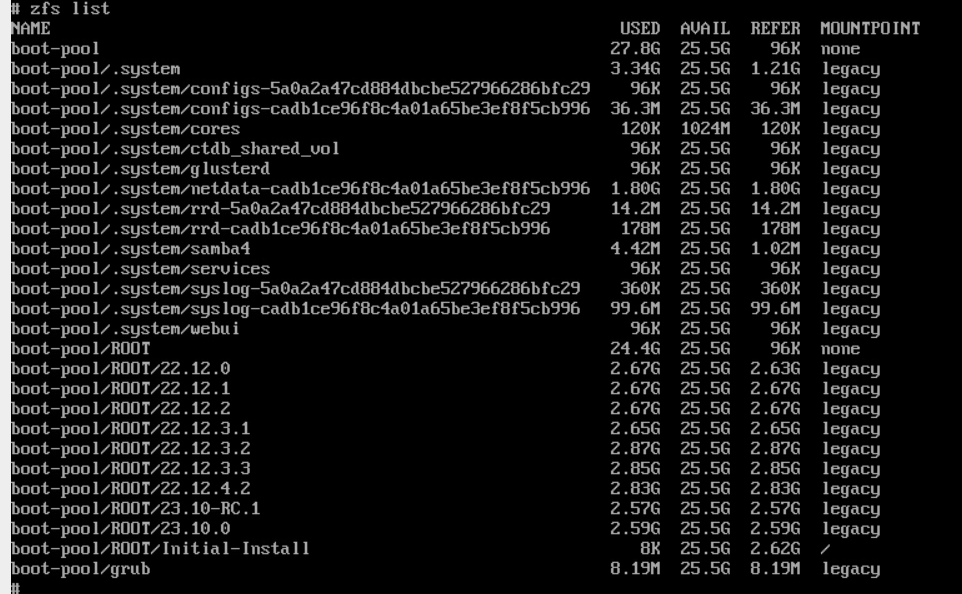

Here's a `zfs list`. Looks like these are from my boot drives:
Anyone have an idea what I can do? I was going to do the upgrade install + format route, but I don't wanna lose my config.

After doing the "keep everything and format" route in the installer and having it error there too, I lost all my configs on those drives.
I checked to make sure I had a recent-enough backup config (I did from the 23.10-RC upgrade). I used this to install TrueNAS from scratch. Then I imported my last backup, and it worked! Aside from logs, I don't think I lost anything important. Good thing I keep my apps on a separate zpool!

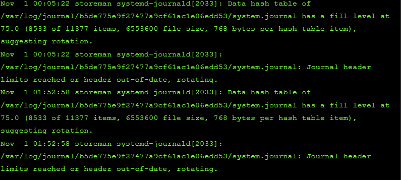

Still getting these system.journal warnings though. I'm assuming this is some sort of v23 bug:
I don't wanna hyjack my own thread though.
My current version is v23.10.0.1 now.
