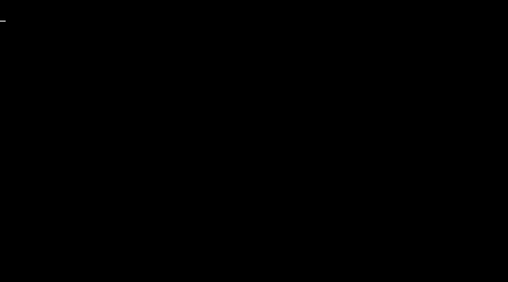

Failure 4, hang in a blank screen

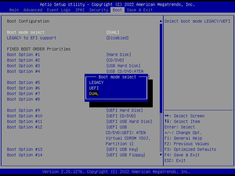

I have tried all the options in the BOOT mode of the BIOS (Both, UEFI and Legacy). The ISO was loaded in LEGACY and DUAL mode but not in UEFI mode. :(
It has no boot drive installed yet as I am still waiting for the SFF-8643 to NVMe adaptors.

Make sure you have the correct boot mode setup in the boot order. There are both the legacy and UEFI modes available.
I ran into the same issue with a Supermicro H12SSL-NT board. Even today, I only recently got UEFI boot working with TrueNAS after the latest install. I'm also in Dual-boot mode, but I made sure to configure UEFI as the default boot too!
If you're having issues, I'd recommend trying to put the Legacy boot mode first.
Janus Ng
Apr 10, 2016
63
Thanks for your advice. I switched to a USB drive and it works in both legacy and UEFI modes. The virtual media of IPMI is somehow incompatible with TrueNAS 23.10.
