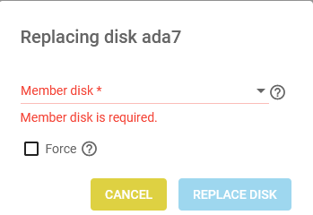

I've search a bit for a good way to replace a still working (albeit old) disk. Here I'd like to document my solution for discussion, and raise two issues.
Issue 1: the manual doesn't describe how to replace a working disk without degrading the pool.
Issue 2: the UI replace disk option seems not to work.

1. Ideally since the pool is still fully operational replacing a disk should work without degrading the pool. Lacking other official information I followed the manual at https://www.truenas.com/docs/core/coretutorials/storage/disks/diskreplace/#figure-2 . Using the UI I added the disk as a spare, and then tried to
a) OFFLINE, and
b) REPLACE it with the spare drive.
The REPLACE step didn't work because I couldn't select non-member disks from the replace UI window. This is the case for the newly installed disk - either added as a spare to the pool or standalone. Is this still the known error from when 13.0 was released?
After taking the legacy disk back ONLINE I proceeded as follows:

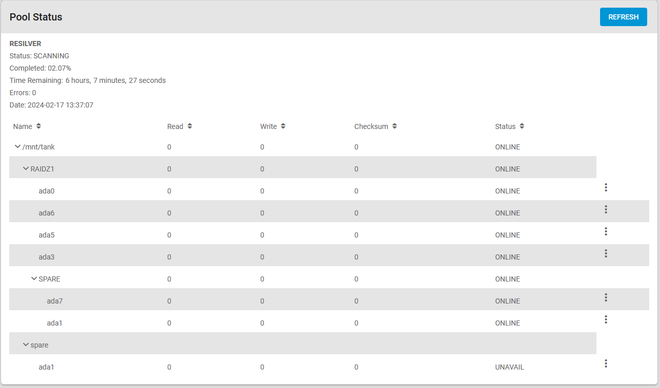

2. ZFS instructions describe it like this: Activating and Deactivating Hot Spares in Your Storage Pool
This looks much better as it resilvers the spare disk while keeping all RAIDZ1 disks online and reducing the risk of disk failure due to high load.
As a last step I will have to remove the legacy drive and make the spare drive integrate with the pool (to be updated).
The subsequent display in the UI is misleading IMHO. It may be true the "ada1 is UNAVAIL as a spare" as it is being resilvered but that fact is not visible int he UI. The output of '''zfs status''' is easier to understand.
a) OFFLINE, and
root@nas1:~ # zpool replace tank gptid/fe269fa1-2548-11ec-b7d6-d05099921104 gptid/233b7e12-cd91-11ee-95ed-18c04d8f0452
root@nas1:~ # zpool status -v tank
pool: tank
state: ONLINE
status: One or more devices is currently being resilvered. The pool will
continue to function, possibly in a degraded state.
action: Wait for the resilver to complete.
scan: resilver in progress since Sat Feb 17 13:37:07 2024
1.90T scanned at 21.8G/s, 32.1G issued at 369M/s, 8.71T total
6.30G resilvered, 0.36% done, 06:50:35 to go
config:
NAME STATE READ WRITE CKSUM
tank ONLINE 0 0 0
raidz1-0 ONLINE 0 0 0
gptid/cfbe1afc-9caf-11ec-81a1-18c04d8f0452 ONLINE 0 0 0
gptid/fdff7e8b-2548-11ec-b7d6-d05099921104 ONLINE 0 0 0
gptid/fe2055b4-2548-11ec-b7d6-d05099921104 ONLINE 0 0 0
gptid/fe15fec1-2548-11ec-b7d6-d05099921104 ONLINE 0 0 0
spare-4 ONLINE 0 0 0
gptid/fe269fa1-2548-11ec-b7d6-d05099921104 ONLINE 0 0 0
gptid/233b7e12-cd91-11ee-95ed-18c04d8f0452 ONLINE 0 0 0 (resilvering)
spares
gptid/233b7e12-cd91-11ee-95ed-18c04d8f0452 INUSE currently in use
errors: No known data errorsAs a last step I will have to remove the legacy drive and make the spare drive integrate with the pool (to be updated).
