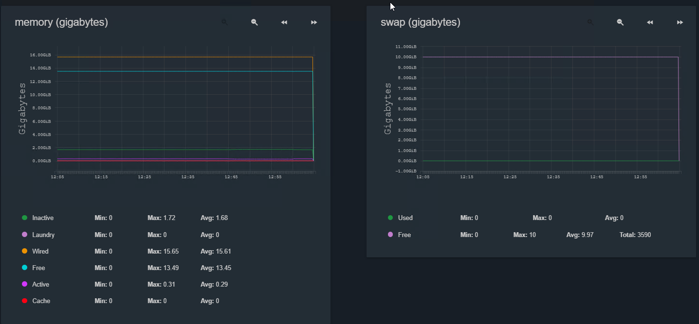

So possible recommendation is keep system as is. Add some SSD storage. Possibly more memory as well. My current ram usage is attached.
I have read some stuff on the sync writes slowing some things down. If I did a small SSD for slog would that make any difference on that? Definitely seems like doing the I2ARC may not be necessary at this time. Since it seems I have some free memory, should I maybe tweak the arc size?

Interesting that shows 13GB free which to me is a lot. Usually ARC fills pretty fast, unless you recently restarted the system. For instance, I have 64GB and show only 1.9 free right now.

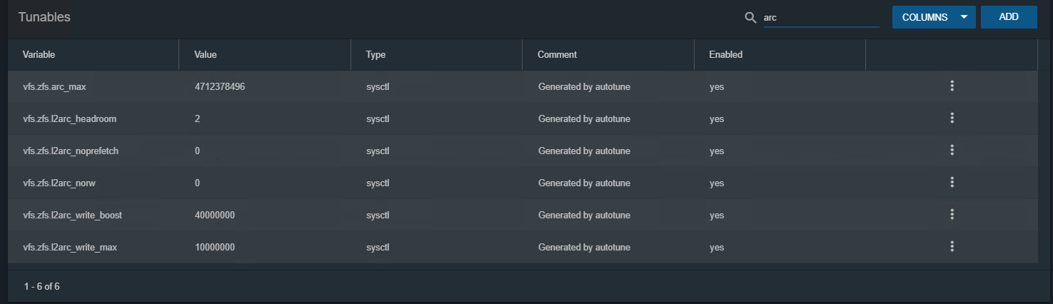

well, looks like i have some lingering auto tune settings from who knows when. Would you recommend just dropping these values and let them be default, or maybe re-run autotune.

I have never used autotune, but my impression of it is that it's more for troubleshooting than something that will "tune for best performance." I would remove all autotune settings and reboot, unless you know specifically why you need it.
Without looking them up individually, it looks like the first one is to manage arc size, which ZFS should do automatically. I wouldn't mess with that unless you know exactly what you are doing. The rest are L2ARC, which if I'm not mistaken you don't even have. If you do, I've tweaked no prefetch and write_boox/write_max to noticeable effect.
