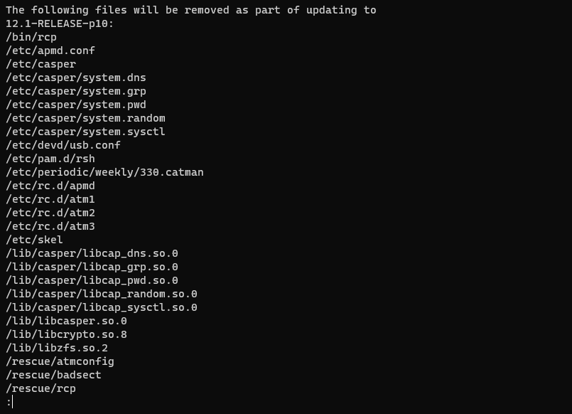

Hello everyone,
I have two pools, my second pool is all plugins that you get in freenas, my first pool has one jail that is nextcloud, it wasn't installed with the plugin. I used dan35's code and it has been working great.
Now I made the move to Truenas code and updated my second pool first and everything went well.
I used the command line and did iocage fetch and the downloaded 12.1 and then ran the command
iocage upgrade -r 12.1-RELEASE {jailname}.
Now it came time to update my jails within my first pool. Using iocage upgrade -r 12.1-RELEASE nextcloud seemed to work I went through patching and now I have this message see attached picture.
My system seems to have stopped been waiting on this screen for over 1 hour.
Does anyone know what the issue is?
Thank you for reading,
Joe
Alecmascot
Mar 18, 2014
1,177
use the "q" key to page to the end of the list

So I thought that the jail upgrade was done, so I ended up using ^c and when asked to re-start the jail it ended up breaking the jail.
I ended up just rebuilding the jail spent about 4 hours getting all my settings all back to normal and now we are good to go.
But I think I should have waited.
My fault. But thank you for the info @Kevo
