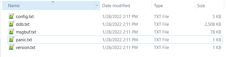

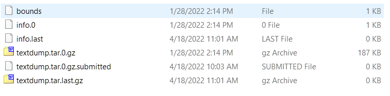

Here are the files moved/extracted to my machine
And the "textdump.tar.0.gz" file with some heaft.
Panic.txt
VERIFY3(c < SPA_MAXBLOCKSIZE >> SPA_MINBLOCKSHIFT) failed (36028797018963967 < 32768)
What I don't get is all of these crash files are from Jan. We have had at least 3 crashes since then. Where are those logs?
