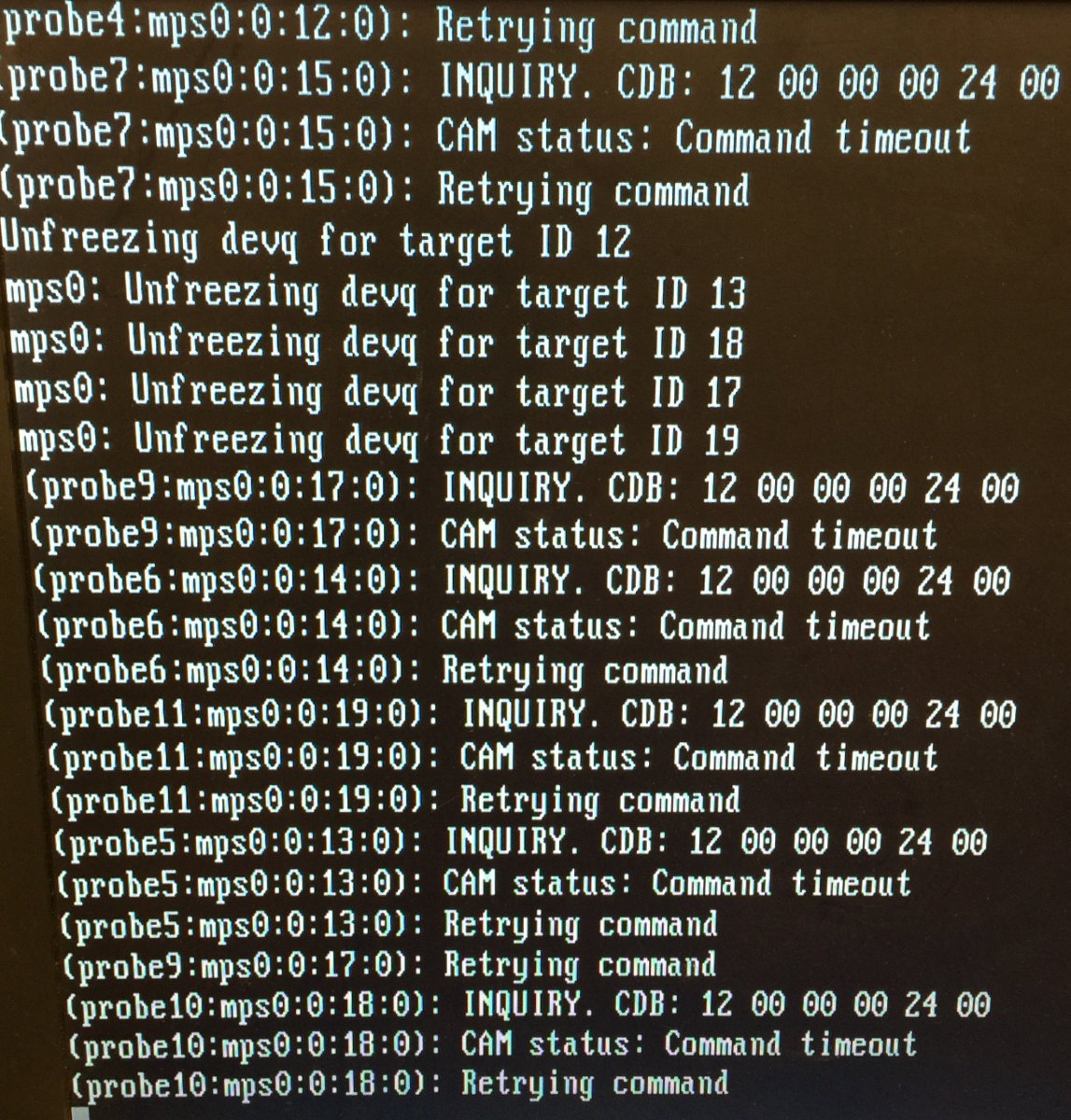

93ED638D-EDBE-4D84-99E1-B04218993D2A.jpeg Seems to be having issues...

I am not sure if you looked at this guide or some other guide:
https://forums.freenas.org/index.ph...o-crossflashing-lsi-9211-hba-and-variants.54/
You might want to go back and erase that card and start again. That output doesn't look right.
Look for this section in the link above:
FLASHABLE SOFTWARES ("BOOT ROM/BIOS" AND "FIRMWARE"): Confusingly, the 9211 cards have their flashable files in *two* parts. There are bios and efi "roms" that provides boot-time options, and these are *separate* files independent from the "firmware" (the part that actually controls the disks and responds to the OS). For the boot roms one can flash a BIOS orom, an EFI boot rom, or neither or both (as they can coexist).
For HBA use such as FreeNAS, only the "firmware" part matters. You don't need to flash the orom or EFI rom. The boot roms are completely optional and while nice, it slows boot and doesn't add anything really. It can be flashed later if you change your mind. You do *not* need to flash the bios/efi boot roms to get a fully functional card.

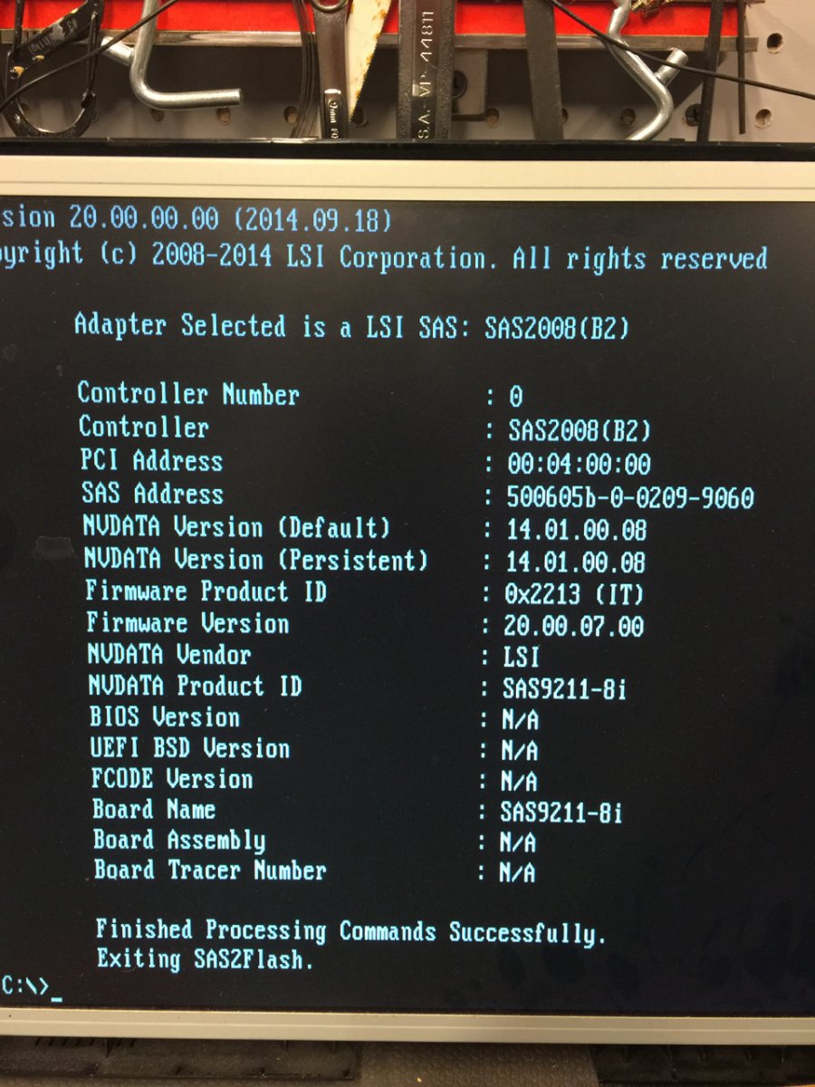

IMG_0013 (1).jpg Here is the output of -list on the new HBA that I flashed today. I did not have time to play with it much more so, I just put my original HBA back in.

You might want to take the "SOLVED" flag off the thread so that other people might look at this.
