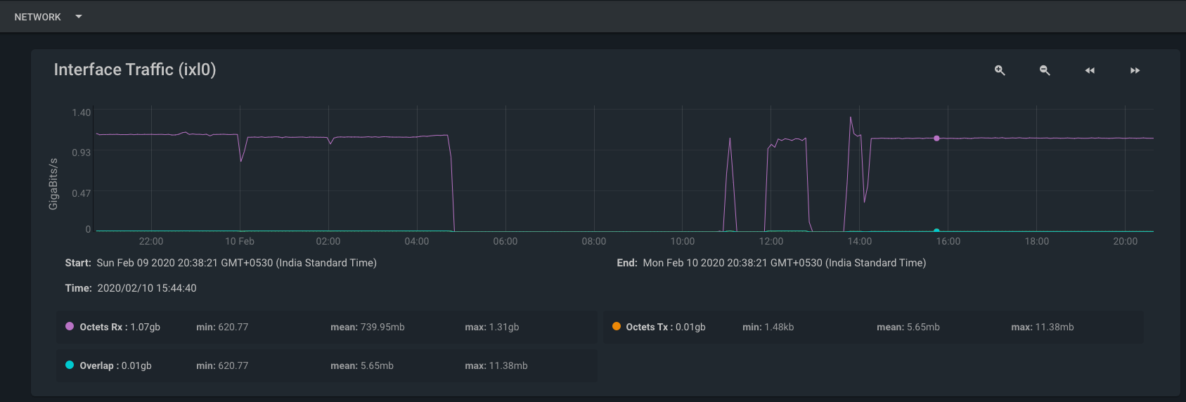

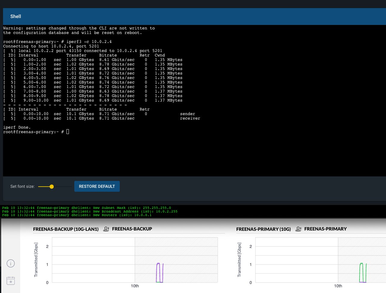

I currently have 2x FreeNAS boxes connected to a UniFi 16XG 10G Switch. I've enabled Jumbo frames and configured both interfaces (on the primary node and the receiving backup node) with MTU set to 9000. iperf3 doesn't seem to have any issues pushing ~8.7Gb/s. However, notice the 1Gb/s traces below (UniFi Dashboard).
On the receiving box:
What more can be done to troubleshoot this further? FYI I only enabled Jumbo frames and made the MTU change after noticing the 1Gb/s speed...

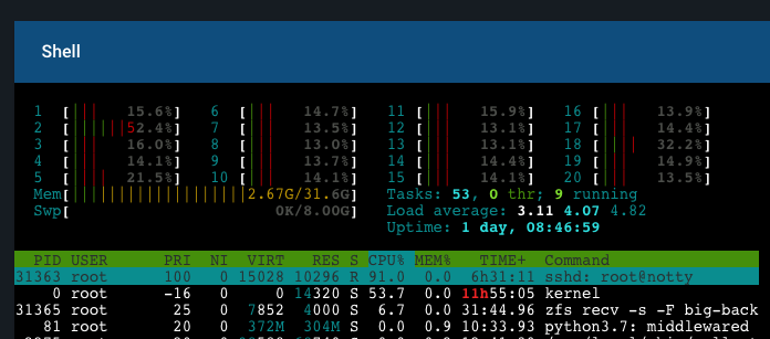

Seems `sshd` is running as a single-threaded task and it's pegging the receiving thread to ~98% CPU utilisation (on the 'Standard' Cipher, no compression).
