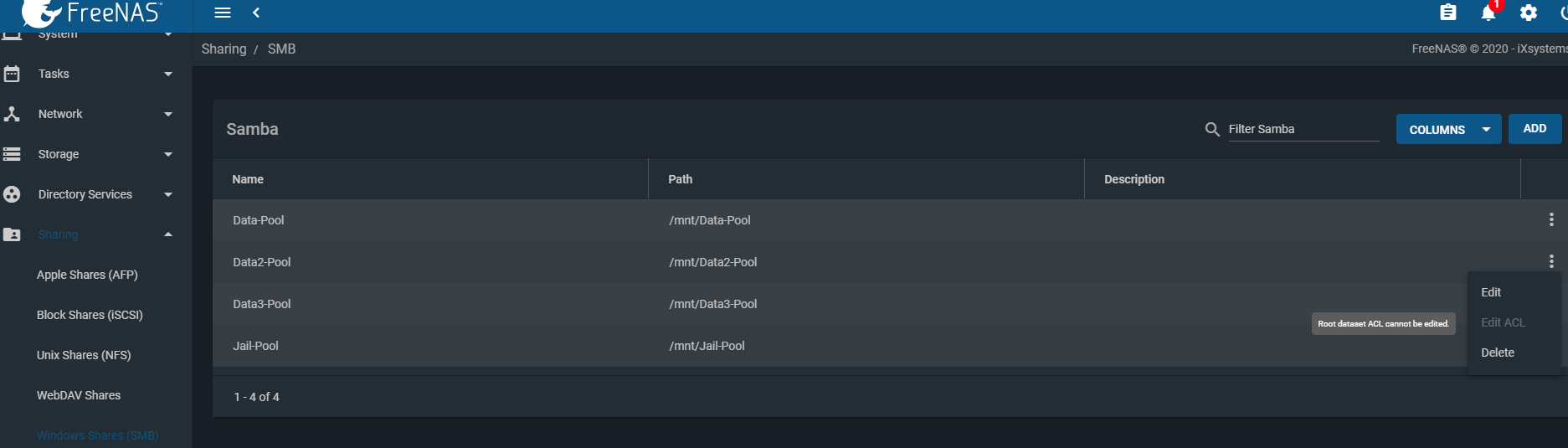

Hello,
I am new to FreeNAS. I recently installed 11.2U7 and upgraded it to 11.3 a few days ago. Since the update, my "Edit Permissions" and "Edit ACL" menus are greyed out in Pools and SMB Shares whether they are existing or freshly created. When I put my cursor on top of the greyed-out menu it says "Root dataset permissions cannot be edited/Root dataset ACL cannot be edited". Some help would be greatly appreciated.
Thanks.

I had the same issue with a root dataset. Not a big deal for me as I'm mostly only sharing out child datasets through SMB, but this was definitely working in 11.2 since one of my shares was set up that way. Possible bug if you want to submit.
KrisBee
Mar 20, 2017
1,288
It's not broke, that's the new behaviour in 11.3. You can't, and shoudn't, change the root dataset default perms/acl. @yeeahnick You need to create at least one dataset below the root in each of your pools. I'm guessing from your screen caps you have one phyiscal disk per pool, or least a bunch of disks of different sizes which you allocated to different pools.

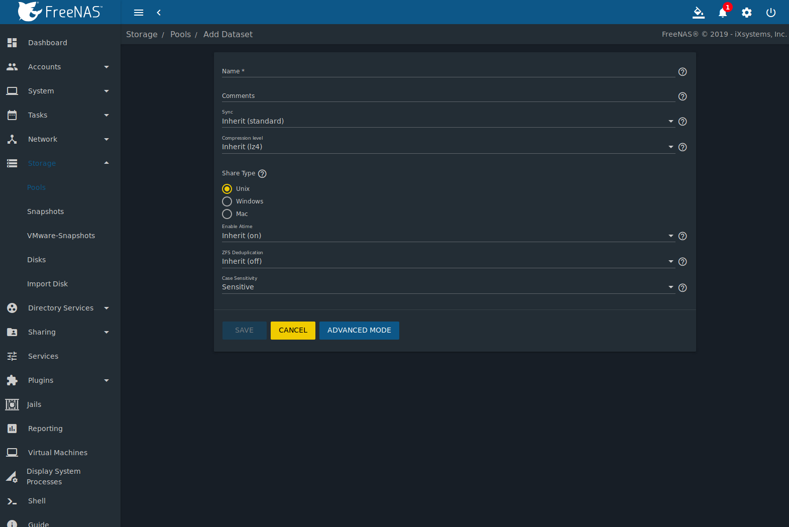

Ah crap I did not know the behavior changed as this was working prior to 11.3. I actually have 2 drives of the same size per pool, using a mirror configuration. I guess I set it up wrong? I just created a new dataset and the menus are now available. Will test and report back big thanks mate!
yeeahnick
Feb 2, 2020
17
Ok so I can access the permissions and acl for my pool dataset now but still cant access acl for smb shares. Also what do I need to do to set pool share type to unix like it was before?

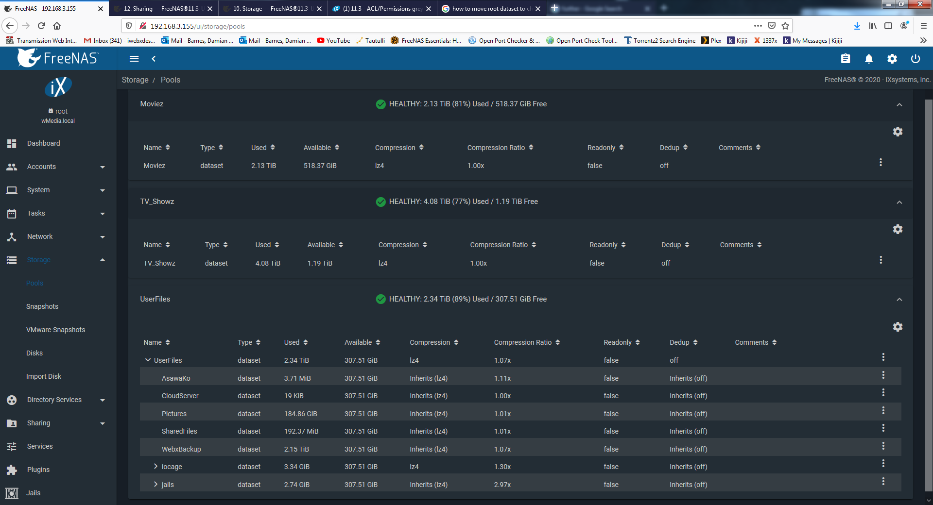

Hey not sure this was fully answered, BUT i have the same problem. I just upgraded from 9.10 to 11.3U1 and my existing pools for videos are under one big root pool dataset "movie". If you see in my screenshot I have 2 pools with this issue and they are larger drives that are both almost full.
This was not an issue with 9.10 as i could set permissions and it didn't matter that it was a root pool. I am not sure how to move the "movies" to a child dataset so that i can set permissions. I use SMB shares for my windows PC's and actually i was only able to get READ only access to the root pool shares.
can someone please help me, what can i do at this point?
