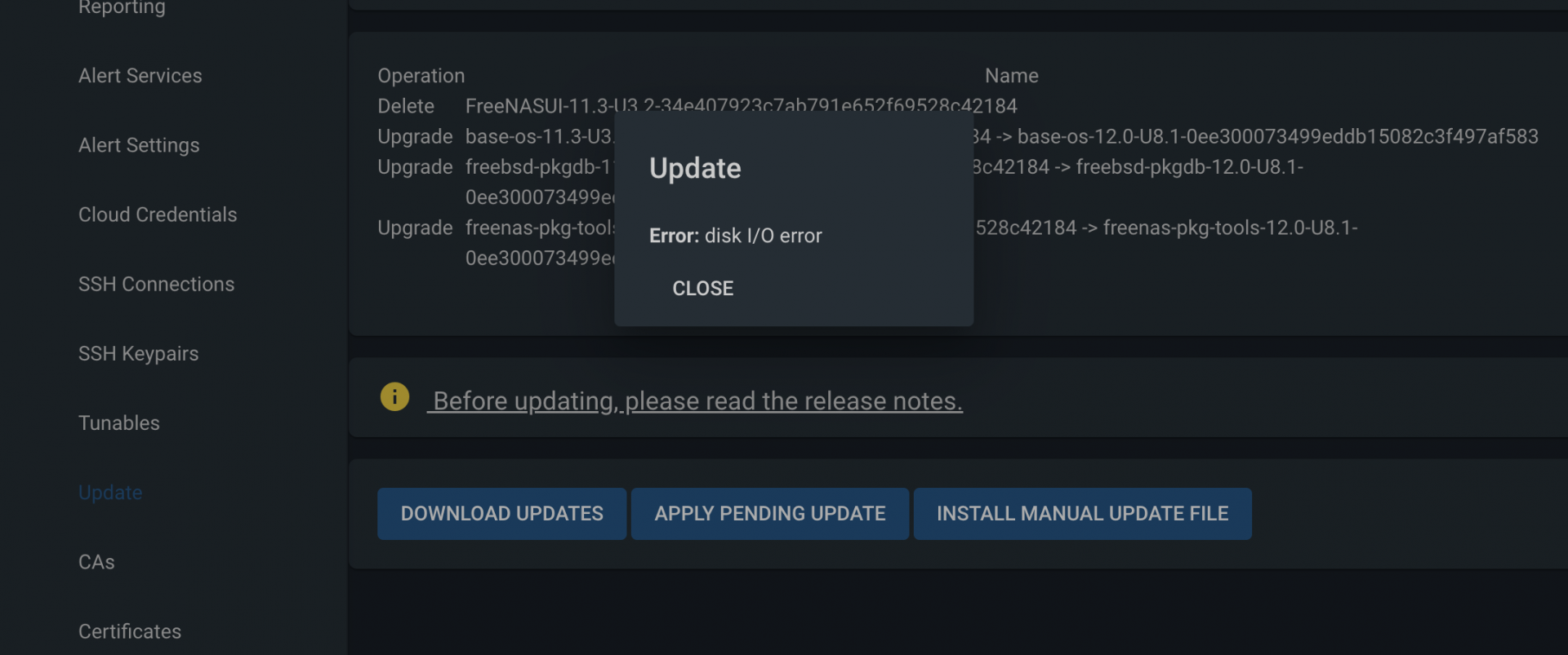

11.3 -> 12 Update disk I/O error trying to upgrade
kylmp
Jan 7, 2023
5
Hi all, I am updating to truenas 12 from 11.3-U3.2 but after it downloaded the ISO, it fails here. Does someone know how I can further debug this? Never seen any issues with my disks currently until, well this.
9,700
That can happen if your boot pool is close to full... maybe check that under System | Boot
