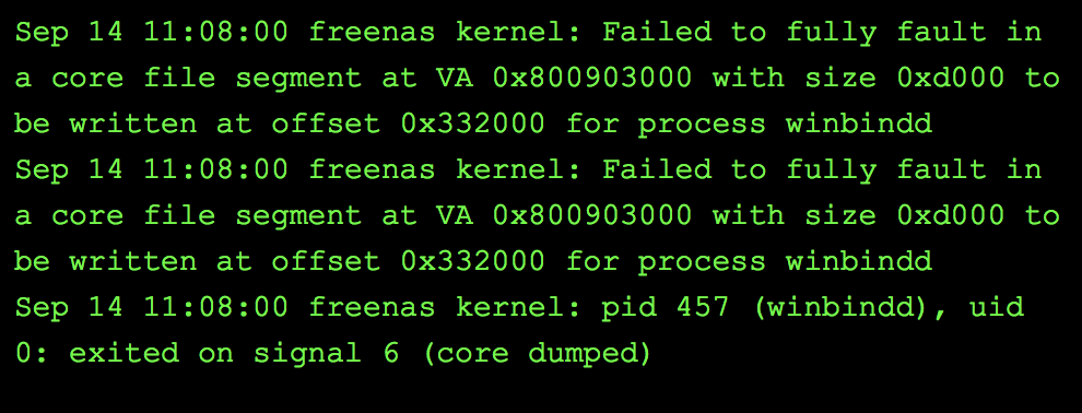

I think, this could be the reason:

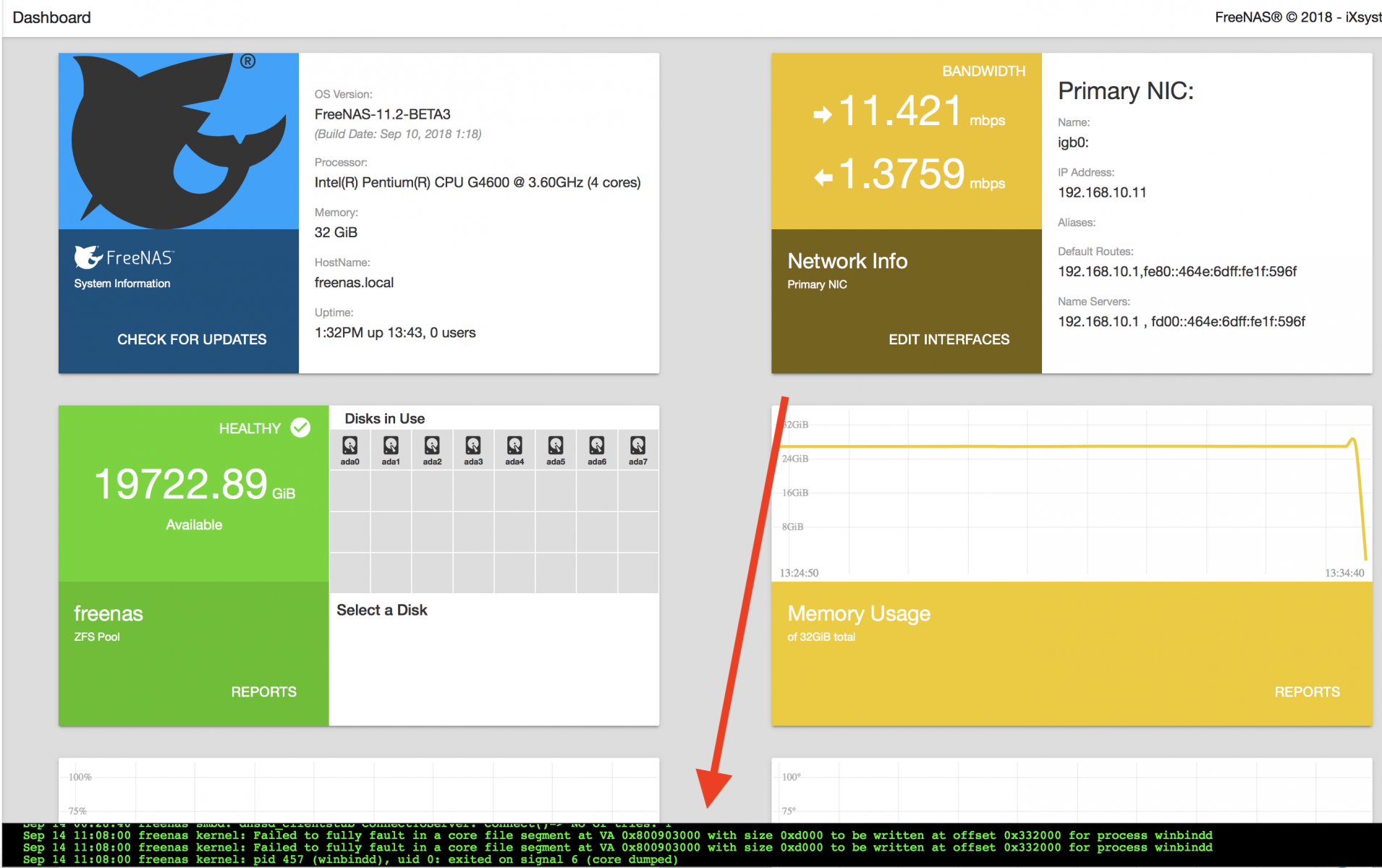

I got this message from this little window at the bottom of the Web-UI.
Pease check output.txt for the output of the suggested commands.
