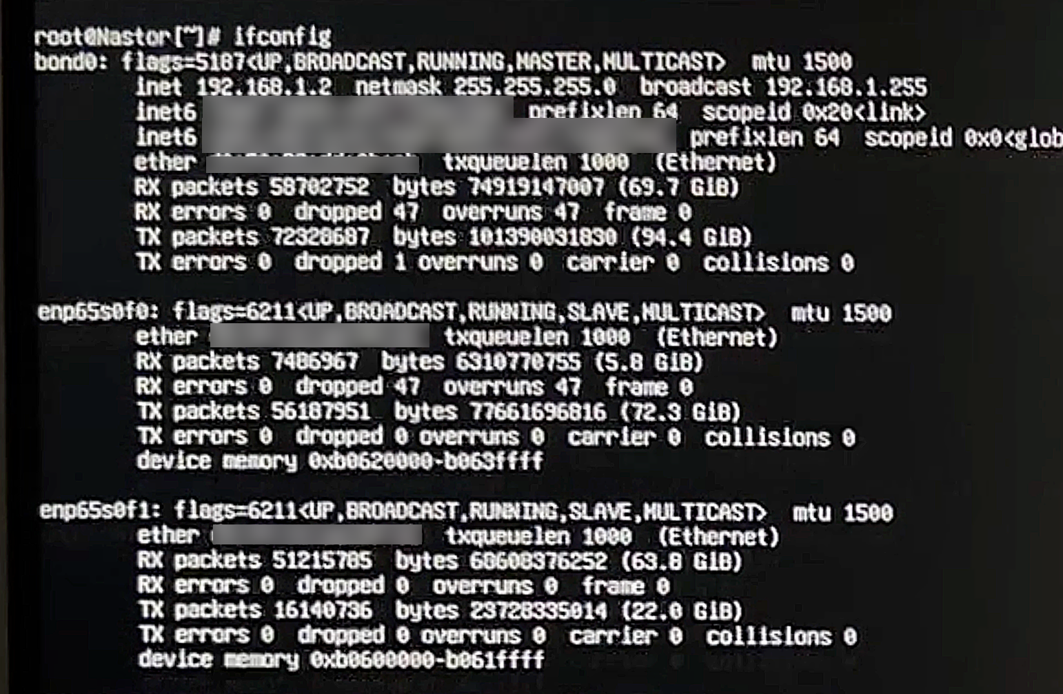

Hi everyone!
I've juste built a very nice NAS for the company i'm working for. Since we do video editing i wanted to have the maximum speed possible.
Here's the config:
AMD EPYC 7282
ASRock Rack Epyc D8-2T (wich as x2 Intel x550 2t 10GbE )
128Go ECC RAM for ZFS Cache
A lot of storage on HDD with L2ARC and a fast array of SSD
To connect this NAS to the network I use a Unifi Enterprise XG 24 wich is a 10Gbe switch. All my cables are 10GbE compatible and tested.
I want to connect the NAS using both of the 10GbE port and aggregate them for maximum speed.
I manage to bond the connexion but I'm stuck at 1GbE. i've tried to force 10GbE from the Unifi switch but i'm just loosing the connexion with the NAS.
Can someone know how to fix that?
Thank you for your help!!
(I've joined a picture of a ifconfig command)
