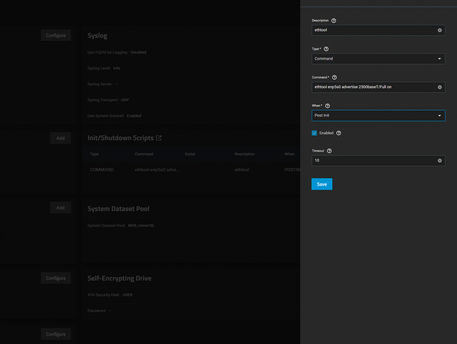

I did try this before, and its been set, but it doesn't work, this is the same command I use in Shell to enable it in the first place. So I think I gave up unless you see something I am not doing correctly.

Actually I think I just saw the problem, it was set for POSTINIT not PREINIT... soo yea Im a n00b.. leave me be. Ill see if it works on next reboot lol.

It all looks good, though you may need to specify the full path to ethtool: /usr/sbin/ethtool ...

Gee thanks, I changed it, still waiting to test to see if it works, ill respond back here soon after a backup completes.
