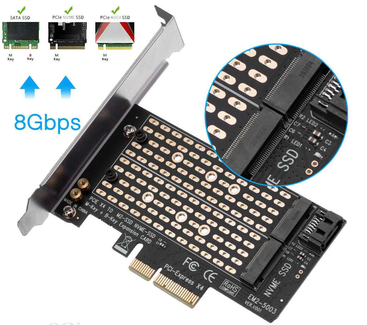

Anyone here know how to use one of these?
There is nothing on the card stating which connector is port 1 or 2.
There is no information explaining why there is a SATA data connector.
Does the first m.2 card get power and data flow through the PCIe connection while maybe the second one only gets data but needs the SATA data connector for data transfer?
There is one SATA connector on the motherboard (for tape drive) but no power so if I could power the second optane from the PCIe card, then I could use that one for the Os.
The seller only repeats sales info, not how one uses this.

Since PCI 2.0 x4 only supports 1x NVMe device, I suspect you've got a board that supports 1x M.2 NVMe drive, with the upper slot only supporting 1x M.2 SATA drive, with a pass-through SATA connector for a motherboard SATA port.

Is there anything you don't know about storage? :). I'm impressed.
Ok, so, I could use this for both the Optane and a second optane for the OS, wired to the mobo using the SATA cable.
I think this is what you are confirming.

Sorry, I edited the above comment with more info about the PCIe card. If I can find a reliable seller, do you feel those drives could be worth the cost?

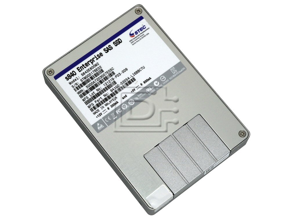

I was able to pick up 10 of these so I sure hope they will do the trick.
The specs are nice, they have a SAS interface and no encryption capabilities.
I installed the PCI card with the two modules on it and the TN installer sees both storage devices. The 64GB kingdata is being seen as a DogFish SSD. Never heard of that.
I re-installed the OS onto the 64GB device and have the drives on order so now have to wait to move on.
