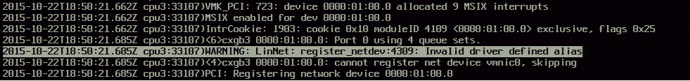

It installed but hung on reboot "Loading module cxgb3" I don't have anything plugged into the card and don't know if that has anything to do with the hang (I doubt it). I'll need to spend some time troubleshooting.
Had the same issue with a "Chelsio 110-1088-30 10GB" on ESXi (5.5 Update 3). Instead I used a "QLogic QLE8152" (paid $50.00 for it on eBay) for ESXi. Runs smooth and ESXi is very happy with that card. Card is certified with ESXi and Drivers are easily available (http://www.vmware.com/resources/compatibility/detail.php?deviceCategory=io&productid=13830)
For FreeNas, I use the "Chelsio 110-1088-30 10GB" (was ~ $70.00) on eBay. So far I am very happy with both cards for each system and will buy a couple more when I see them for a good deal on eBay.

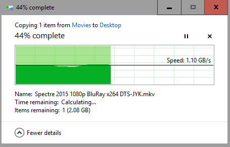

I know this post is kind of old, but I wanted to updat it for anyone looking in 2016. I am using the Mellanox connectx-2 SFP+. It works very well for me now that the drivers are integrated in freenas 9.10. I attached a screen clipping of my first SMB file transfer. It amazingly, just worked out of the box. I am using a cheap DAC cable and connected it to a windows 10 workstation. With manually assigned IPs and everything in a ram cache I was able to max out throughput without any configuration changes.
If anyone wants to play with 10 Gbe, and only spend $50 for cards and cable, here you go:
http://www.ebay.com/itm/131634470127?_trksid=p2057872.m2749.l2649&ssPageName=STRK:MEBIDX:IT

Awesome. I don't have any super fast storage to test sustained throughput with, so I've only been able to get ~350MB/s with mine. Glad to see the Mellanox adapters really can reach proper speeds. :D
