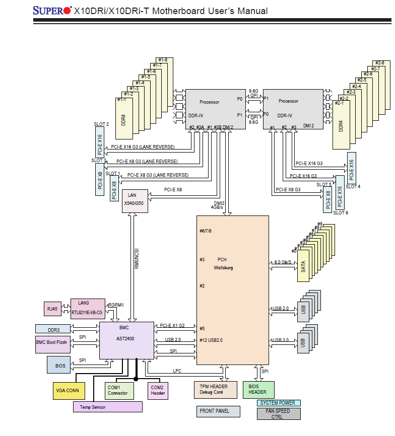

The X10DRI and X10DRI-T are basically the same board except the '-T' has a dual 10Gb NIC with the x540 chip instead of i350. I can't find a DRI-T for a respectable price though, so have to fall back on the base DRI here. The DRI-T4+, however, looks similar but is pretty different under the covers. It stouts a quad-10Gb NIC I/O and 8 additional slots for memory. It looks like a beast for the price, but the data architecture is all different and I'm worried I'll have bottlenecking issues in the future when I try to set up my m.2 cards for the SSD/NVME VM pool.

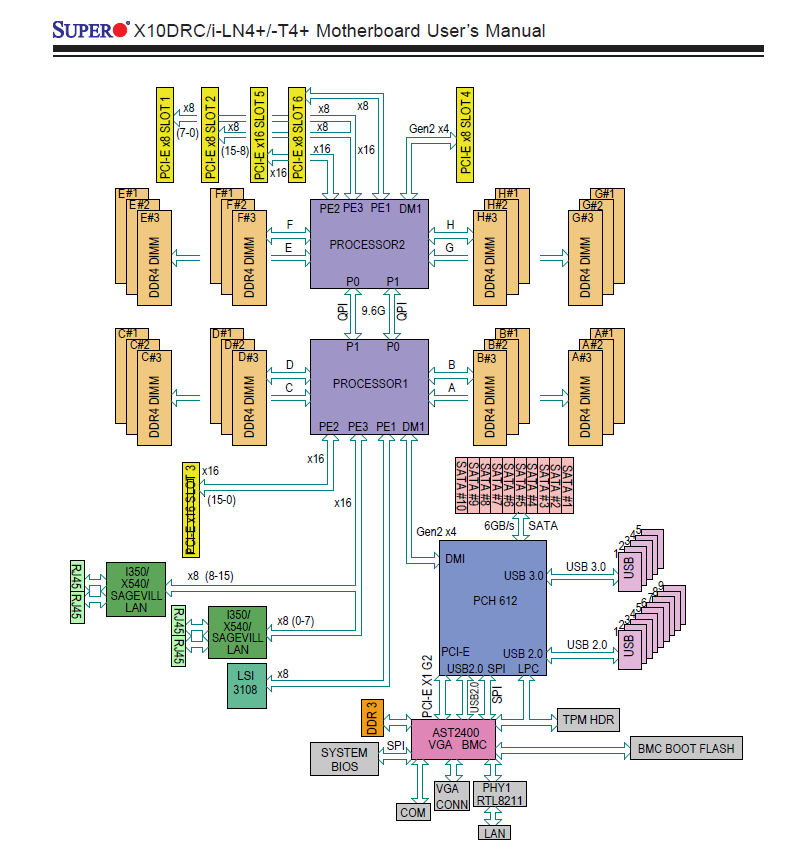

If you take notice, the LN4+ has all but one of its PCI slots routed through Processor 2 and leaves only 1 3.0x16 on Proc 1. The Base board has a fairly balanced setup. I assume this change is because the LN4+ needed more bandwidth for the Quad 10Gb ports but it's a bit annoying it kills the functionality of almost all the PCI cards. Right now I only have one processor available so I would be limited to just the one x16 slot, which I would need to use for my SAS HBA. (Speaking about the LN4+) With this general setup, the data would I/O from the NIC to Proc 1 to the RAM, to the HBA. I know there's more to it than that, but just being crudely general. The plan was later to add a second proc and install a dual or quad port m.2 card with NVME sticks, install a 10gb NIC on a proc 2x8 lane, and keep the majority of data traffic on the proc 2 side of the machine, hoping to minimize data through the QPI. I am trying to avoid all the data being unnecessarily funneled through a single processor or NIC chip, and from what I understand trueNAS has very good DP/MP support to prevent this.
Am I completely off here or is this a legitimate concern? I figured if I had a set of HBA/Storage and NIC on a single processor side it would tend to keep the data on that side for load balancing. e.g. a SSD pool on Proc 2 and HHD pool on Proc 1. Is the LN4+ a good board for the price? Maybe this would make a better VM board and I should just swap it with the one I already have. Then install a sperate NIC on each proc side and leave the on-board 1Gb's for kernel/web access.
