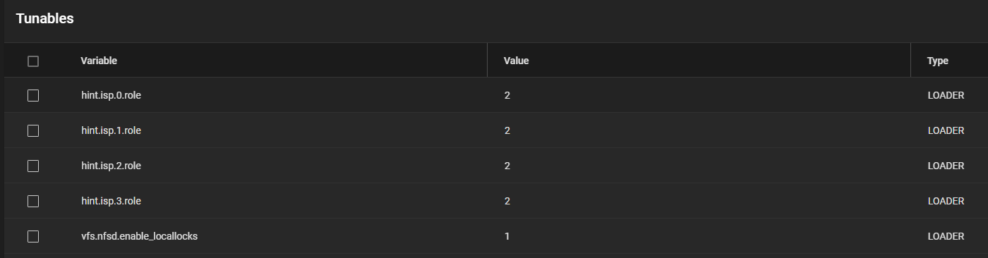

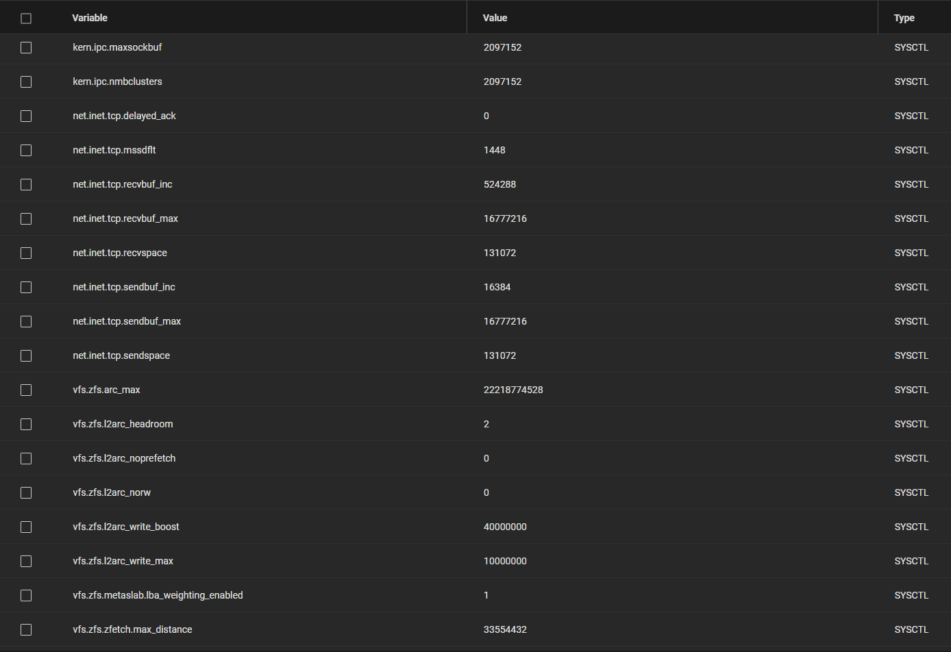

@jgreco I have not looked at tunables since I stood this array up back in 2015... I vaguely remember maybe setting some, but boy, its been a long time...
I see these are not "generated by autotune". Any of these hurting anything or should be adjusted further?
Autotune has these:
I will edit tho ones in your guide on 10gb+, but just wanted to confirm these all look fine.

You can try the 10 Gig tuning article under Resources to see if you can get it better.
Hmm, I stopped at this step net.inet.ip.intr_queue_maxlen: 2048, so I did everything before that.... and I think my read speeds went down ~50-100mbps. Write speeds seemingly went up? Maybe this is a result of having just rebooted and ARC not being filled at all yet? I rebooted the machine earlier this morning for unrelated reasons and have not touched any of these files since, so I am not sure how it would have populated anything into ARC on the previous test either.

I would jettison most of that and make sure autotune is disabled. At one time, someone thought (sort of correctly) that FreeBSD didn't suitably tune for the ZFS and heavy fileserver environment. I'm actually trying to collect some of the more obscure tunables that have been recommended in the past so that I can do a walkthru to determine value in the modern era. You might notice I have a cryptic comment about per-device tunables; I think a lot of tunables get blindly parroted from forum posts, such as hint.isp stuff, which would be for Qlogic fiber channel controllers.
I will give that a try. Should I chuck literally everything? I am entirely unsure what is needed vs not-needed here.
I did just up my truenas VM from 24 to 30Gb and went from 8 to 14 vCPU's as I saw it was getting very high on CPU utilization during writes. So... I admit this is no longer going to be straight apples to apples testing. But, I figure I should throw a little more resources at it since I have them.
Oct 22, 2019
3,641
Those are default out-of-the-box for TrueNAS Core (fresh installations).
To this day I still don't know why they are populated by default on new TrueNAS Core systems.

Hmm, well, I disabled all the auto-tunables, set the options in 10 Gigabit tuning, and it didn't seem to make much difference at all, if anything its slightly slower :/. I suppose the good thing is I mostly just write to the NAS (I don't bother trying to photo edit directly off it, I was hoping maybe this would give me a shot at it, but honestly adobe lightroom is not even "fast" when reading from local SSD............). But at least I can write to the box at ~3 gigabit-ish. Too bad I am only seemingly able to read from it at 1-2.5 depending on the files.
Probably because FC is "sorta" somewhat supported, I can't remember when that happened, but you need the correct role in a FC topology.
