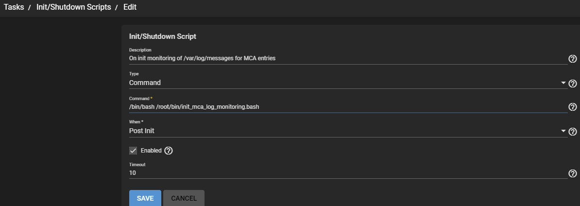

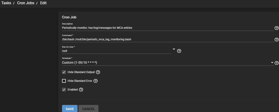

The cron job
Init script

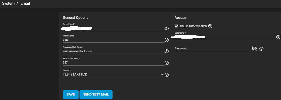

  • Properly configure and test your email settings in TrueNAS / FreeNAS.

  • Make sure you execute the scripts as bash scripts
    • Either configure the executing user to have bash as shell
    • Or run the scripts as an argument of /bin/bash. For example "/bin/bash /root/bin/periodic_mca_log_monitoring.bash"

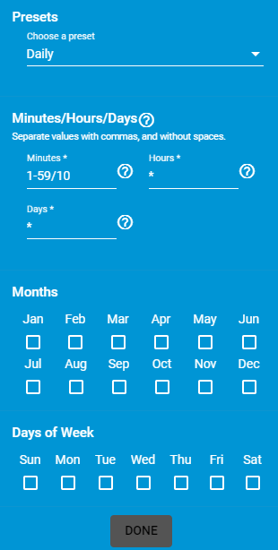

  1. The cronjob schedule "1-59/10 * * * *" = Every 10 minutes, at 1 past the 10-minute-block (for example: 01, 11, 21, ...)
  2. The /root/bin/email_mca_log_messages.bash script is executed
  3. egrep "$(date -v -10M "+%b %e %H:%M" | sed 's/.$//') ..." = The script searches for MCA messages in the previous-10-minute-block (for example: at minute 01 it will check minute 50-59 from the previous hour, at minute 11 it will check minute 00-09, at minute 21 it will check minute 10-19, etc)
  4. bzcat /var/log/messages.0.bz2 and cat /var/log/messages = It searches them in both /var/log/messages and /var/log/messages.0.bz2 (to properly work during log rotations)
  5. egrep "... .*$(hostname -s) MCA.* = To make sure only MCA messages are reported
  6. echo "${MCA_MESSAGES}" >>"${MCA_LOG_PATH}" = The processed messages are stored in a file
  7. mail -s "<subject>" "<youremailaddress>" <<< "<message with MCA messages>" = And the MCA messages are emailed to an address of your choice
