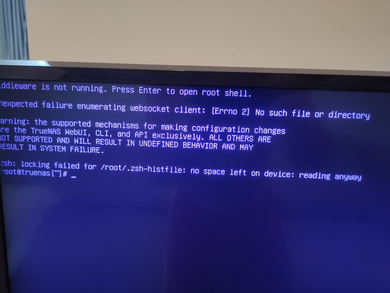

Hello. I need help fixing an issue with my TrueNAS Scale.
The web UI is not loading. I suspect the problem lies with the old boots, but the UI is inaccessible, and I'm unsure how to prune the old boots.
Actual installed version is: Truenas SCALE 22.12.3.3

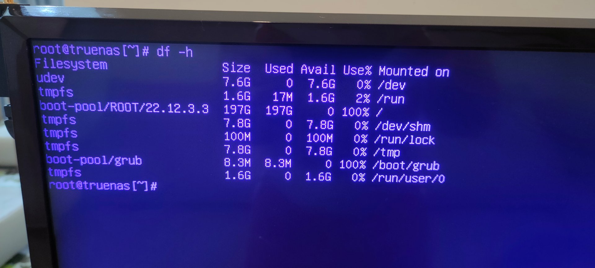

Using
df -f
this result:
the error is:
I appreciate any ideas to resolve.

zfs list -t snap -r boot-pool

You can delete old images using cli I believe. So, get into truenas in a shell and type cli. Then system, bootenv
query will then show you all the old boots. delete will then allow you to delete them by the id column.

@Patrick M. Hausen looking at the snaps I only have this
NAME: boot-pool/ROOT/22.12.3.3@2023-10-01-22:42:12  USED: 10.2M
AVAIL: -
REFER: 2.65G
MOUNTPOINT: -
@sfatula Unfortunately middleware isn't running, and can't start because of this error, so cli isn't available.

I thought it might be an issue with the boot drives, so I swapped boot order, to no avail. Next up is to try to reinstall TRUENAS, but I'd rather try any other solutions that others might have.

cd /
du -skx * .??* | sort -rn | head
