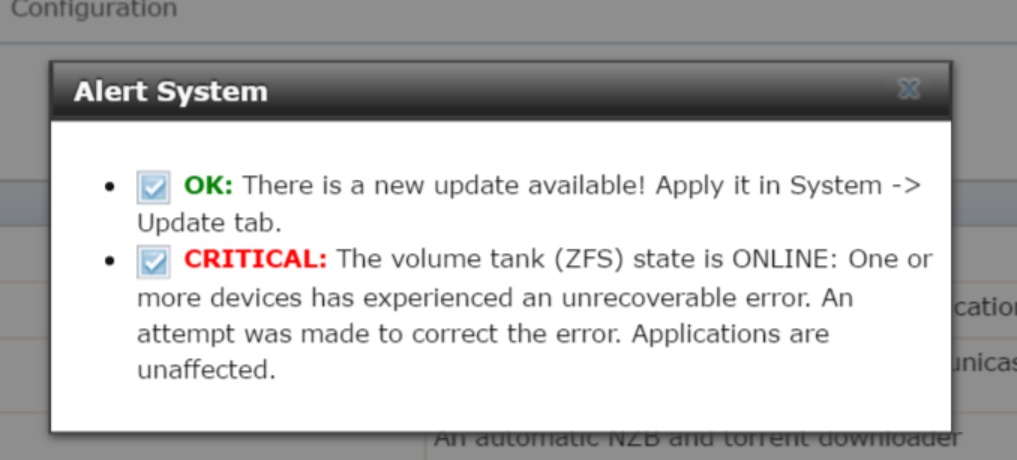

you guys are not gonna believe this....
i powered down.. unclasped a stick of memory so i can pull it to see the sticker
put the memory back in the motherboard
powered up
came in the other room, logged into the gui, and all hard drives are there!!!! and it says that its resilvering one!!!
now it says this...
ethereal
Sep 10, 2012
762
well done - i'd still replace the seagate asap

one more thing guys.. does this tell me anything i should know?
Welcome to FreeNAS
[root@freenas] ~# zpool status -x
  pool: tank
state: ONLINE
status: One or more devices has experienced an unrecoverable error.  An
        attempt was made to correct the error.  Applications are unaffected.
   see: http://illumos.org/msg/ZFS-8000-9P
  scan: resilvered 49.4G in 0h20m with 0 errors on Fri May 27 05:04:32 2016
config:
        tank                                            ONLINE       0     0     0
          raidz2-0                                      ONLINE       0     0     0
            gptid/7ea641e5-2398-11e4-b424-10c37b949d82  ONLINE       0     0    30
            gptid/7f0871b3-2398-11e4-b424-10c37b949d82  ONLINE       0     0     0
            gptid/7f6b618c-2398-11e4-b424-10c37b949d82  ONLINE       0     0     0
            gptid/7fcfaad8-2398-11e4-b424-10c37b949d82  ONLINE       0     0    26
            gptid/80883a33-2398-11e4-b424-10c37b949d82  ONLINE       0     0     0
            gptid/814b9861-2398-11e4-b424-10c37b949d82  ONLINE       0     0     0
errors: No known data errors
[root@freenas] ~#
ethereal
Sep 10, 2012
762
probably caused by bad drives - hopefully one is the seagate. i'd replace all drives with cksum errors.
