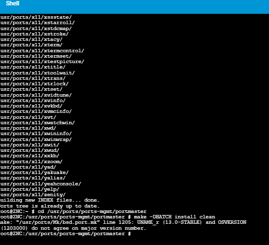

Following the thread here trying to setup a ZNC on my server again. Ran into this problem;
3. Now to update the ports you have. We will compile portmaster and use that to update the ports installed applications you already have.
# /usr/ports/ports-mgmt/portmaster "
root@ZNC:/ # /usr/ports/ports-mgmt/portmaster
/usr/ports/ports-mgmt/portmaster: Permission denied.
root@ZNC:/ #
Followed everything directly but can't get past this. Everything fine up until this point. Made a new user, gave it sudo and made it owner of the jail etc and tried logging in with that and still no dice. Tried googling the error and none of the posted solutions worked etc.

"don't know how to make install" with a beta-13 basejail
tried the previous release basejail (which I know it worked on):
9,700
portmaster is old/deprecated, you should use svnlite or git to update ports now:
svnlite co https://svn.freebsd.org/ports/head /usr/ports
or
svnlite co https://svn.freebsd.org/ports/branches/2021Q1 /usr/ports
followed by
cd /usr/ports; svnlite update for subsequent updates.

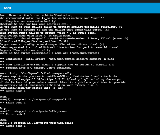

Fails near the end of make install clean :(

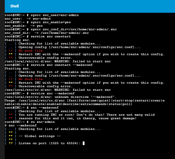

I've just installed the pkg and following the old guide, did adduser, created the znc-admin user, the next step would be "
cd /usr/ports/irc/znc
znc --makeconf" to create the config file, but since it's not a port I'm gonna try and find the right place.
Edit: Figured that out.
9,700
You can entirely replace the ports/make instructions with pkg install znc (yes, that's all).
At the end of the install, it is supposed to display for you the message on how to launch the config maker:
su -m znc -c 'znc -d /usr/local/etc/znc --makeconf'

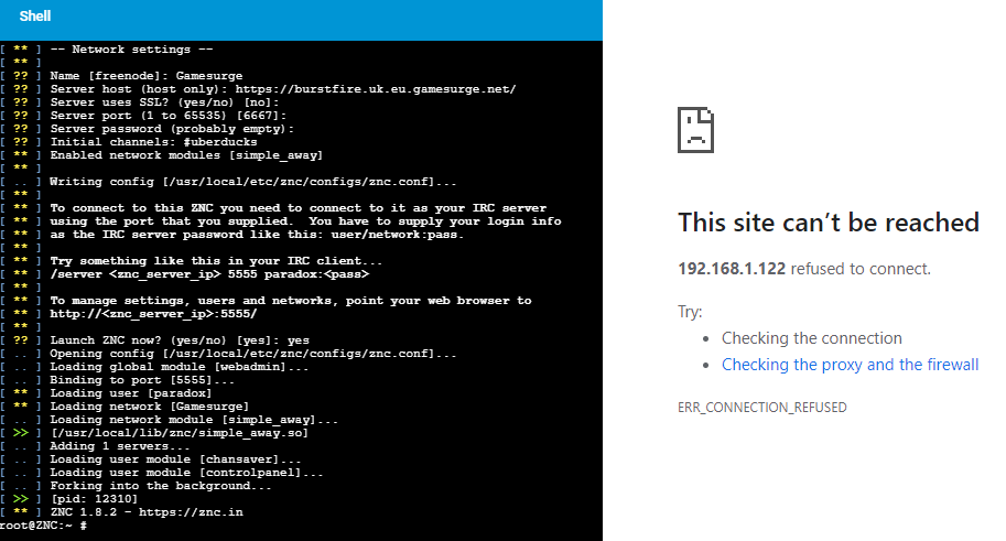

I've got it running and connected to irc, but the web-ui won't load, the config-result said go to jail ip:<listen port,5555>,
"This site can’t be reached
192.168.1.49 refused to connect."
Any ideas? I think this is a problem I had a few times trying to install it and the ports version just ended up working for me.

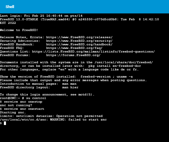

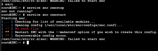

Latest attempt I tried restarting the service, "does not exist in or blabla" even with : ${znc_enable:="YES"}
Not really sure why it works and connects with the user I create when I make the config, but no webui, and can't stop/restart it :|
