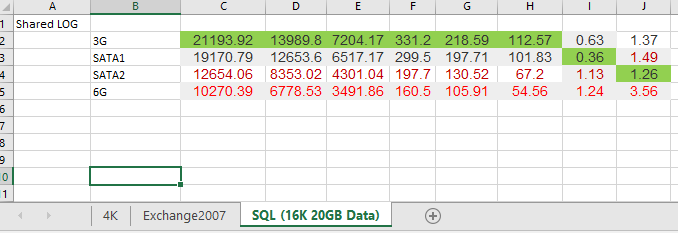

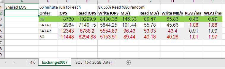

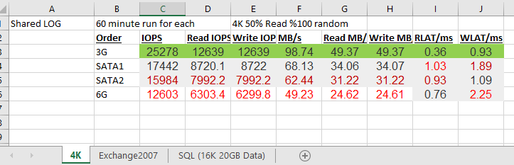

If it's helpful, here's numbers I just ran for funzies that might show you can easiy reach you performance objective with the right equipment and config:
This data was obtained using VMware's IO Analyzer appliance, running on one of the hosts.
3G is a 24 disk 146GB SAS enclosure, setup in mirrored pairs (12 of them)
6G is a 12 disk 300GB SAS enclosure, setup in mirrored pairs (6 of them)
SATA1 is on a 12 disk 2TB SATA enclosure, setup in mirrored pairs (6 of them), using zvol extent
SATA2 is on a 12 disk 2TB SATA enclosure, setup in mirrored pairs (6 of them), using file based extent
I use two enterprise SSD devices for a striped SLOG and two standard SSDs for cache devices
They were setup as shared devices (meaning each pool used a partition on them). Don't do this, it was just for testing. It worked perfect with no noticed side effects of extra latency from sharing, but since you mentioned being a business, use dedicated log/cache devices for each pool
*Your milage/performance will vary, hopefully you can just see some differences between disk types, and that caching makes SATA an option under certain circumstances. Nimble storage is a very good vendor doing this.
EDIT: In case it matters for your own testing, I ran 60 minute tests and my system needed about 15 minutes of running the test to completely get the cache utilized. Then I got 45 minutes of stable performance data. My normal workload was running in the back ground, and I ran each test separately rather than running a bunch of them at once. They were the included tests VMware included in the appliance GUI
