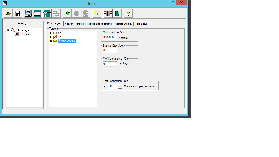

Ok, so in my assembling the information you requested I saw that one of my switch links had autonegotiated at 100Mb rather than 1000Mb. I fixed that problem, now I am seeing 2536 IOPS and 158MB/sec transfer. Does this seem inline with what I should expect, given my hardware and configuration (its a GREAT improvement)? I am doing an iometer test 100% sequential write with 64K blocks. Is there a performance testing methodology you prefer? If there is an existing article on it, I am happy to read that too! I am using this for an MSSQL server serving up pdf files (some up to a few MB in size). It doesn't need to be a speed demon, but would like to get the most out of what I've got. I mention it because that can probably effect the testing methodology.
Thanks!
