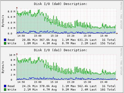

For a period of time, we see that the disks in the 2nd vdev are extremely busy, and have high latency, while the other vdevs are performing as expected.
As you can see from the following gstat output, the disks in the 2nd vdev are running at 100% busy and the latency for flushing is over 250ms:

5 194 61 12 700 18.2 131 24 3107 0.7 0 0 0 0.0 2 45.6 35.1 da0
11 274 138 8 1122 12.1 134 22 3015 0.2 0 0 0 0.0 2 21.2 42.6 da1

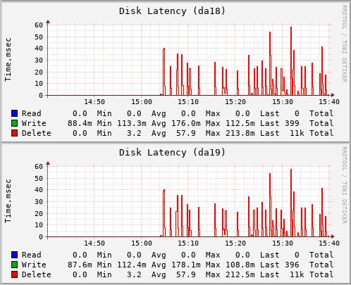

0 3152 0 0 0 0.0 1605 36 57103 0.1 0 0 0 0.0 1547 0.0 21.7 da18
0 3152 0 0 0 0.0 1605 36 57103 0.1 0 0 0 0.0 1547 0.0 21.4 da19

I've made the following observations while experiencing the issue:
1. According to the gstat output, the IO size of the write operations average around 6-8KB on the 2nd vdev, whereas on the other vdevs the size is around 20-30KB.
2. The number of writes operations to the disks in the second vdev is higher than the writes to the other vdevs.
3. All the disks in the second vdev are running on average at 90-100% busy. The other disks are running at around 40-50% busy.
4. There is not one specific disk in the 2nd vdev which is causing the issue.
5. We're running with sync set to always, and when I run zilstat, there are very few operations between 4-32kB being written to the slog from the clients.
6. The issue normally lasts for a few hours before it disappears and the performance becomes uniform across all the vdevs again.
My theory is that the small write size is making the disks in the vdev extremely busy, and causing the high latency, slowing down the pool performance. But where are the small IOs coming from, if they're not coming from the clients (I can't see them in zilstat)? And why are they isolated to the 2nd vdev? Shouldn't it be spread across the vdevs assuming equal usage across the pool? Could it be some kind of internal ZFS workload that I'm not aware of causing the issue?
Appreciate any thoughts / ideas from the community.
