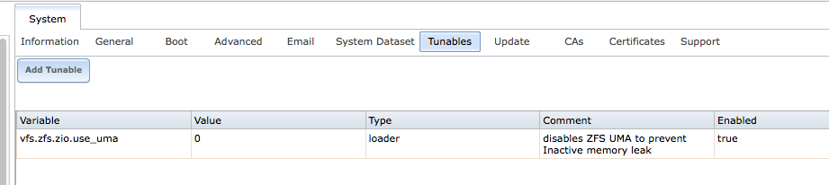

Try disabling UMA. And if that fixes it, report this as a bug.
https://forums.freenas.org/index.php?threads/swap-with-9-10.42749/page-3
TLDR; UMA + ARC is buggy, and causes memory exhaustion when a server is thrashed.
