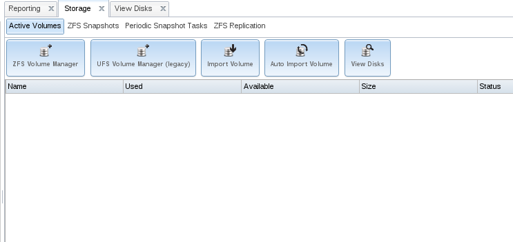

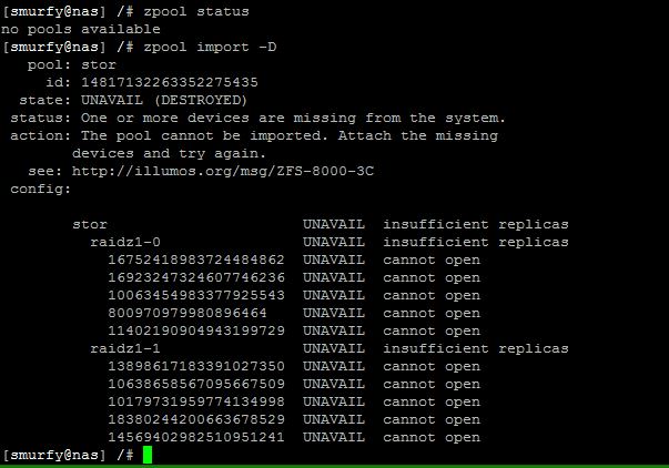

oh boy, i really hope you guys can help me work some magic, 3/7TB is not backedup off server. i've recieved all good status emails from freenas 9.1.0rc1 last night and i decided to restart the computer. when starting it does not see my pool at all, the pool is listed as an option but says error for any information about it. i detached it and tried to auto import or shell import and it is not seen. i was not having any issues at all before powering down. i have upgraded the pool to zfs v28 5000 so i can no longer use the 8.3.1 usb stick to import the pool.
FreeNAS 9.1.0 RC1 x64 (e3440c6)
[smurfy@nas] /# zpool status
no pools available
[smurfy@nas] /# zpool import -FX stor
cannot import 'stor': invalid vdev configuration
some requested outputs...

i saw this message before when i was having the issue importing the pool, which worked fine in 8.3.1, disabling "sysctl vfs.zfs.vdev.larger_ashift_disable=1" enabled me to import. after i was able to import it i reenabled it, with no issue until the reboot. i've now disabled it again and see:
[smurfy@nas] /# sysctl vfs.zfs.vdev.larger_ashift_disable=1
vfs.zfs.vdev.larger_ashift_disable: 0 -> 1
  pool: stor
  state: ONLINE
action: The pool can be imported using its name or numeric identifier.
config:
stor                                            ONLINE
raidz1-0                                      ONLINE
  gptid/8193e730-6aab-11e2-9f2f-00248c450018  ONLINE
  gptid/81f6b150-6aab-11e2-9f2f-00248c450018  ONLINE
  gptid/8255a13f-6aab-11e2-9f2f-00248c450018  ONLINE
  gptid/8402337d-6aab-11e2-9f2f-00248c450018  ONLINE
  gptid/8470dafe-6aab-11e2-9f2f-00248c450018  ONLINE
raidz1-1                                      ONLINE
  gptid/7ff753f5-edb7-11e2-b265-00248c450018  ONLINE
  gptid/805c1416-edb7-11e2-b265-00248c450018  ONLINE
  gptid/80c4b729-edb7-11e2-b265-00248c450018  ONLINE
  gptid/812e5515-edb7-11e2-b265-00248c450018  ONLINE
  gptid/8197afa9-edb7-11e2-b265-00248c450018  ONLINE
[smurfy@nas] /# zpool import stor
cannot mount '/stor': failed to create mountpoint
i did see a file that was 1.98GB /mnt/stor/something.000 that i deleted, doh and realize now that may not have been user generated. note: auto import fails, shows no pool available. sorry about the long post i just wanted to make sure i gave everyone what they asked for.
strangely, i tried again
[root@nas ~]# zpool import
[root@nas ~]# zpool import stor cannot import 'stor': a pool with that name is already created/imported, and no additional pools with that name were found
  • Screenshot - 07182013 - 10:28:34 AM.png
  • Screenshot - 07182013 - 10:52:28 AM.png
delphij
FreeNAS Core Team
Jan 10, 2012
37
oh boy, i really hope you guys can help me work some magic, 3/7TB is not backedup off server. i've recieved all good status emails from freenas 9.1.0rc1 last night and i decided to restart the computer. when starting it does not see my pool at all, the pool is listed as an option but says error for any information about it. i detached it and tried to auto import or shell import and it is not seen. i was not having any issues at all before powering down. i have upgraded the pool to zfs v28 flags so i can no longer use the 8.3.1 usb stick to import the pool.
Don't worry! Based on what you have described, your data is safe.
What you need to do would be, for now, if you see this but there is no new RC published yet (which we are likely to do soon):
Go to "System" -> "Tunables", shown here: http://wiki.freenas.org/index.php/Settings and add the tunable, then restart the system.
Then the system should be able to import the pool from the GUI. Note that this is NOT required once we have a new RC and should be reverted.
The reason why you see:
Was that the pool was imported but it was not properly mounted. You could have used 'service ix-zfs start' which will do the proper mount steps instead of doing 'zpool import stor', but based on what you have described, there is no data harmed and you should be good to go.
PS. It's still recommended for you to backup all of your data and restore them after re-creating the pool to get better performance.

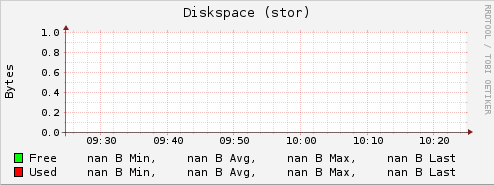

papageorgi
Jul 16, 2013
51
thank you very much i very much appreciate the help. i really was panicking and made it worse. since i couldn't import the pool i tried finding other ways to do so. i ended up via shell cloning two snapshots and holding two of them, then exporting the pool, then destroying it to try to import it. checking in freenas 8.3.1p2x64 it saw the pool as being destroyed but said it couldn't import because of the zfs 5000. back in freenas 9.1.0rc1x64 i see this, sorry to add another layer. i will truly not do anything else, nor will i loose hope. if and when i get this back up i will make a full backup as the first thing i do. from what i have read via the illumos link, it's not great.
i should note that the link brought up few things, which i was reading earlier but i don't see much on the tuneable side, did i do something wrong http://wiki.freenas.org/index.php/Settings
other than all of this, the pool has not changed so i'm not sure why it would say cannot open on the drives, and therefore result in insufficient replicas.

cyberjock
Inactive Account
Mar 25, 2012
19,525
The biggest thing people can do is go freaking out and touching things they shouldn't... sadly, I've lost alot of hope. I don't have any good ideas at the moment. :/
The "insufficient replicas" means that your 5 disk RAIDZ1 doesn't have at least 4 disks in the system and being properly found by ZFS. In your case, none of the 10 disks in either vdev have a zfs partition that is valid. This is probably because you destroyed the zpool, but I'm not sure. Generally you only destroy a zpool because you plan to repurpose the drive or something. I've never seen someone try to restore a destroyed zpool, but its supposed to be possible in some circumstances.
papageorgi
Jul 16, 2013
51
i will fight through this, it's too important not to. as always you and delphij have been so great. i still have hope. i read that when you "destroy" a pool it does not do much and that it worded to strongly but that when you "create" a zpool it's more destructive to the underlying data that is/was there. what is strangest most of all is that it shows that each disk is unavailable and can't open them but in 8.3.1 they're online (just that it's the newer 5000 zfs). it just doesn't make sense...yet.
cyberjock
Inactive Account
Mar 25, 2012
19,525
Did you try the tunable delphij mentioned earlier in this thread?

after adding the tunable the system booted to this: "This is a FreeNAS data disk and con not boot system. System halted." right now i'm re-downloading a fresh copy of FreeNAS-9.1.0-RC1-x64.img.xz, will burn it to the usb and start with it clean and just that tuneable to see if it persists or if it was a conflict of some sort.
update: strangely i'm having trouble booting to usb drives, checked bios settings and now it's good, trying fix... "GRUB loading, please wait... Error 17" looks like i've found the issue it was not imaged to the root of the usb drive... so i did the first line instead of the second at first. sorry i'm still a noob.
sudo xzcat /home/smurfy/Downloads/FreeNAS-9.1.0-RC1-x64.img.xz |dd of=/dev/sdb1 bs=64k
sudo xzcat /home/smurfy/Downloads/FreeNAS-9.1.0-RC1-x64.img.xz |dd of=/dev/sdb bs=64k
update 2: i've not had luck with those commands and the tuneable. i'm able to boot, see all disks, but not access them.
[smurfy@nas] /# zpool import -D -R /mnt stor
cannot import 'stor': no such pool or dataset
Destroy and re-create the pool from
a backup source.
   pool: stor
  state: UNAVAIL (DESTROYED)
 status: One or more devices are missing from the system.
 action: The pool cannot be imported. Attach the missing
devices and try again.
   see: http://illumos.org/msg/ZFS-8000-3C
 config:
stor                      UNAVAIL  insufficient replicas
 raidz1-0                UNAVAIL  insufficient replicas
   16752418983724484862  UNAVAIL  cannot open
   16923247324607746236  UNAVAIL  cannot open
   10063454983377925543  UNAVAIL  cannot open
   800970979980896464    UNAVAIL  cannot open
   11402190904943199729  UNAVAIL  cannot open
 raidz1-1                UNAVAIL  insufficient replicas
   13898617183391027350  UNAVAIL  cannot open
   10638658567095667509  UNAVAIL  cannot open
   10179731959774134998  UNAVAIL  cannot open
   18380244200663678529  UNAVAIL  cannot open
   14569402982510951241  UNAVAIL  cannot open
