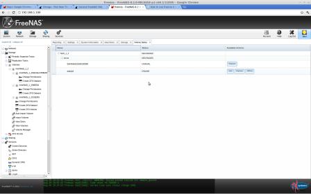

So I updated via the GUI to v8.2 last night. It all looked to have gone well. But then I noticed the alert was yellow so I clicked on the alert and the message is
"WARNING: The volume NAS_1_2 (ZFS) status is UNKNOWN: One or more devices could not be opened. Sufficient replicas exist for the pool to continue functioning in a degraded state.Attach the missing device and online it using 'zpool online'."
My system is two 1TB drives configured to mirror each other, they run inside a VM on a Linux Mint workstation. They have ran for months quite happily until now...
Rather than panic (which I am on the edge of) I browsed around the GUI to see what information I could gather on the problem.
The volume status is listed as follows
This would say to me that ada2p2 is working fine and the problem is with the other disk. I struggle to believe the coincidence of it failing during the upgrade but i'll run with the theory for now.
