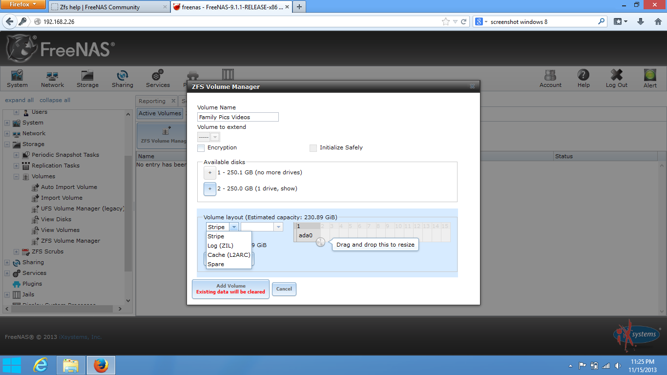

I am trying to setup my freenas and I have at the moment 2 drives in the box and going to add more in the next month or so. I am running freenas 9.1.1 and want to run them in a mirror ( raid 1 ) but when I go to add new zfs volume it dosn't give me the option to select mirror or raid 1, both drives are plugged in and the freenas gui sees them both. Is there something that I am doing wrong or do I have to use an older version of freenas to get this option. Please Help.

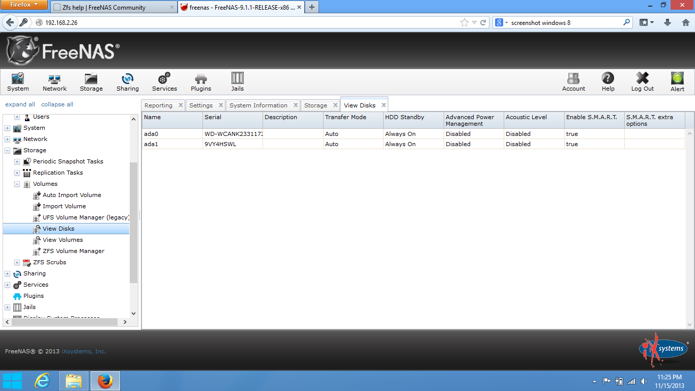

louiecola2
Oct 14, 2013
12
here is a screenshot of drives and what my issue is

Dusan
Jan 29, 2013
1,165
Unfortunately the drive sizes are not same. One is 250.0GB, the other 250.1GB. FreeNAS 9.1.1 doesn't like this and won't allow you to create a mirror. The easiest workaround is to boot into FreeNAS 8.3.2 create the pool and then go back to 9.1.1.
