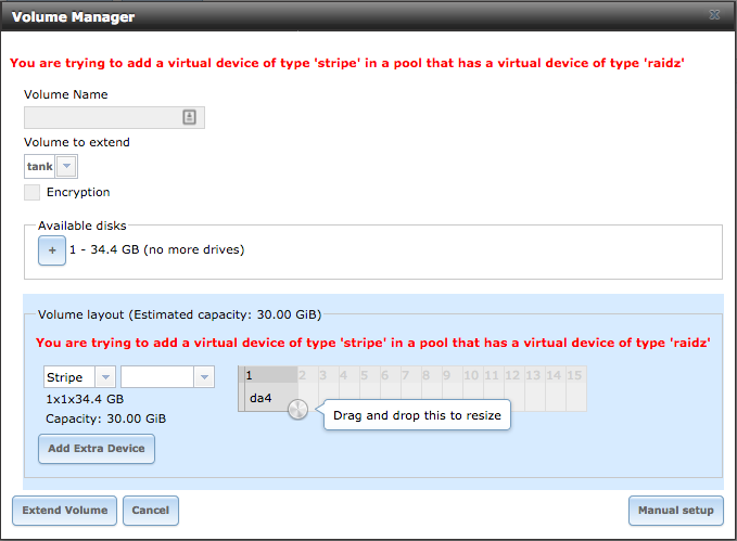

Hey, now that we're in a new thread -
Wouldn't there have been some warning in the GUI when the initial "four-drives-as-stripes" was added? Isn't it in all ports of ZFS where it will scream "mismatched replication level" if you add a vdev with a different level of failure tolerance?
15,504
Yes, there would have been. With bold red text saying what happens. And you need to switch into manual mode to make it happen at all. But nonetheless, it continues to happen.

The warning looks like this:
Edit: And it simply isn't possible to add the disk to the pool this way--you have to go to Manual Setup to do it.
