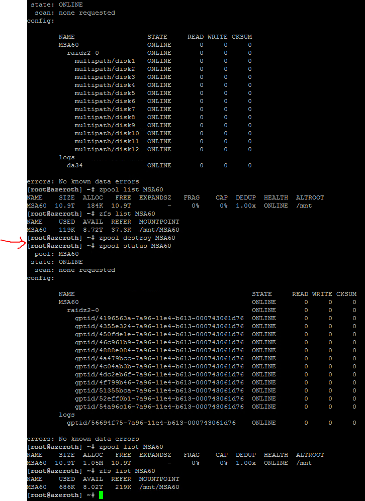

I have a 12 x 1TB JBOD. When I use the GUI to create a 4 x 3 raidz (4 sets of 3 disks in raidz), I end up with 10.9 available in zpool list, and 8.02TB available in zfs list. I also notice that when the GUI creates pool, it uses what I assume are gpart id's (gptid).

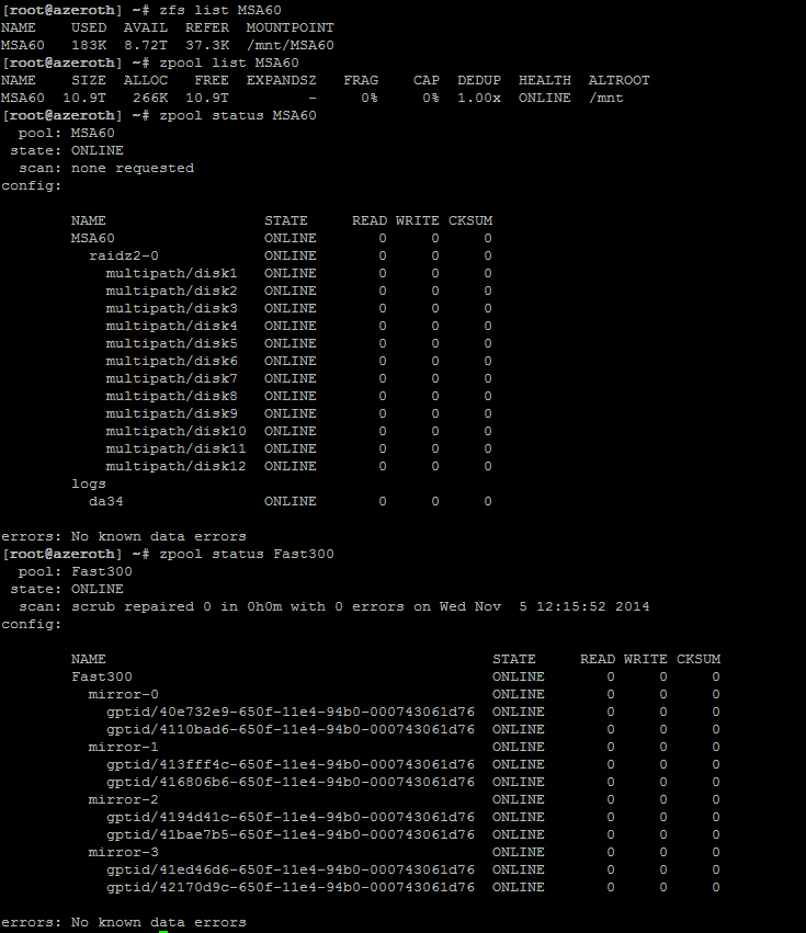

If I then wipe that and use zpool command to create the pool (below), I still get 10.9TB available in zpool list, but get 8.72TiB in zfs list.
zpool create -R /mnt MSA60 raidz2 multipath/disk1 multipath/disk2 multipath/disk3 multipath/disk4 multipath/disk5 multipath/disk6 multipath/disk7 multipath/disk8 multipath/disk9 multipath/disk10 multipath/disk11 multipath/disk12 log da34
Note: I have disabled the creation of swap partitions under advanced, so I assume they're not getting created, but I fear they are? I'm not great at disk geometry maths, but clearly the GUI is doing something extra that results in less space. Below is a screenshot of the difference is diskid's vs gptids (yes it is 2 different pools for example purposes).

It was getting late so apparently I confused the argument, but here is a screenshot denoting what I'm talking about...the first array was created with the zpool command as in the OP, and the 2nd status was created with the GUI (red arrow in pic). Both times raidz2. 700GB missing.

Here is what is created by the GUI setup...
[root@azeroth] ~# zpool history MSA60
History for 'MSA60':
2014-12-02.21:44:53 zpool create -o cachefile=/data/zfs/zpool.cache -o failmode=continue -o autoexpand=on -O compression=lz4 -O aclmode=passthrough -O aclinherit=passthrough -f -m /MSA60 -o altroot=/mnt MSA60 raidz2 /dev/gptid/4196563a-7a96-11e4-b613-000743061d76 /dev/gptid/4355e324-7a96-11e4-b613-000743061d76 /dev/gptid/450fde1e-7a96-11e4-b613-000743061d76 /dev/gptid/46c961b9-7a96-11e4-b613-000743061d76 /dev/gptid/4888e084-7a96-11e4-b613-000743061d76 /dev/gptid/4a479bcc-7a96-11e4-b613-000743061d76 /dev/gptid/4c04ab3b-7a96-11e4-b613-000743061d76 /dev/gptid/4dc2eb6f-7a96-11e4-b613-000743061d76 /dev/gptid/4f799b46-7a96-11e4-b613-000743061d76 /dev/gptid/51355bca-7a96-11e4-b613-000743061d76 /dev/gptid/52eff0b1-7a96-11e4-b613-000743061d76 /dev/gptid/54a96c16-7a96-11e4-b613-000743061d76 log /dev/gptid/56694f75-7a96-11e4-b613-000743061d76
2014-12-02.21:44:58 zfs inherit mountpoint MSA60
2014-12-02.21:44:58 zpool set cachefile=/data/zfs/zpool.cache MSA60
2014-12-02.23:30:42 zfs create -o casesensitivity=sensitive MSA60/NFS-VMs

Here is what is produced by the CLI
2014-12-03.00:03:51 zpool create -R /mnt MSA60 raidz2 multipath/disk1 multipath/disk2 multipath/disk3 multipath/disk4 multipath/disk5 multipath/disk6 multipath/disk7 multipath/disk8 multipath/disk9 multipath/disk10 multipath/disk11 multipath/disk12 log da34
2014-12-03.00:03:54 zpool export MSA60
2014-12-03.00:06:07 zpool import -f -R /mnt 7569196946154629811
2014-12-03.00:06:07 zfs inherit -r mountpoint MSA60
2014-12-03.00:06:07 zpool set cachefile=/data/zfs/zpool.cache MSA60
2014-12-03.00:06:07 zfs set aclmode=passthrough MSA60
2014-12-03.00:06:12 zfs set aclinherit=passthrough MSA60

Or try the CLI setup using partitions, the same way the GUI does it.
That's the only big thing that jumps out at me.
