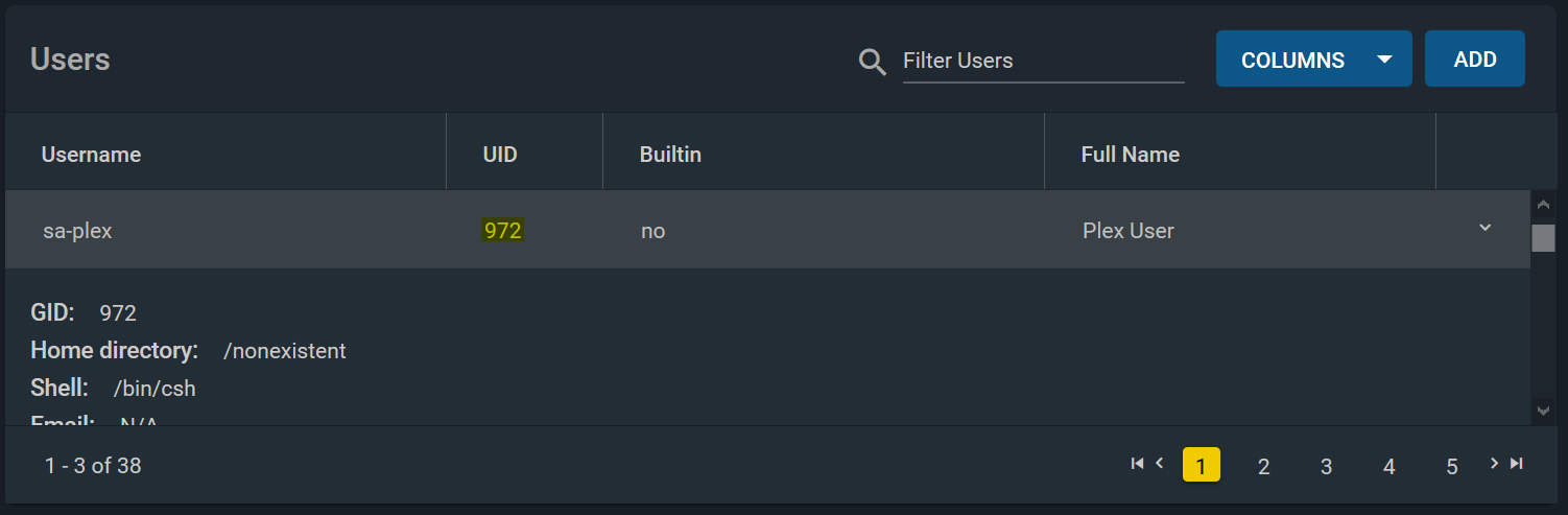

Plex user has UID 972 into the jail
I have created a service account user for Plex on Freenas system in order to set permission in a more human readable way. Please note that this was done before and worked well.

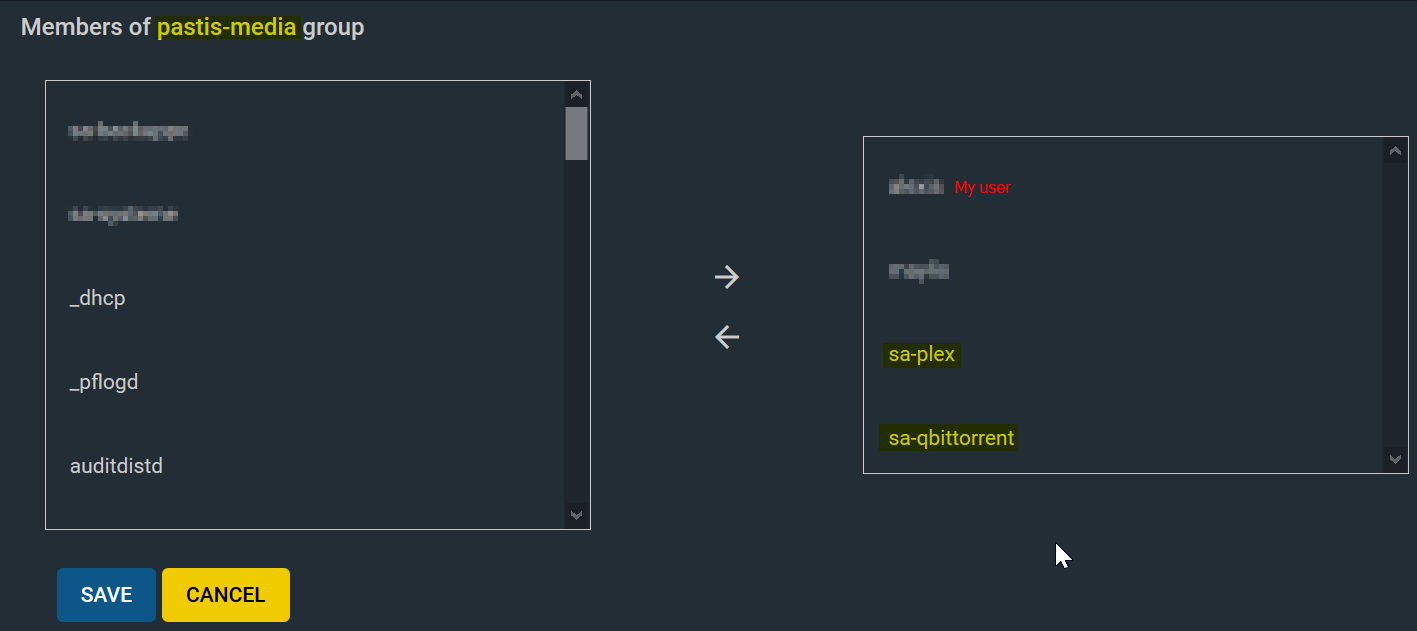

This is where the new settings begin. I've created a new group where I add all users with read/write permission needs on the Media dataset

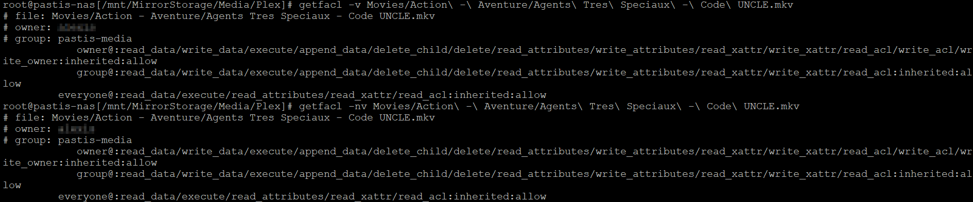

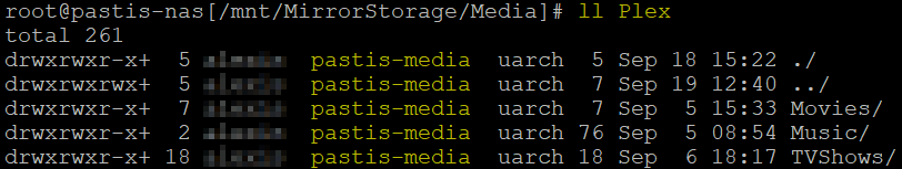

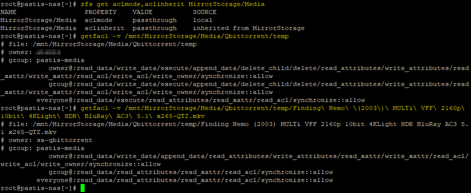

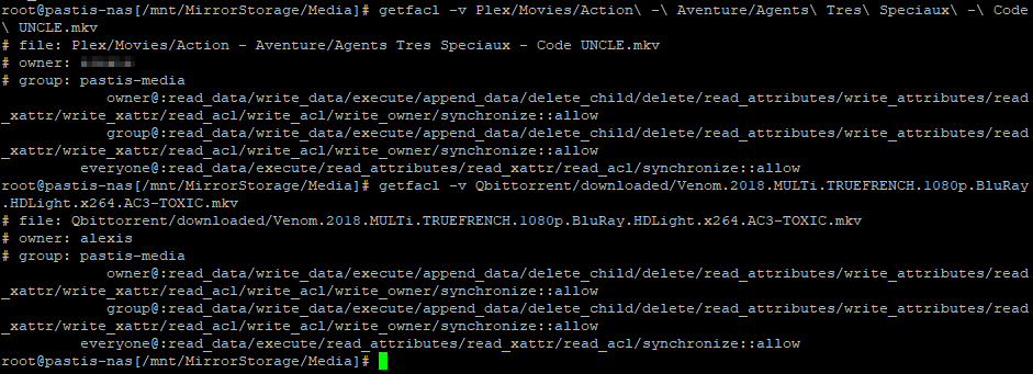

My first reaction is, are you using traditional permissions or ACLs on those directories. The output looks like you may be primarily using traditional permissions so let's check if ACLs exist and if so, are they overriding them. Either way lets see what the full permissions setup is like for the problem directories and files.
The following output should get us all the permissions info needed to check that. For each directory or file with a "problem" can you pick a sample file that's not doing as it should (say, /mnt/POOL/X/Y/FILE that plex can't delete or whatever it is), and post like this:
  1. The path /mnt/POOL/X/Y/FILE and anything that's not working for that directory or file
  2. Traditional permissions for each element of the path: the output of ls -lf <PATH> (lowercase "l") on each element of the path (eg, each of /mnt/POOL, /mnt/POOL/X, /mnt/POOL/X/Y and /mnt/POOL/X/Y/FILE)
  3. ACL permissions in both friendly and numeric form, for each element of the path: the output of getfacl -v <PATH> and getfacl -nv <PATH> on each of the same as above
  4. ZFS ACL settings on all datasets in the pool: the output of zfs get -o aclmode,aclinherit -r POOL (only needed once
Then see what we see.....
alexisr73
Oct 21, 2019
51
Here's what you asked ...
From my knowledge, everything seems correct ... This is a file that I didn't succeed to delete yesterday.
