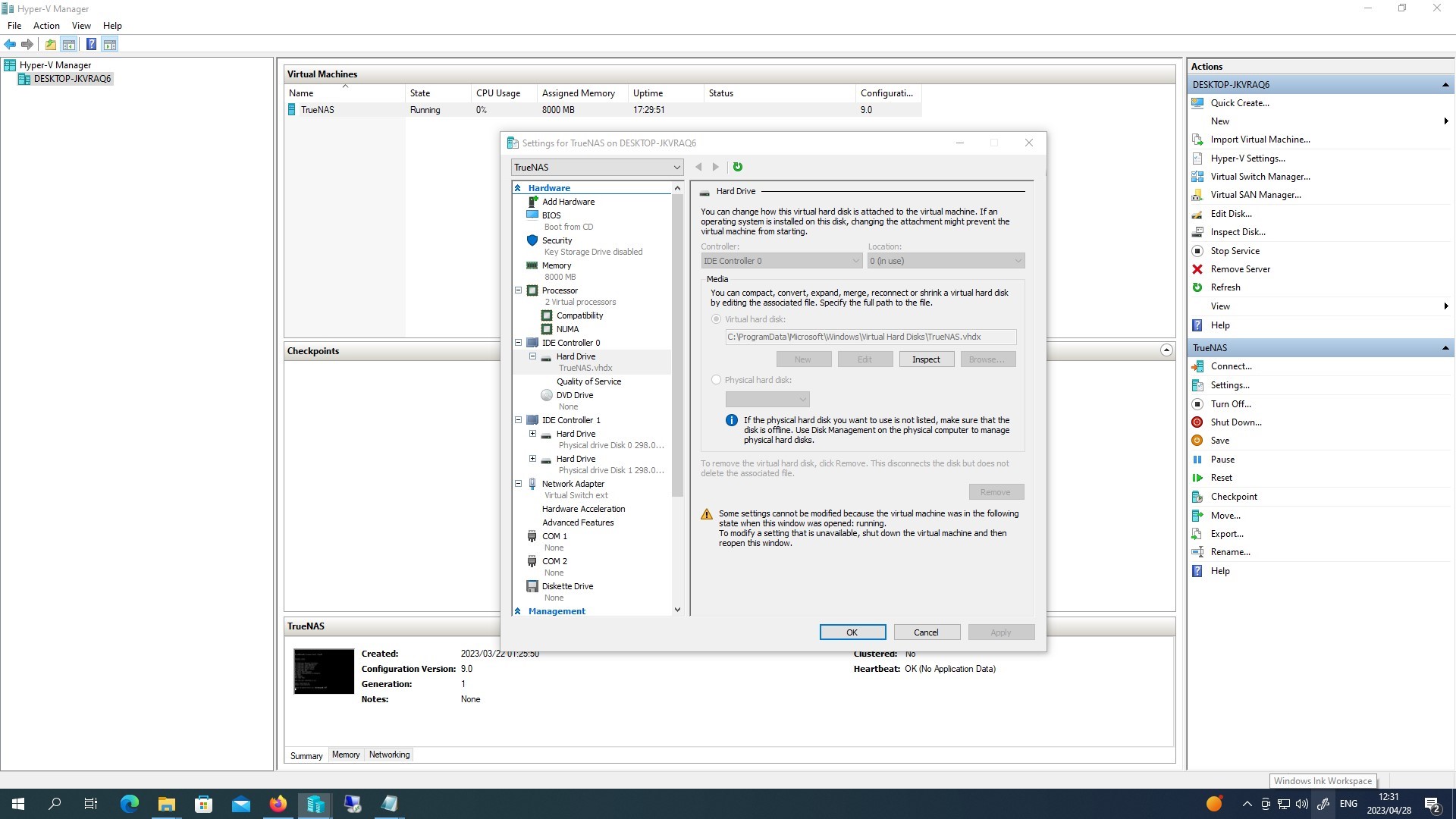

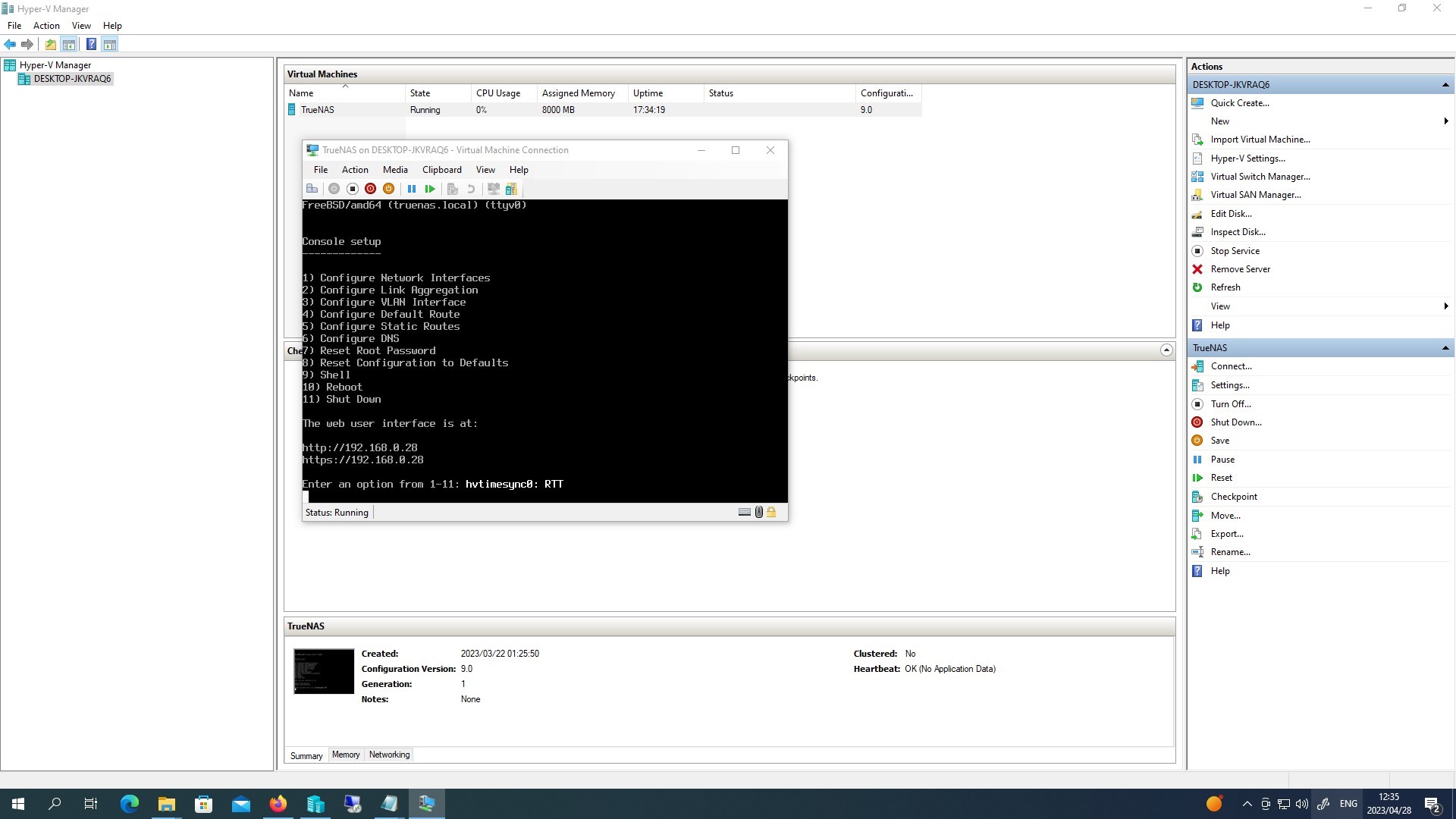

I installed truenas on a VM in Hyper-v Manager using an attached 16gb boot hdd plus 2x250gb used as raid1 disc.
I need to plan my install better and need better direction from what I assumed was correct.
Or maybe i am not far off and need a bit of tweaking.
Please let me know if this is the Correct or Incorrect discussion group.
My goal:
Using an older 5th gen intel PC.
Install a hyper-v VM on win10 pro.
Install TrueNAS core in VM and configure.

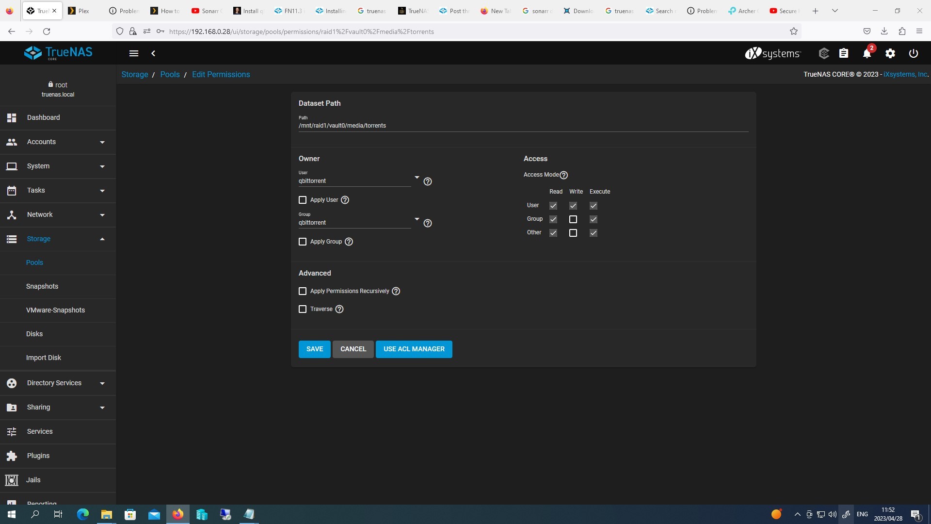

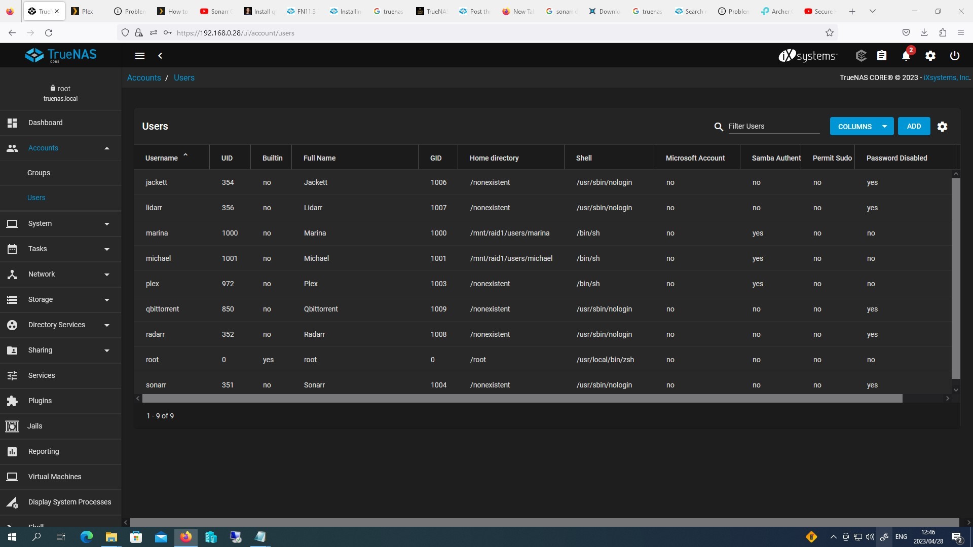

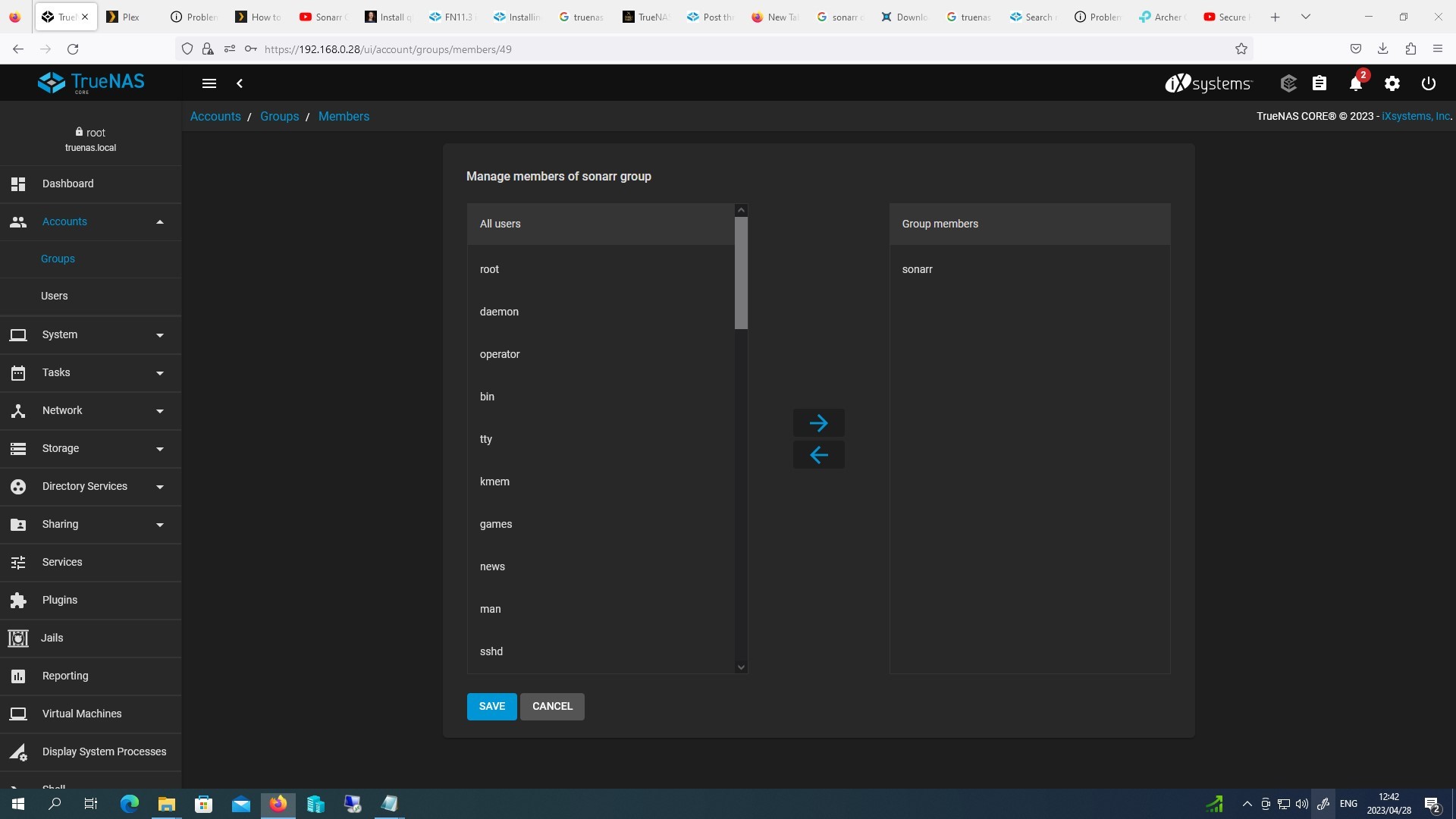

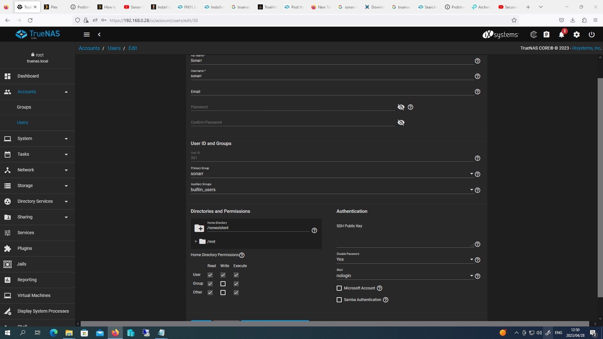

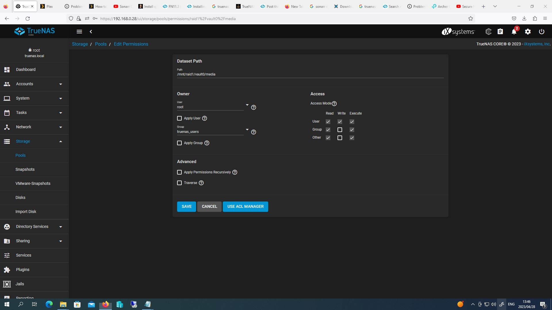

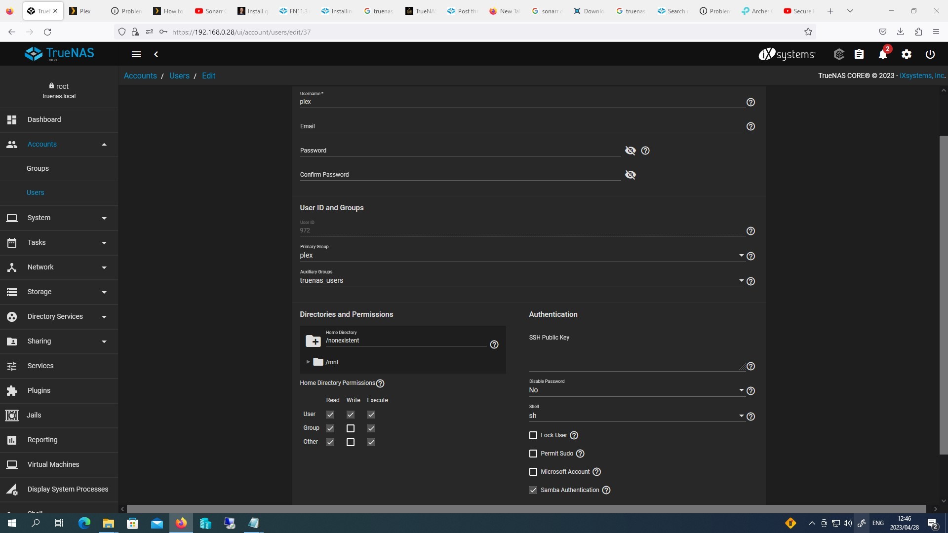

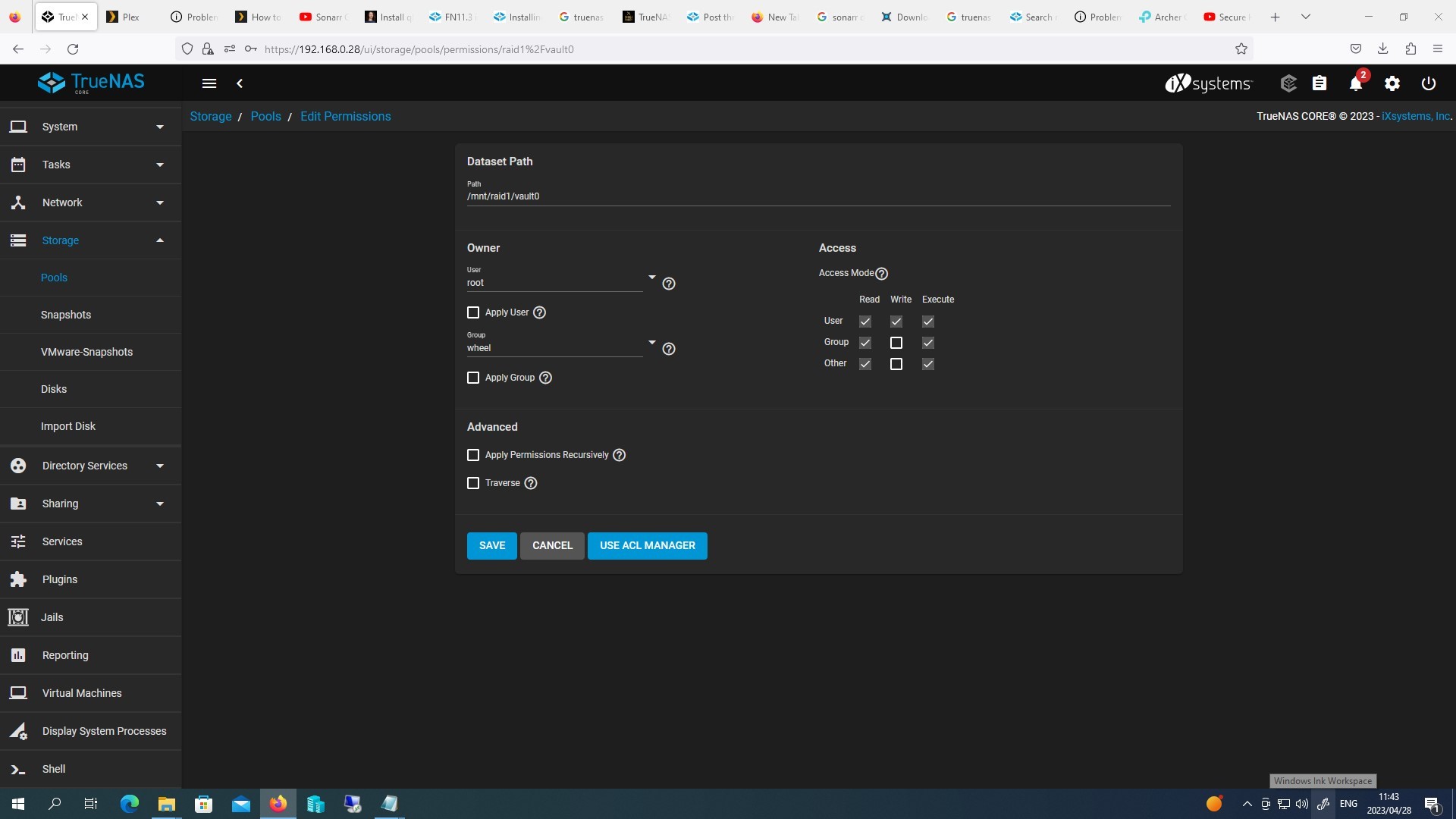

I battled to follow advice on pool permissions and user and groups.

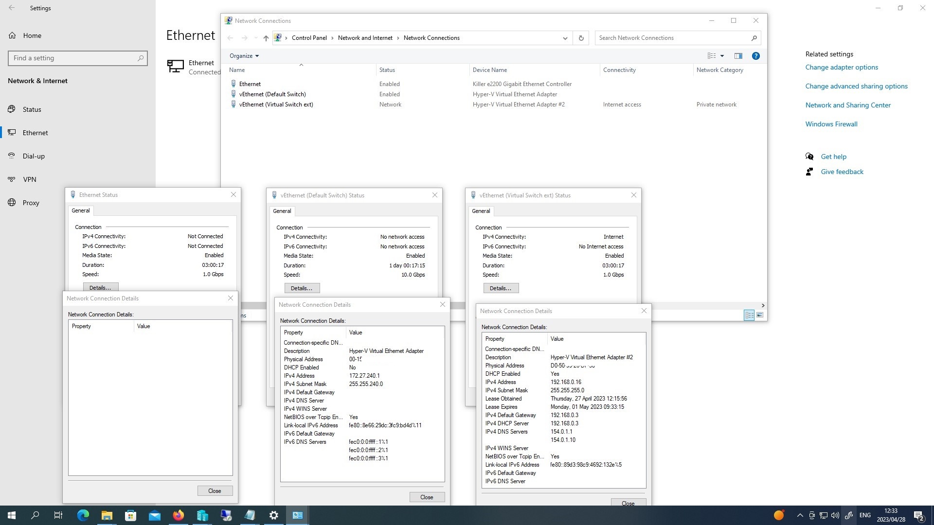

I dont understand explanations on vlans using a single network card.

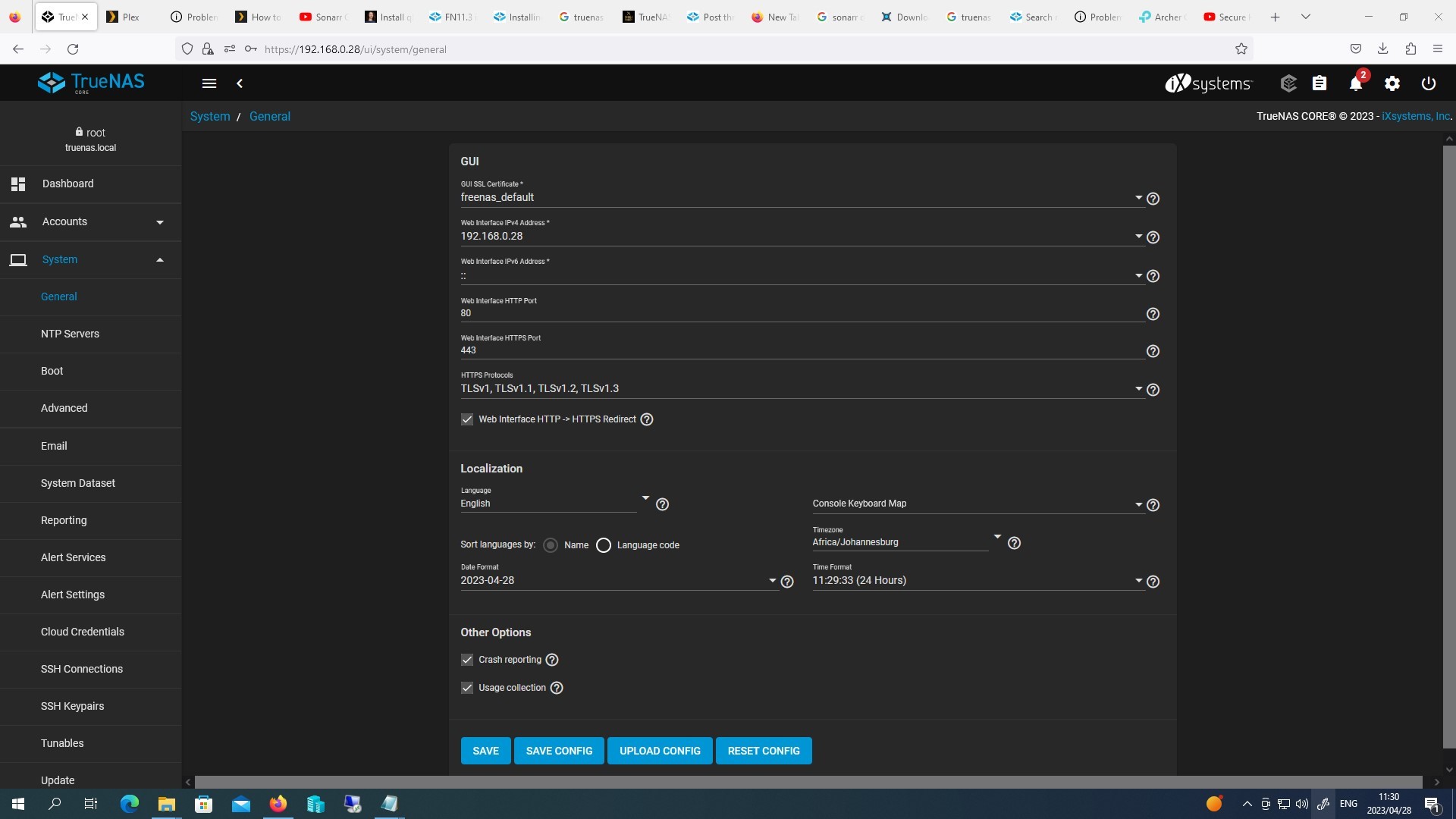

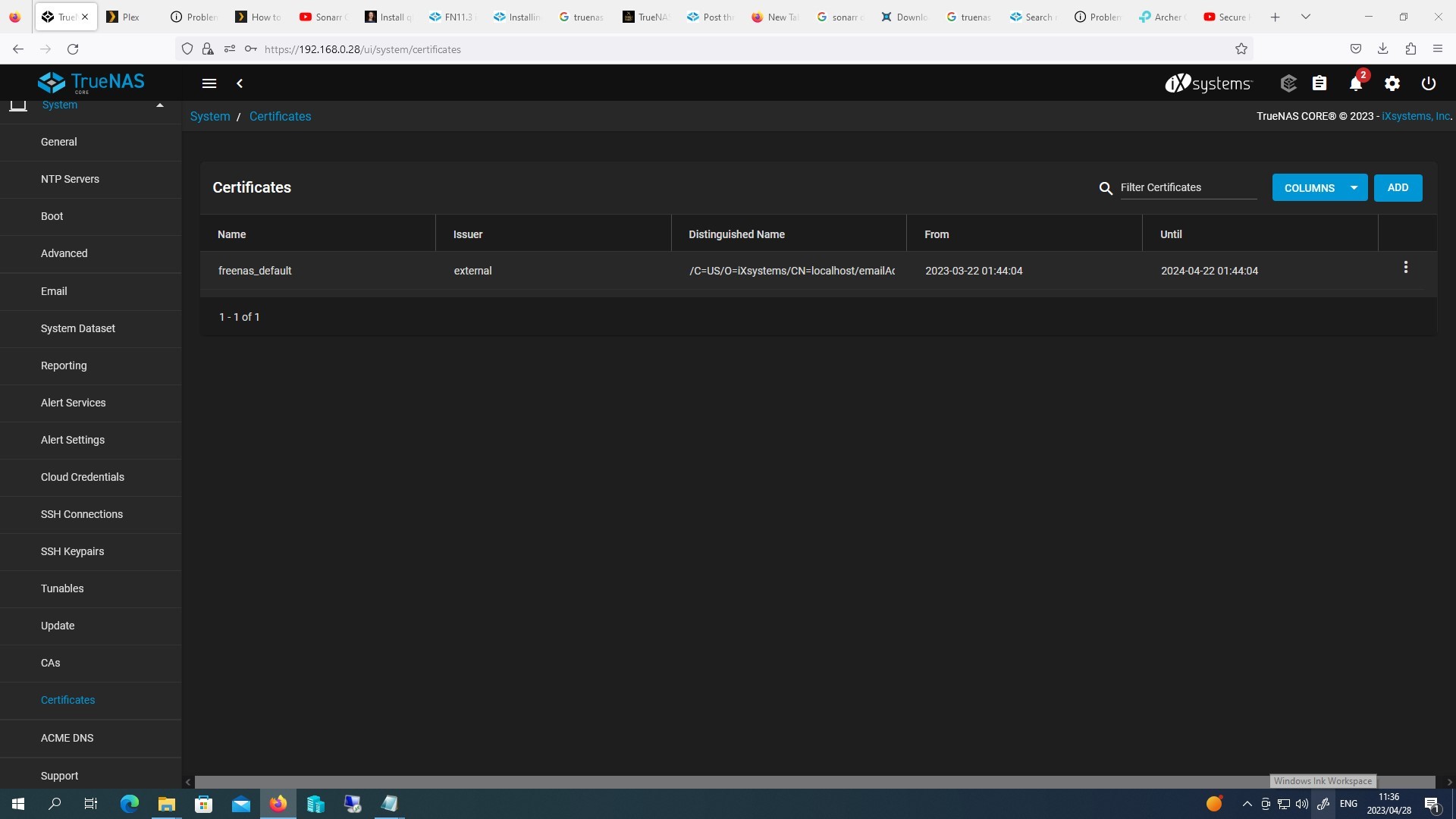

Truenas has a builtin ssl cert , where else can i use it?.
I think i would need to create self signed certificate for each plugin but not sure.
I have 1 network card and used it for all jails.
I cannot install Jails in dhcp / vnet which was weird so,
i had to un-tic dhcp, nat, vnet and berkeley packet filtering for all installed jails/plugins.
I struggled to grasp the user and group permissions but somehow managed to get users to access user data and a media folder on plex for uploading media data.

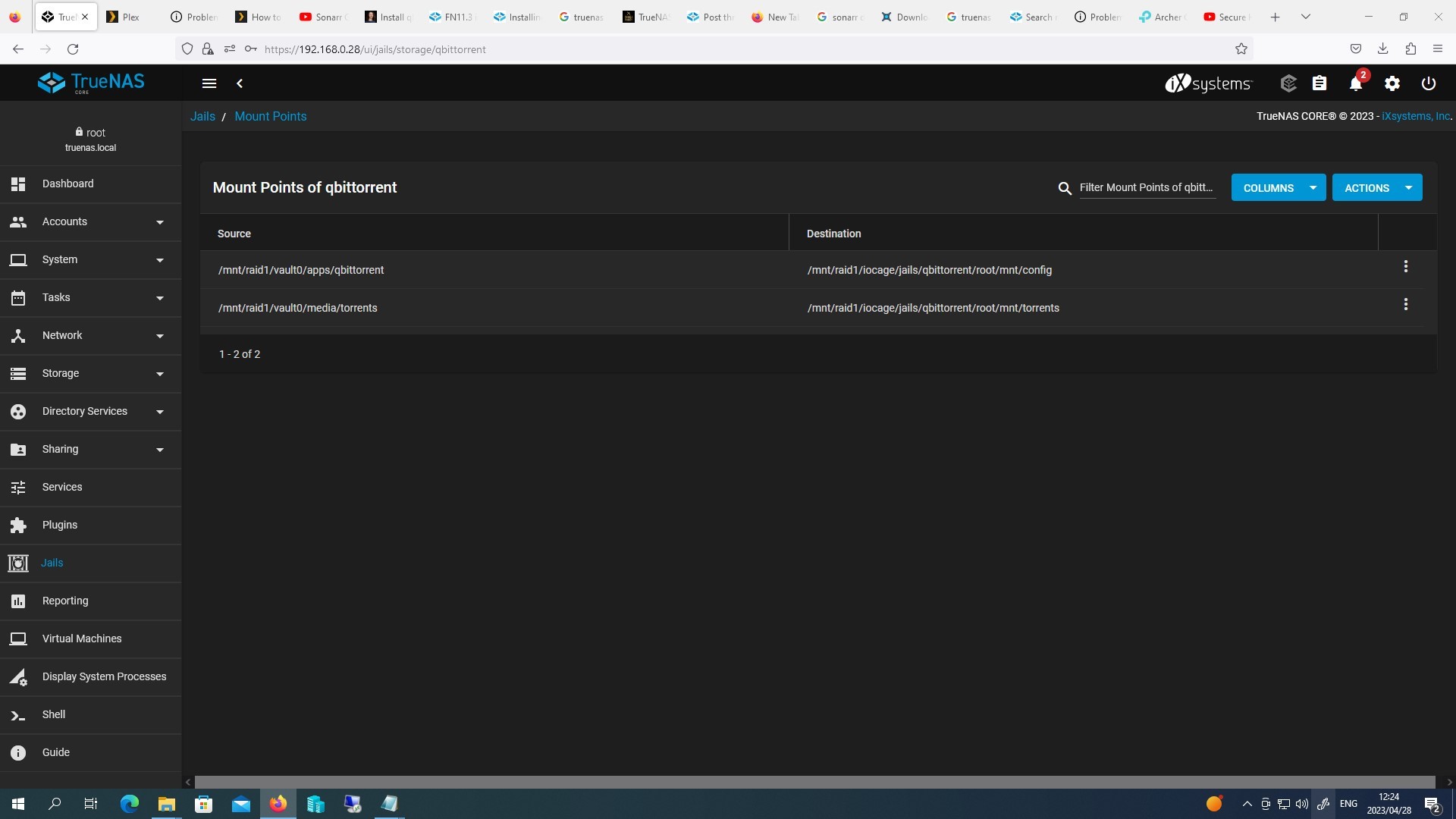

qbit port 8080 a big issue as jail is up but no web access, and i don't know how to fault find it.

I created the hyper-v vm on win10 pro computer.
I installed TrueNAS using dhcp.

I created local users and app users
I created a user group and app groups

Basic details of VM setup in hyper-v manager,

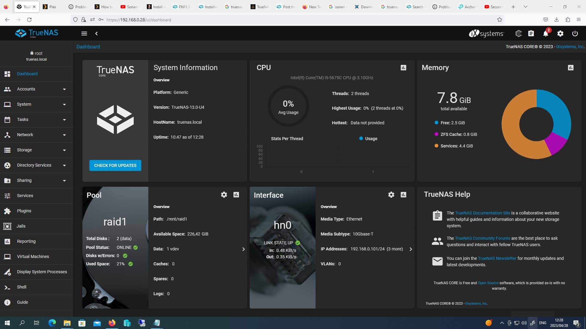

Console view of TrueNAS after basic install with DHCP network.
TrueNAS web portal Dashboard:

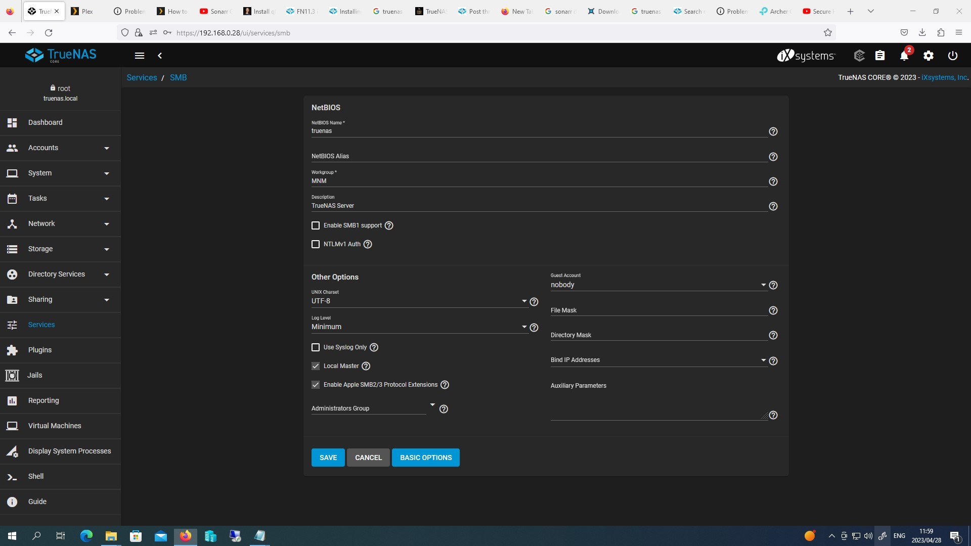

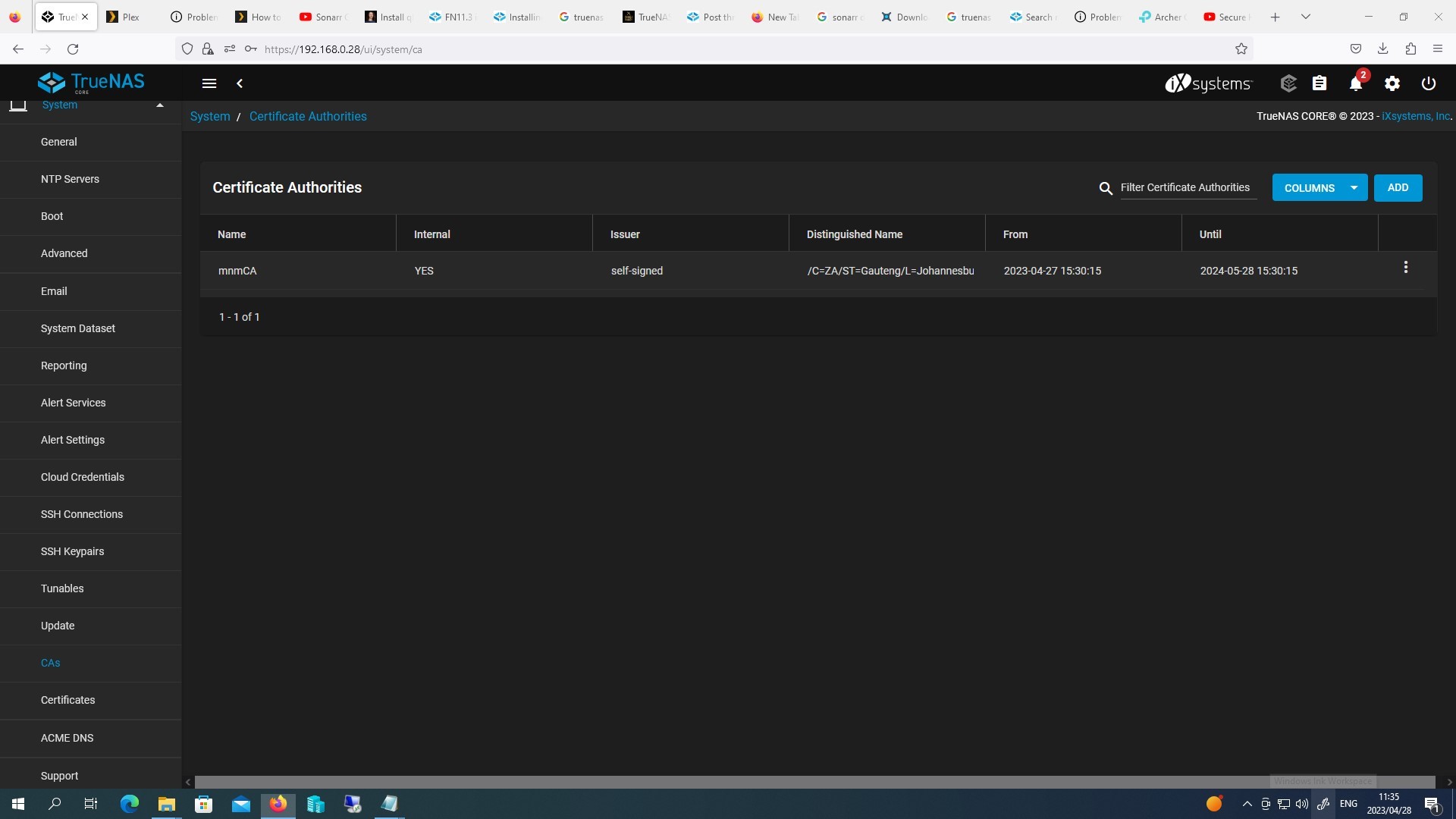

Certificate things:

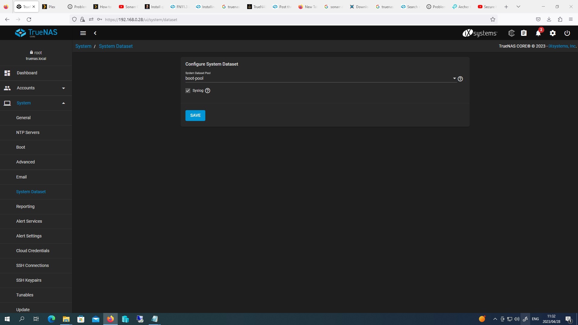

-Apparently this is useful set system data set to boot-pool. I'm not sure about this.

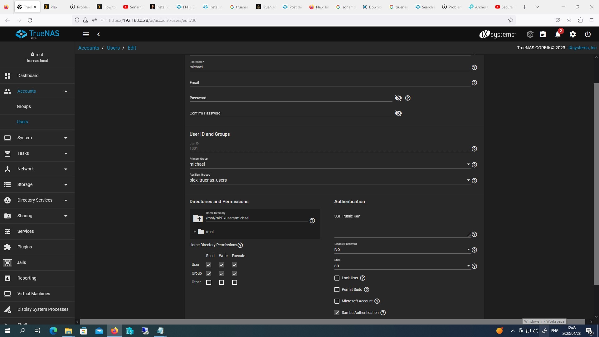

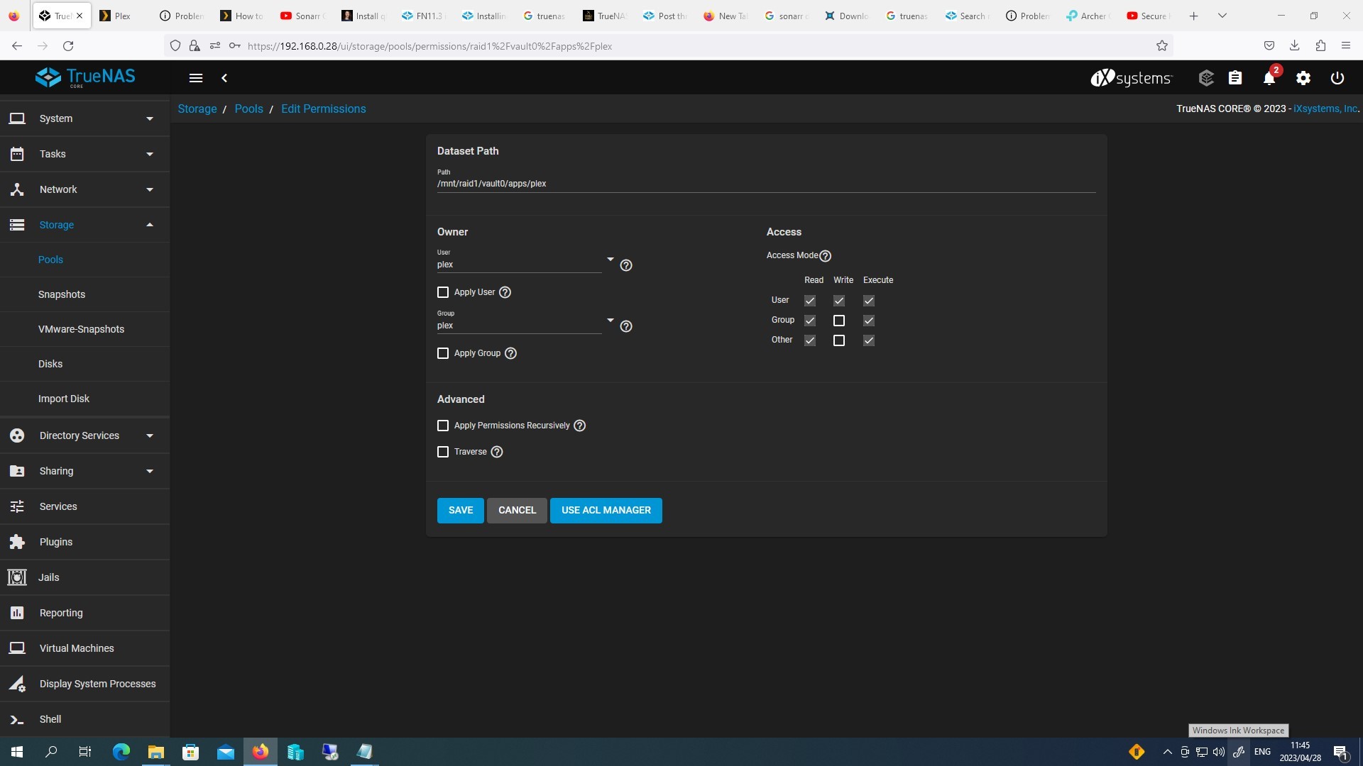

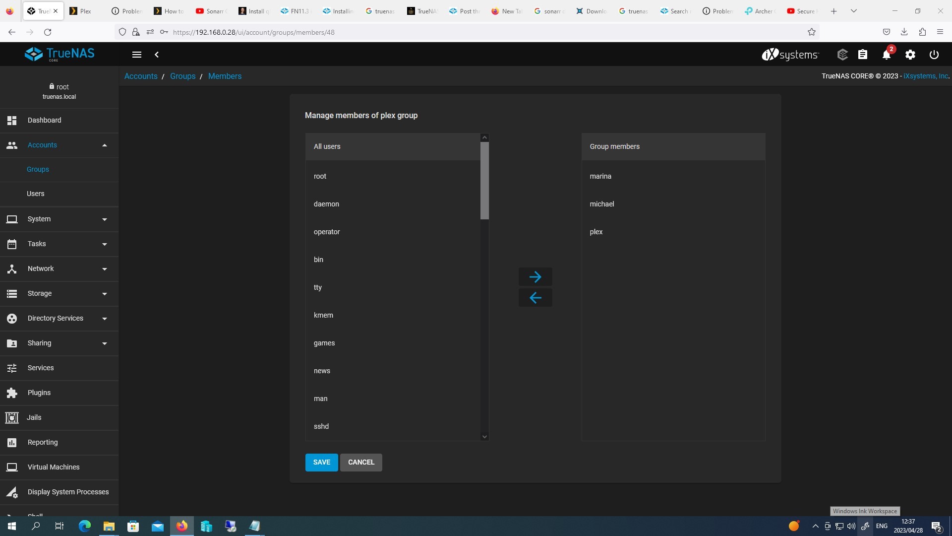

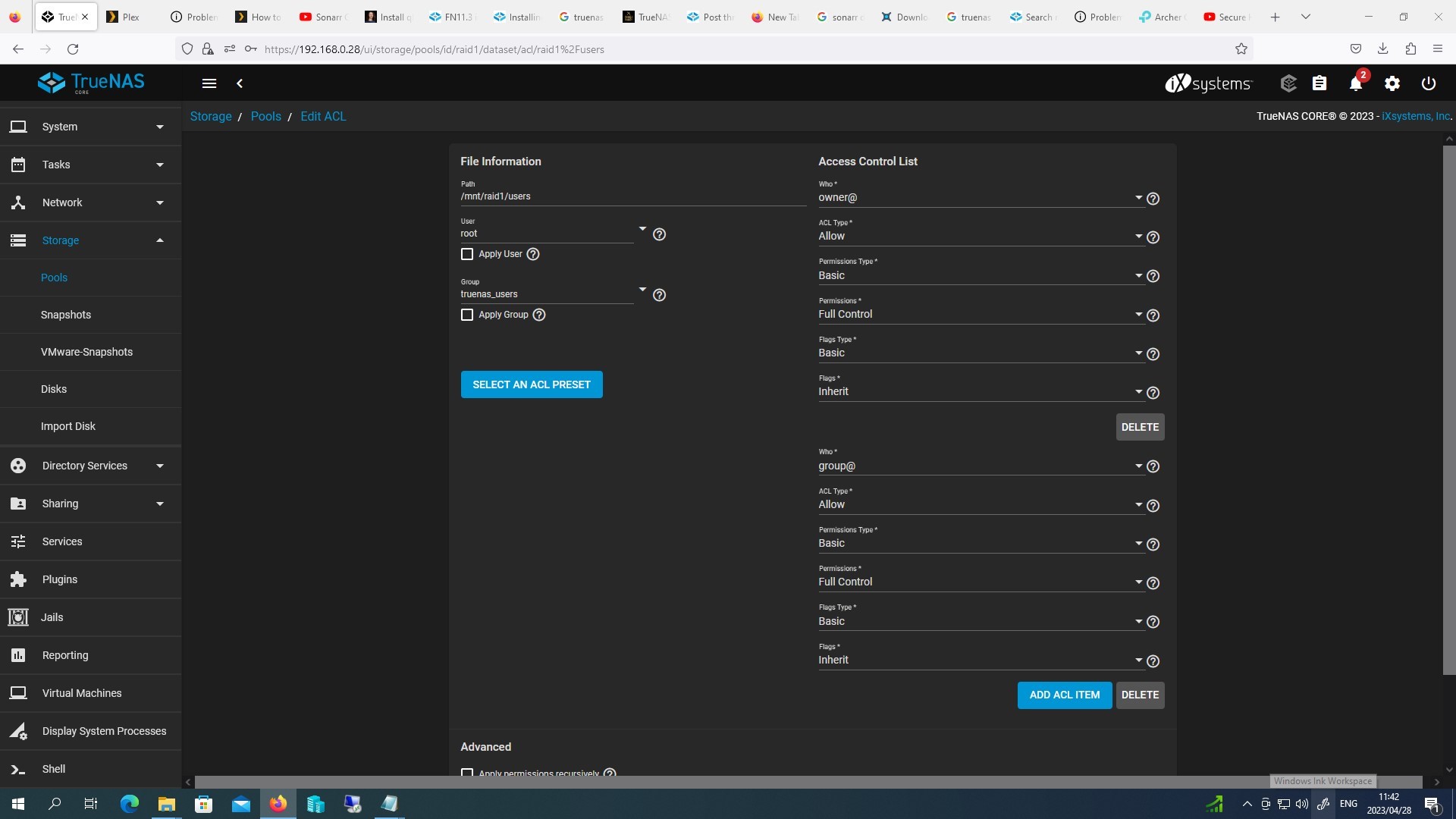

User setups:

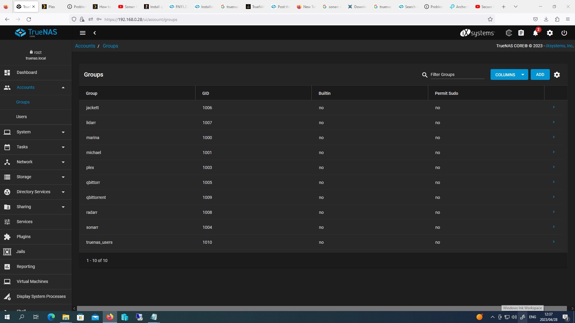

Group setups:

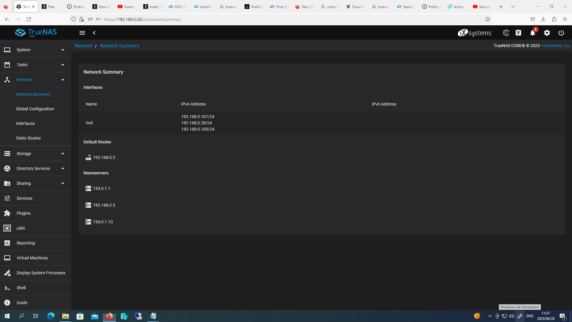

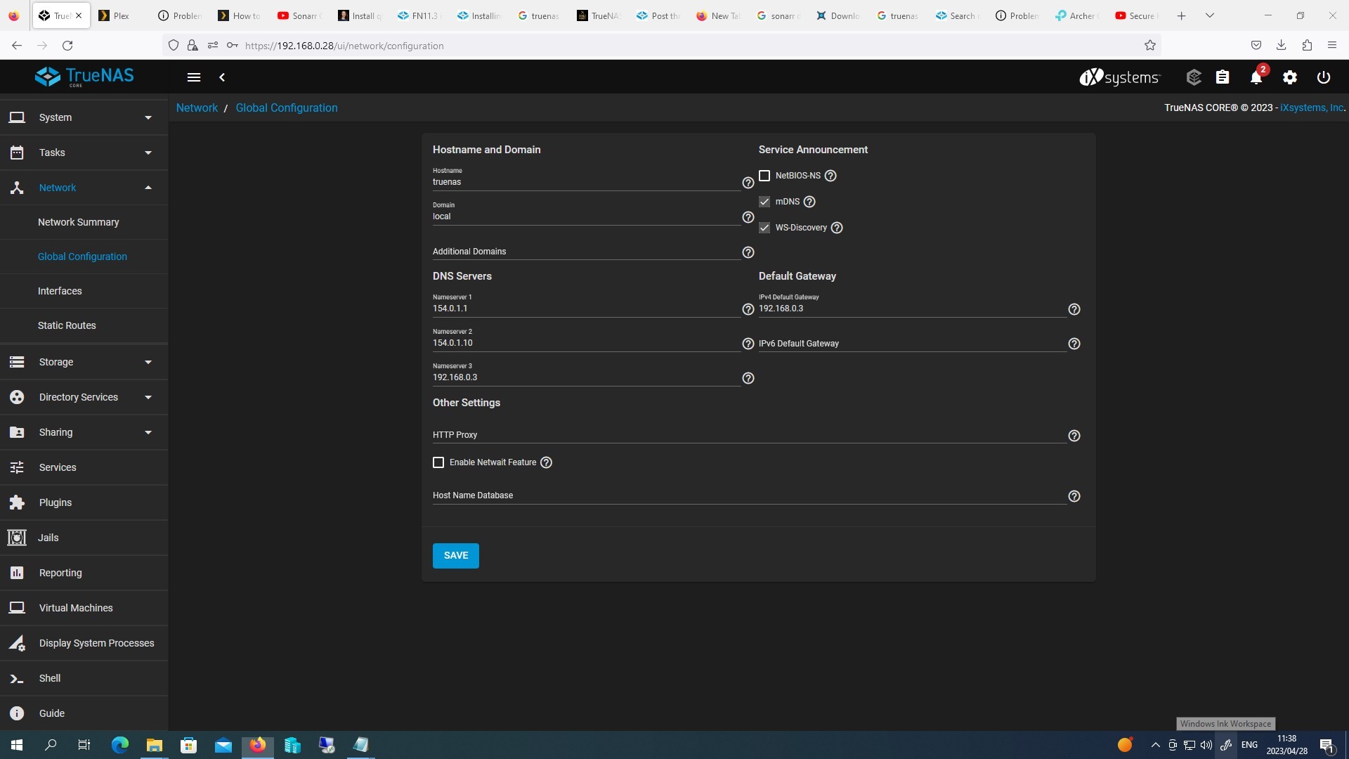

Network details:

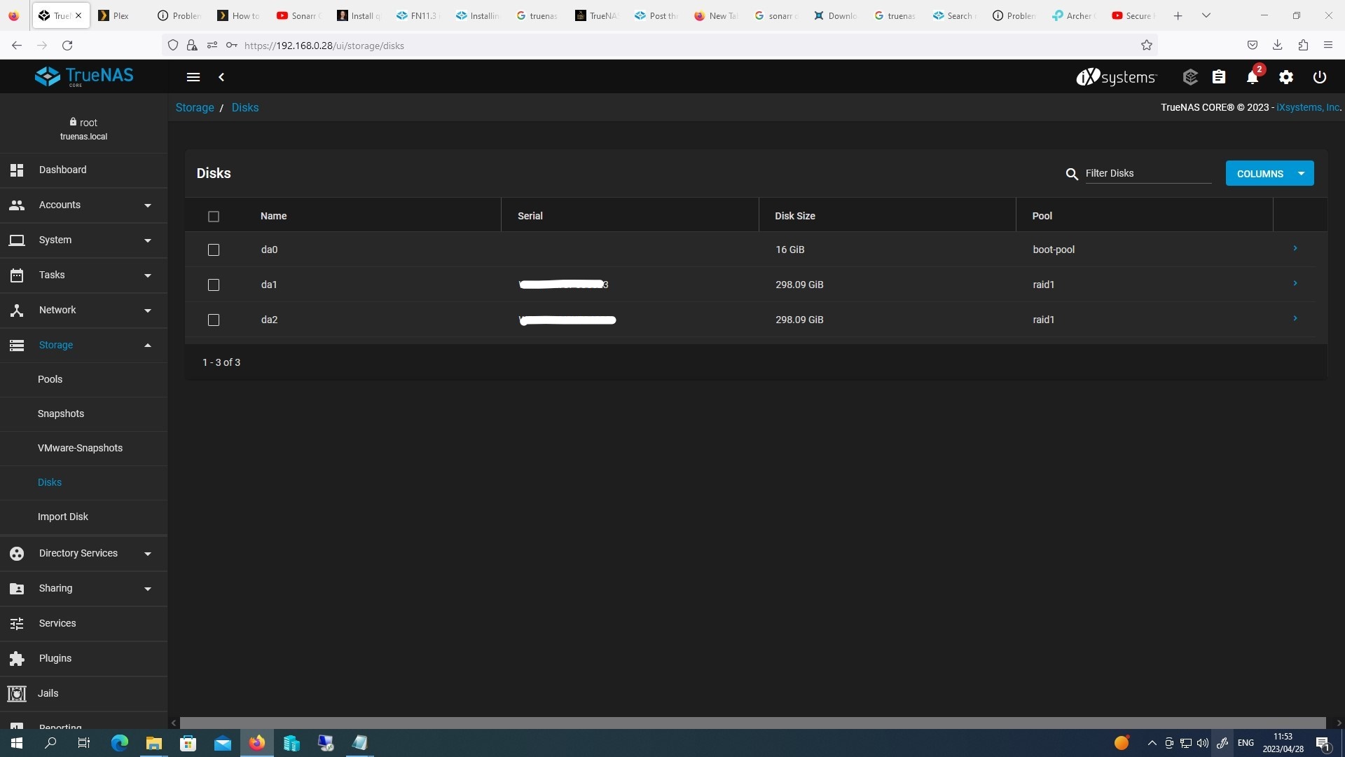

Disks in TrueNAS:

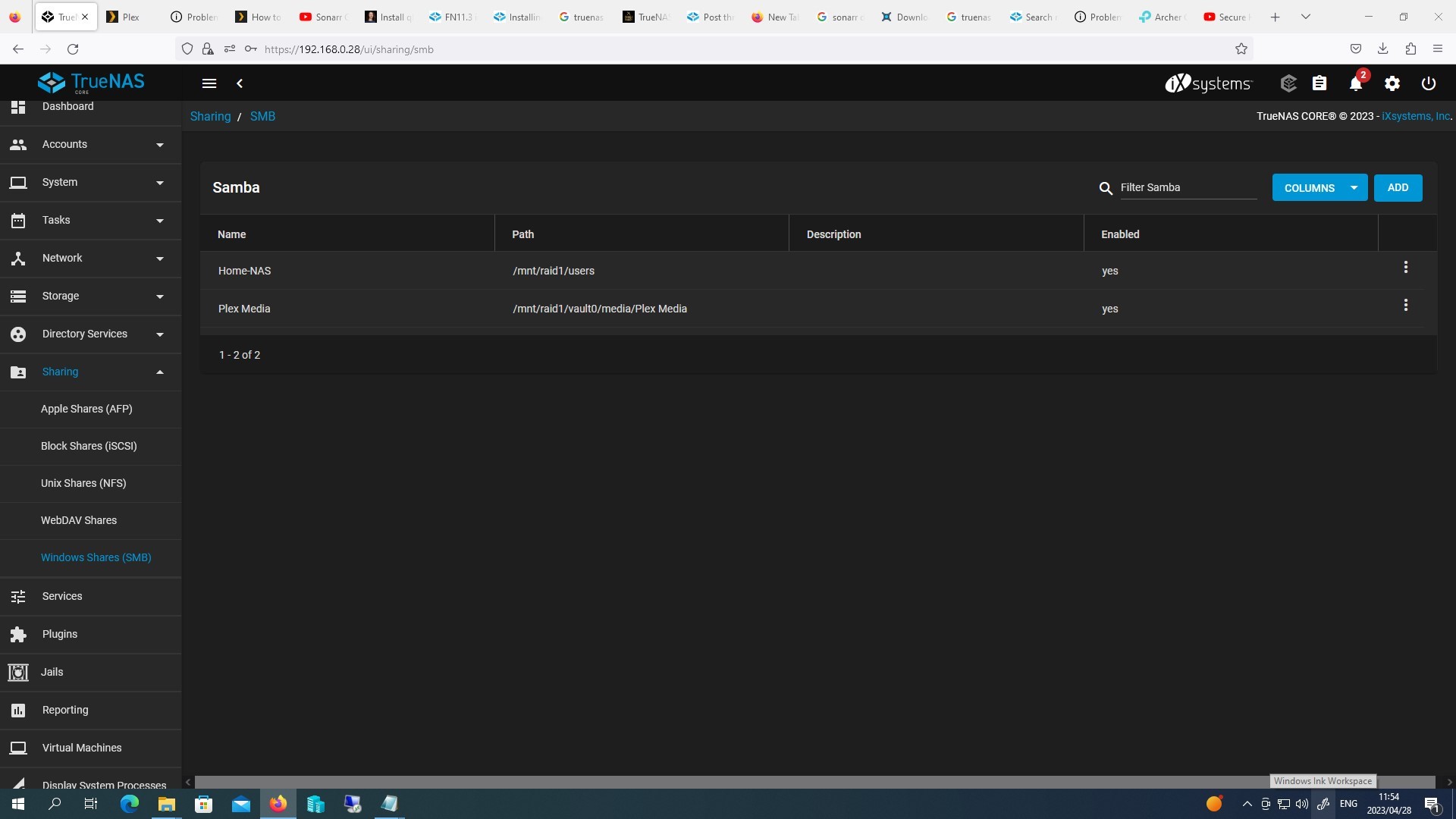

Services:

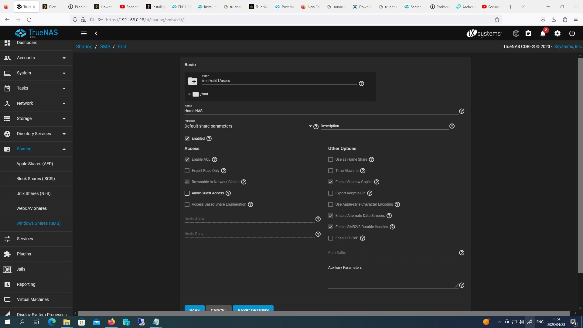

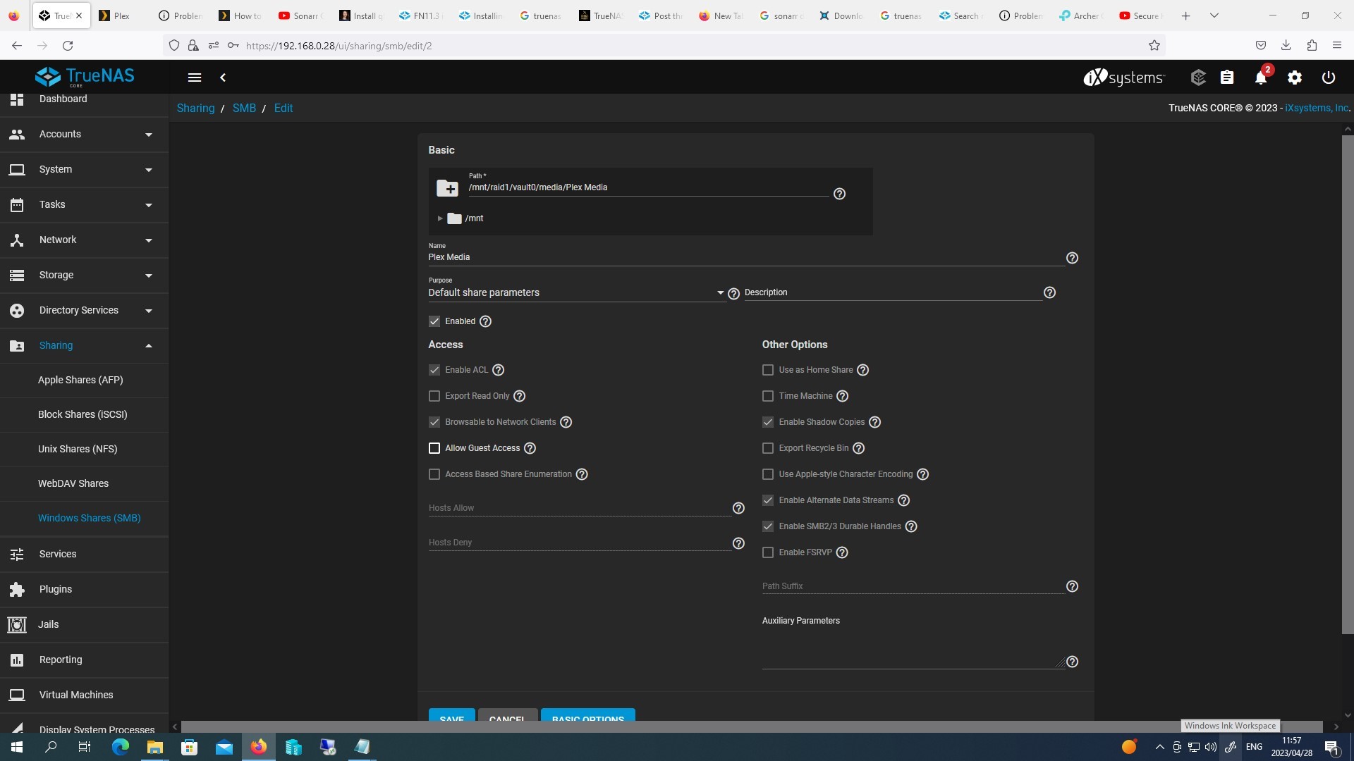

Sharing:

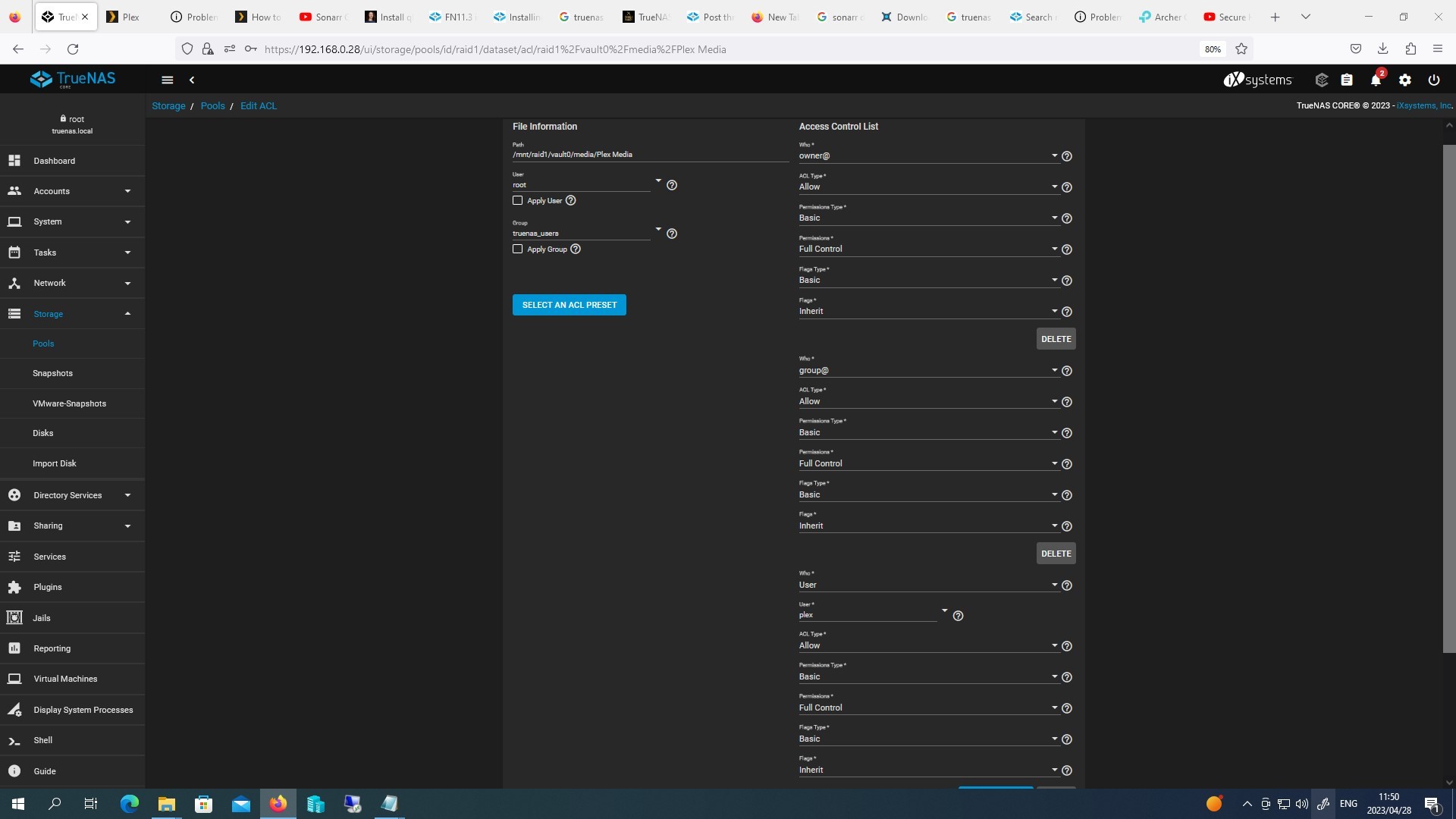

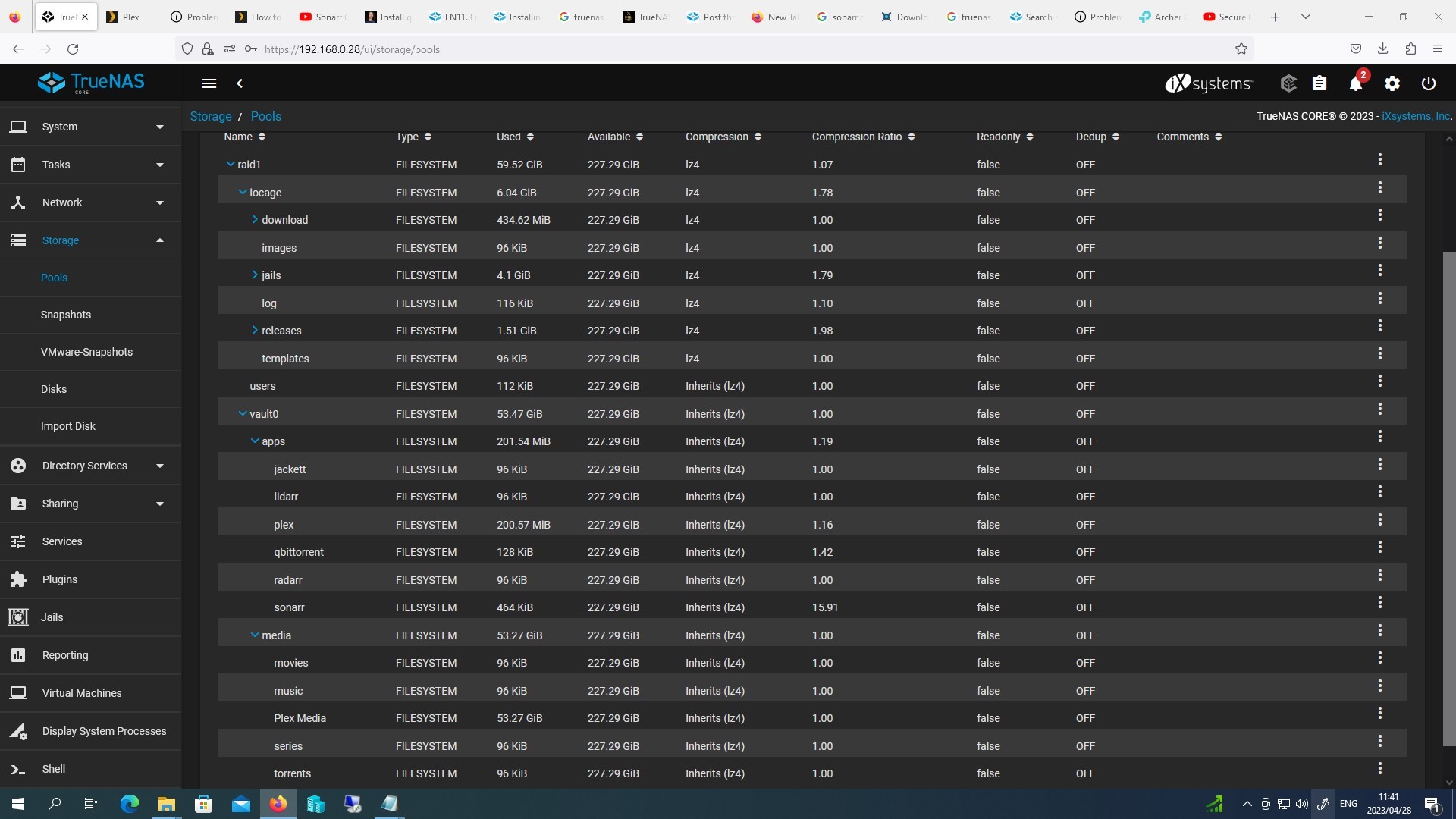

Pool and Datasets:
Dataset Users/ for user data:
Dataset Vault0/ for all Data related to apps and media:
Dataset Vault0/Apps for all app and configs only.
Datasets for individual App files like Plex / Sonarr / Qbit:
Example of plex:
Dataset Vault0/Media for all data relating to media used by plugins
Dataset Vault0/Media for all media categories used by plugins Radarr(movies)/ Solarr(Series)/ Lidarr(Music) :
I have not yet install Radarr and Lidarr but need the dataset for future use.
Example of Sonarr here:
Dataset Vault0/Media for user share and uploaded media, read-only by Plex.
Dataset Vault0/Media for all media categories used by plugins Qbittorrent(Torrents) :

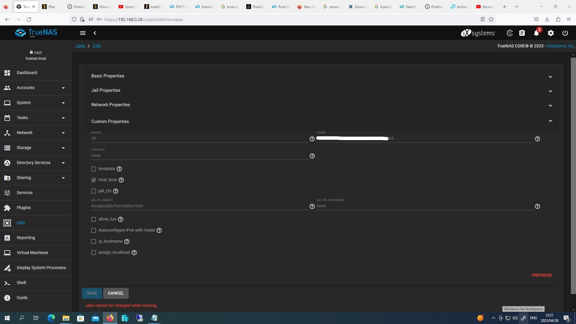

Plugins:
I ended up installing plugins first in PLEX GUI and then did the jails and mounts. I like seeing what is installed vs silent install in console.

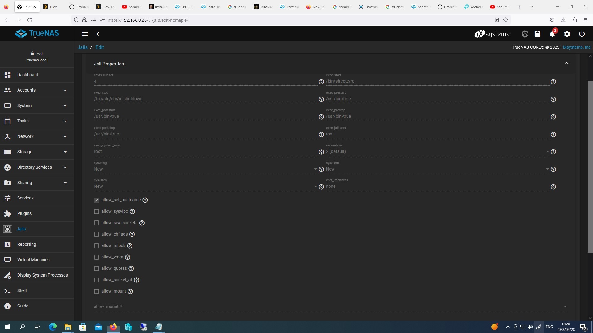

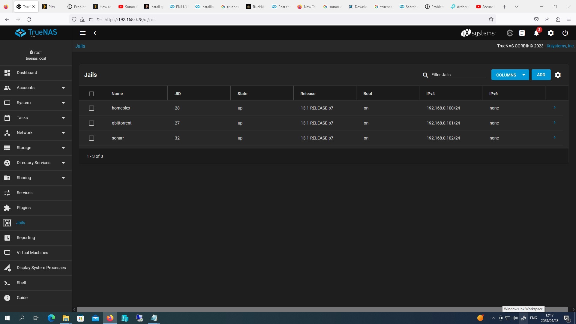

Jails list :
Jail covering Plex / Sonarr / Qbit :
Example for Plex here:

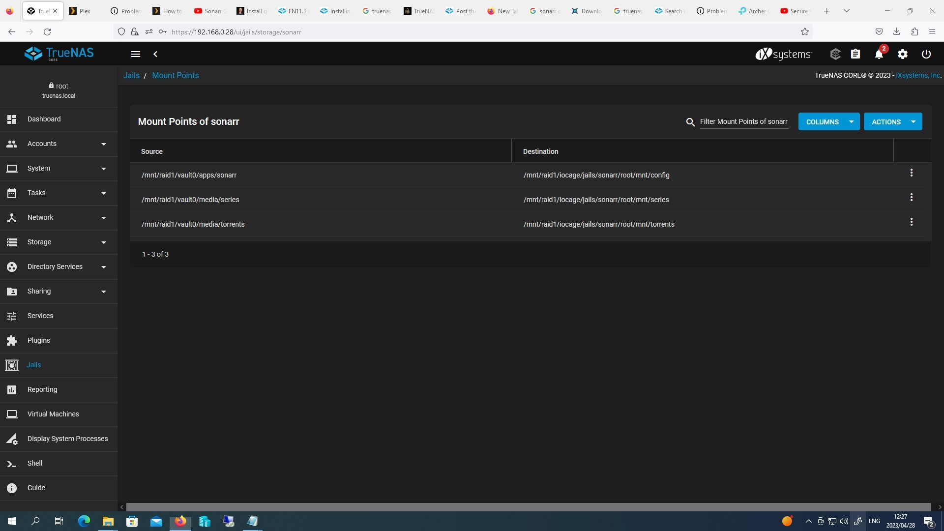

Jail Plex Mounting points:
Jail Sonarr Mounting points:
Jail Qbittorrent Mounting points:

1) Please review the virtualization guide, "Absolutely must virtualize TrueNAS" - a guide to not completely losing your data
1a) Please note that it explicitly says not to use Hyper-V for this
1b) Also note that it says you must use PCIe passthru of the controller for your disks, you have set up individual disks to be proxied, which is very dangerous
1c) Fortunately you appear to have scripted lots of your activities, which is good, I like that, except that the flip side of that coin is that this is mostly useful for when this charlie foxtrot implodes upon itself, which I (at least) consider an undesirable outcome.
