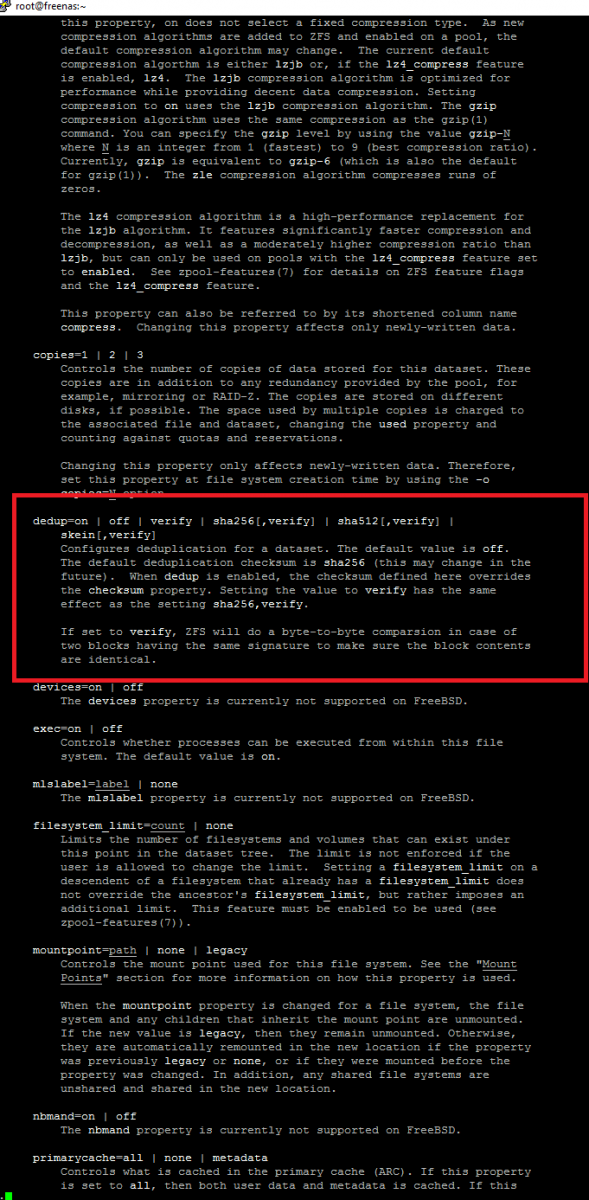

Edit: As the FN10 shell is not the pure unix-style anymore, I cannot create anything with zpool. I don't have a FN9.10 test-VM around, so I cannot confirm that.
Edit: Okey, just set up a FreeNAS 10 VM and ssh into the VM, then you'll get the clean-unix-style-machine-CLI ;)
In this case you can set up the zfs commands and here we go:
Just as simple as sleeping: man zfs
And you get all your answers. I have attached an image for better understanding.
So default when setting deduplication on "ON", SHA-256 is used for comparing the blocks. And this is good, as darkwarrior mentioned, Fletcher is not secure for this. When you set your pool on "VERIFY", also SHA-256 is used, but with the verify function a byte-by-byte comparison is made.
