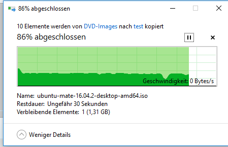

When I am copying data to a dataset when dedup is ON or VERIFY, the connection drops every minute, sometimes every 30 seconds, sometimes every 2 minutes. Depends on the data transferred. When the connection drops, I mean that NO read or write happen to that dataset at this specific moment, and Windows shows transferspeeds of 0kb/s instead of 100+MB/s. For 15-30 seconds this state is hold and after that time, the copying resumes (photo attached).

This is not a CPU or RAM problem, also I think the disks are not the bottleneck has normal transfers has always 100+MB/s so I assume it's the deduplication or the implementaion of this.
