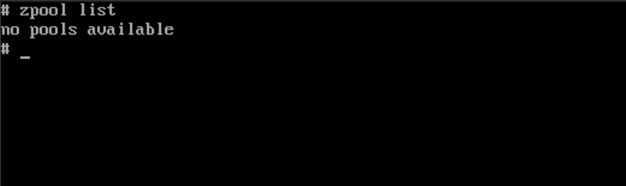

I'm trying to install TrueNAS Scale on an HP Microserver Gen8 with the following specs:
CPU: Xeon E3-1220L V2
RAM: 16 GB
Boot Disk: Samsung SSD 850 Evo 250Gb
Controller: B120 set into AHCI Legacy mode (tried also AHCI Mode)
Installation complete successfully without showing any error but once I reboot the Microserver I see GRUB but then system fall into Busybox initramfs shell and complaining that ZFS boot-pool doesn't exist.
From initramfs shell I have tried to issue `zpool list` but it doesn't show anything. So I have tried once again to install TrueNAS scale and once finish instead of rebooting, I went into the shell and run `zpool list` and also from the installer is not showing anything:
What I'm missing? Same configuration works fine when installing TrueNAS core
