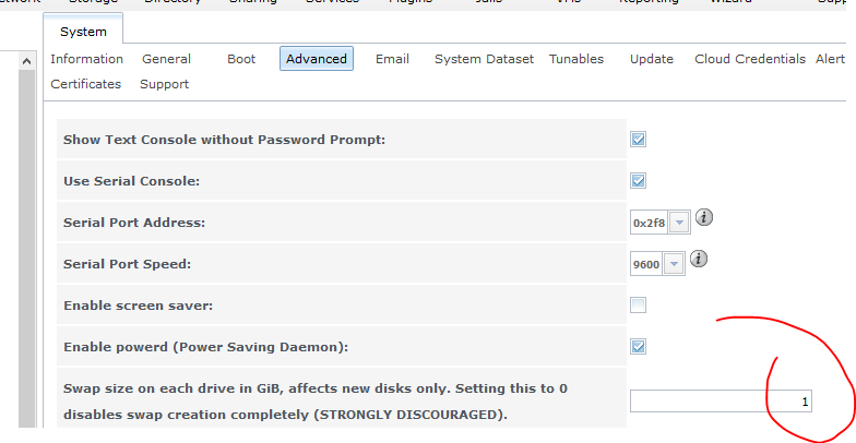

For some reason the Dell 310 in my signature is showing zero swap allocated. Any ideas why this is occurring?

Where do you see the issue? In the graphs? [ignore this question, i just noticed your graph].
Please do a gpart show <devicename>, for example gpart show ada0 and post the results in code tags.
If you are using FreeNAS 11.3-U3 on this server and you have swap, perhaps it's bug.

I posted earlier a screenshot of the swap graph which has been zero since install..i never really noticed until now..it is not causing an issue..just a bit weird.

ok it is an issue with the gui then..i'll post a bug report:
gpart show ada0
=>		40  5860533088  ada0  GPT  (2.7T)
		 40		  88		- free -  (44K)
		128	 4194304	 1  freebsd-swap  (2.0G)
	4194432  5856338688	 2  freebsd-zfs  (2.7T)
  5860533120		   8		- free -  (4.0K)
15,504
Not necessarily. Just because the disk has a swap partition, doesn't mean the system is using it (it should be, of course, but that doesn't prove that it is). What's the output of swapinfo and free?

Contents of /etc/fstab would be useful too.

swapinfo
Device		  1K-blocks	 Used	Avail Capacity
Free says command not found
 cat /etc/fstab
freenas-boot/grub	   /boot/grub	  zfs	 rw,noatime	  1	   0
fdescfs /dev/fd fdescfs rw	  0 0
