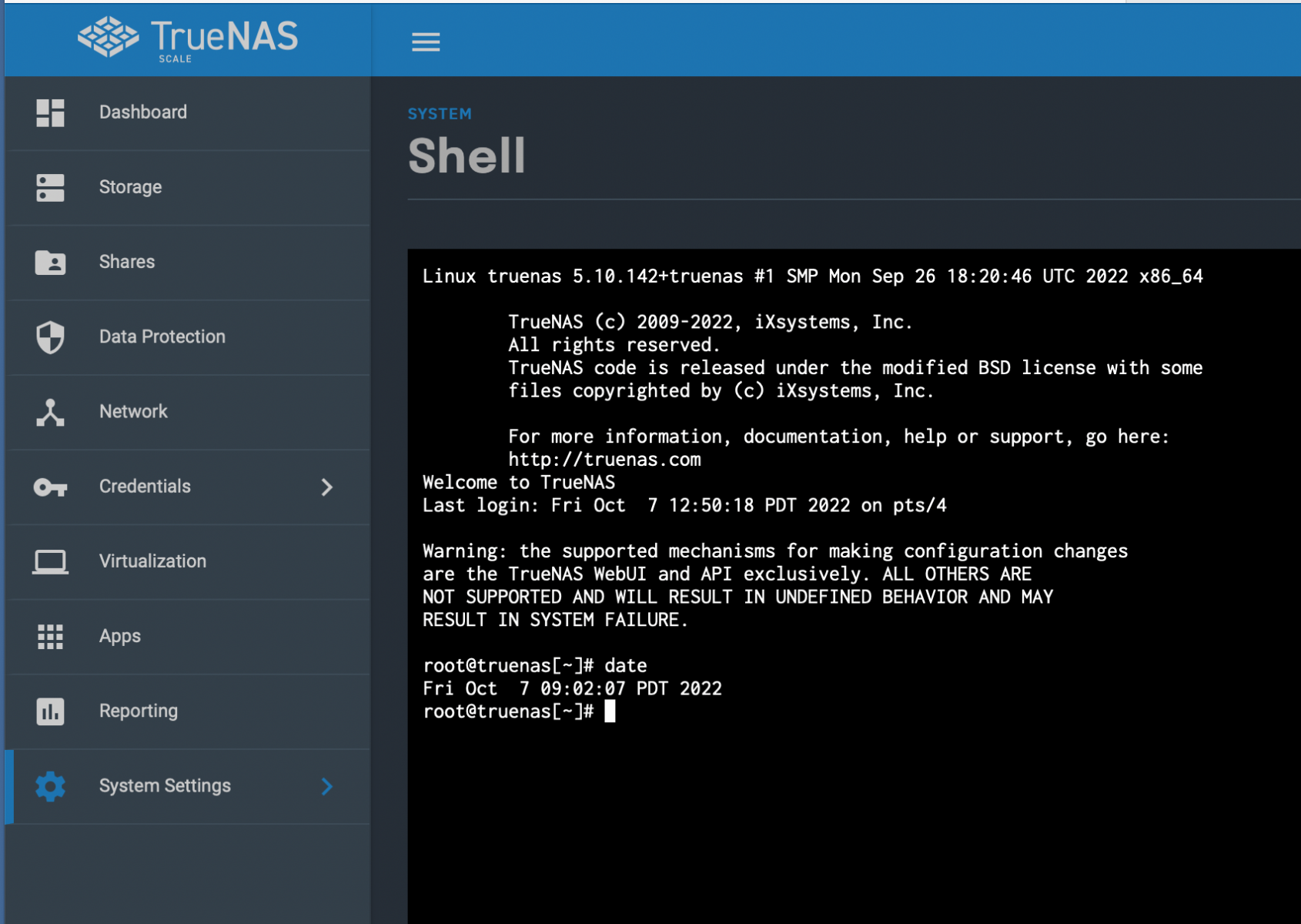

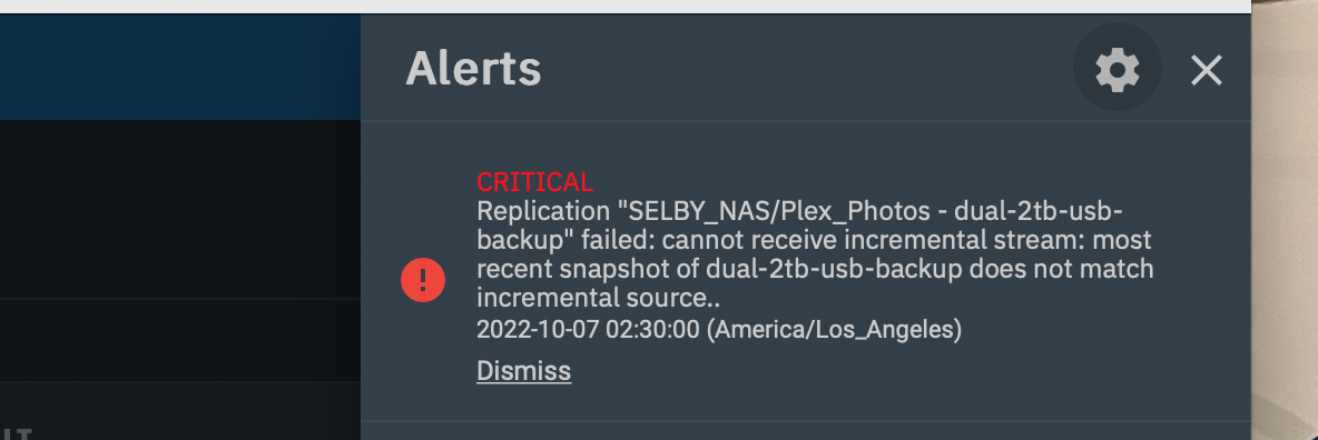

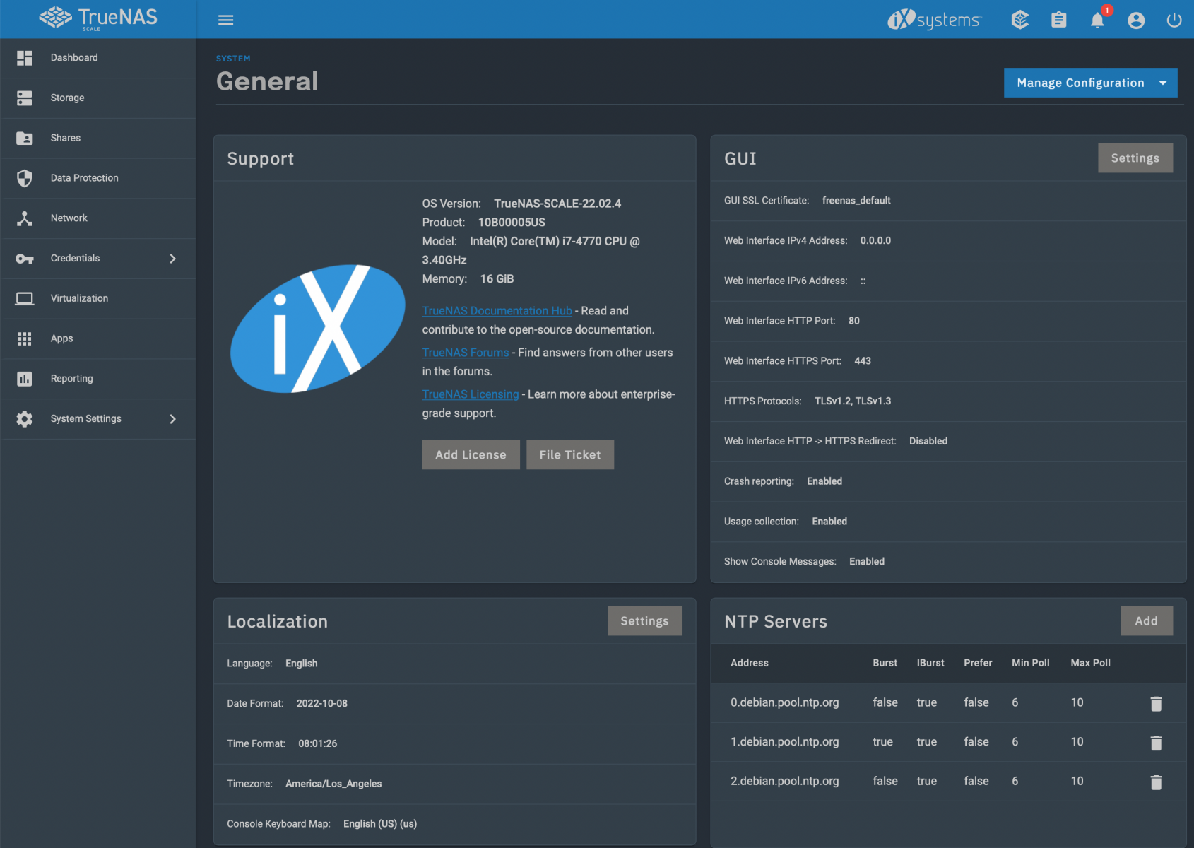

Interesting, I am experiencing a similar issue that coincides with this thread. I recently updated my CPU and replaced my BIOS battery (older PC). When I rebooted, I entered the day's correct date and time for my timezone (PST). Now, my TrueNAS clock appears correct (see screenshots), but my PC/BIOS clock shows over one day off. Now I am getting sync errors (screenshots) and Plex live TV shows are only running 4-5 minutes before showing a playback error.
The date/time of this post is 10/8/2022 at 0802 hrs, but you will see the "date" command shows the 7th.
I have tried to update the date/clock using the command above, but it does not change the date. Any help is greatly appreciated!
