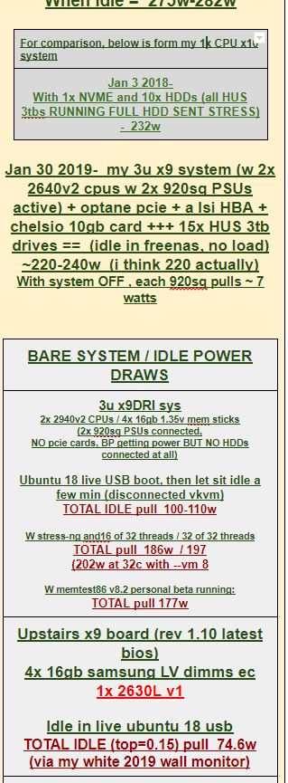

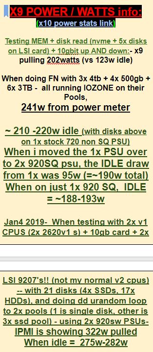

im in the same boat right now, redoing my home/office setup (pretty big setup) so im taking readings / buying parts - of x9 vs x10 (or xeonD systems) i can give this info, sorry its just a copy and paste, so may not make sense (im short on time currently). ask any ? and i can give more info though.
(using images so formatting remains)
