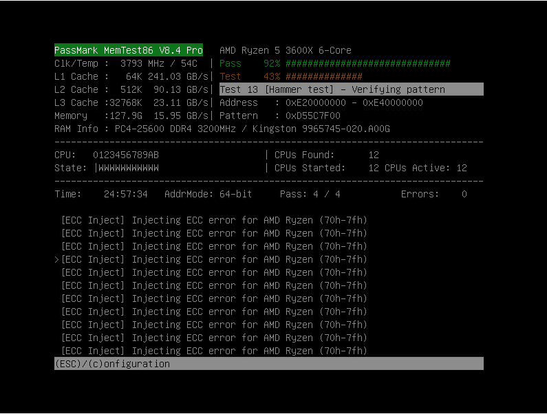

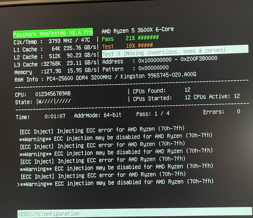

I guess I wasn't very clear and I'm new to using memtest86 ECC injection. With BIOS defaults ECC injection resulted in:
Then in the BIOS I set "Disable Memory Error Injection" from TRUE to FALSE and the result is:
So that looks like ECC injection is working, the output looks similar to testing injection on my E3 V5 Xeon.
