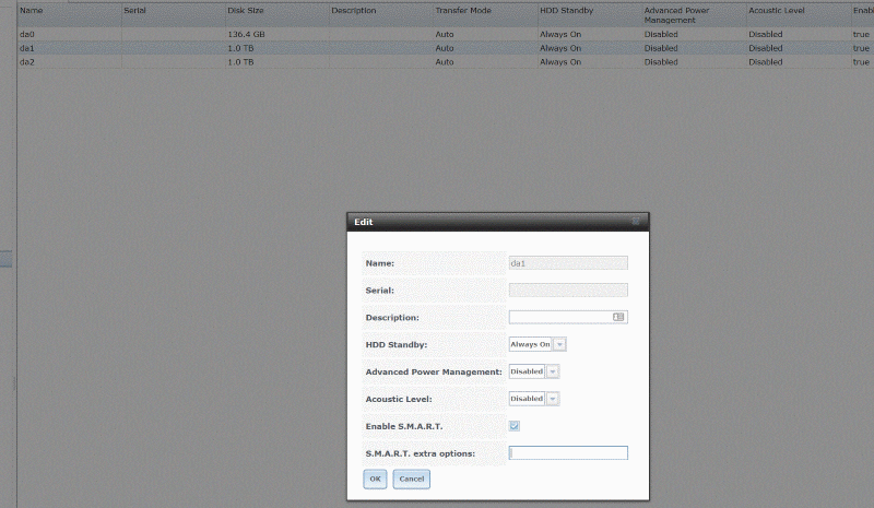

SMART is working, I can monitor it on those WD drives, but via my workaround using software on Host. Did you miss my post on that or did I fail to mention it actually works? Outside FreeNAS though. See attached text file. Short tests are successful.
I am not expecting anything but a rudimentary setup here, those are "scrap drives", replaced two-three years ago with larger ones. My goal is to get a volume up, write to it, maybe half a TB, read, and measure I/O.

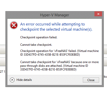

I did get an interesting error though, kinda verifying direct access if you will:
The error specifies I am using "pass-through" disks. Now, is that the same as direct access?
Thus I am unable to save state or images of the running machine. Options remaining might be replication, thus two servers (?) or an inbuilt FreeNAS backup system I have yet to figure out.
I would assume it is Microsoft's method of direct access, but as you have seen with SMART (from within FreeNAS) it is not 'truly' direct access.
Per this article (a bit dated): "Unfortunately, you can't take snapshots/checkpoints when using pass-through disks. It's as simple as that, really."
Maybe if you removed the disks, you could snapshot and then re-add them after? Not sure how viable or convenient that would be. Instead, you could simply have backups of the FreeNAS Configs and apply those to restore somewhat?
Or you could have the VM shutdown and try to see if the Checkpoint would ignore the other disks when the VM is off?

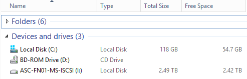

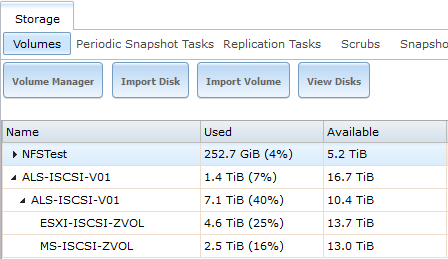

Here are some screenshots for reference:
Storage for VMs on my FreeNAS (*Note the "MS-ISCSI-ZVOL" drives are physically housed in the MS Box)
FreeNAS Volume attached to my MS Hyper-V Server
