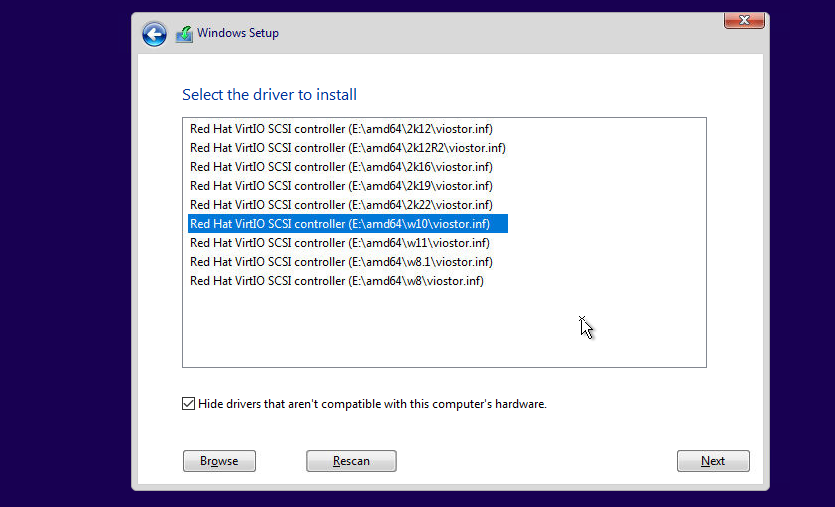

Hi All,
I have been reading the threads however, I am still unable to install Win10 in a VM. Directly after selecting next to install the VirtIO driver the VM crashed.
I have set the disk sector size to both Default and 512, but for me, it makes no difference.
I can successfully install using AHCI.
TrueNAS-12.0-U7
virtio-win-0.1.215
thanks in advance

I can confirm virtio-win-0.1.185 works for Win 10. In that case, even selecting a virtio VM during VM set-up works.
The situation is different for Windows 11, however. Here AHCI VM set-up is required with block size of 512 (running on a 4k pool).
What does not work is switching the main disk to virtio - at least using drivers 0.1.215-2. The problem is described in more detail here. Suggestions for resolution are very welcome.

Just an update that i was able to install windows 10 only with virtio-win-0.1.185
I'm running Freenas 11.3 U5. My experience follows. virtio-win-0.1.185 now works (thanks for this tip) while newer version lead to virtio crashing.
I'll be upgrading to TrueNas in a month or so and see if anything changes.

Hi guys, i've the same problem whith installation of windows 10 up virtual machine of trunas, I just downloaded virtio-win-0.1.221.iso but i dont how to use on my truenas system. can someone help me? please
Samuel Tai
Apr 24, 2020
5,399
@Frederic996, you need to create a 2nd CDROM device for your Windows VM, and point it at the ISO image. Then during the install, when the installer prompts to search for drivers, navigate to the 2nd CDROM.

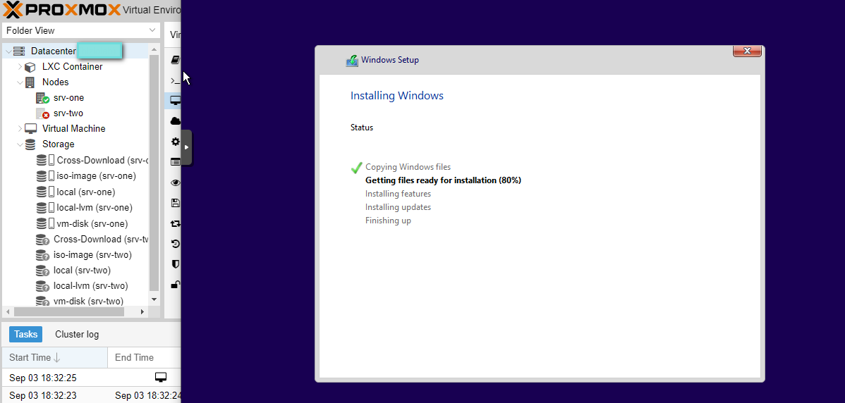

Thanks for the support @Samuel Tai , but my installation crashes first, the virtual machine immediately after starting it crashes. I thought it was a driver problem but the problem seems elsewhere.
Below I show you what happens

I tried to set the resolution to 800x600 and change the vnc port on 5900, but the vm always crash! i have tested my image on proxmox and it works, so my iso is good.
