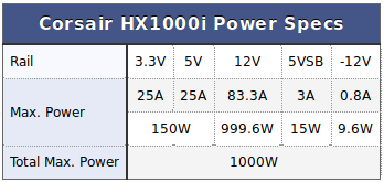

this is the power supply I picked up a few weeks ago before I read about 12v vs 5v and the amps required for each. i would go and use the guide and pick another psu, but unfortunately i've already made the purchase. i'll do a return and pickup something else if necessary, but if this will work i won't bother. my planned build is going to be:

this is the power supply's specs

I've actually read that already and I'm a bit confused(and stupid unfortunately). I don't know whether my drives will be using the 5v or 12v rail. I'm assuming it's the 12v rail. Exos says it using 2.6 amps during spin up and the wd reds say they use 1.8 amps during spinup. I'm assuming that is all on the 12v rail? how do I choose which rail it uses? Does the power supply do that automatically? Either way that means it should be using ~30 amps which leaves me more than half the amps left over for other things. Less than half. Add in an additional 20 amps for the gpu and that leaves me with 30 amps left over for stuff like my hbas and cpu. If my math is good and I'm understanding it properly it should be more than enough even if I replaced my reds with 7200 rpm drives and was resilvering both vdevs at the same time while maxing out the gpu and cpu.
Does this sound robust? this is for the atx build with the psu I listed in the op
