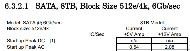

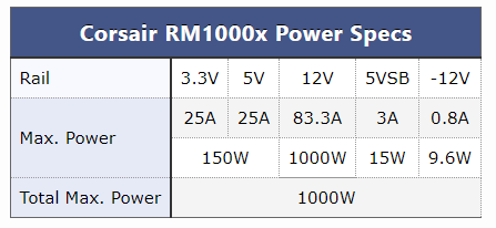

9 * 0.54A = 4.86A 5V
9 * 2.08A = 18.72A 12V
That's ridiculously inside the power specs of the supply right?
I just can't see what would be stopping the power supply from supporting the drives, unless the power supply is bad?
